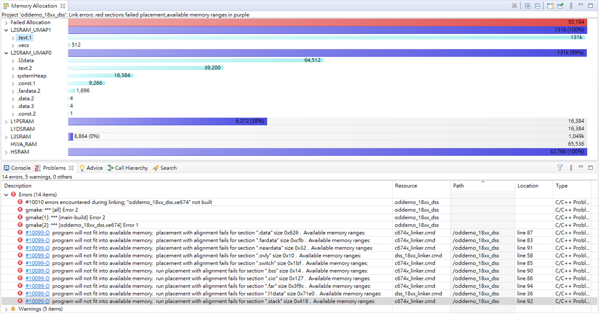

I try to copy the code from the vital sign section of lab 10 to lab 3, and it was happened some error after compiled (fig. 1).
I found the L2SRAM_UMAP0 and 1 are full, the size of .text section is too big.
So I want to reduce the size of .text section of L2SRAM or move some part of the .text section to L3.
How can I do this and do not make too much effect on the original performance ?

  • Hello Morris,
    You can clean up the code and remove some unused feature or code to get some free room in L2 memory.
    gCQRxSigImgMemory, gCQRxSatMonMemory: these uses l2data sections ;   #pragma DATA_SECTION(gCQRxSatMonMemory, ".l2data");
    And make a specific code to copy on L3 section, and provide that section in linker command file
    c674x_linker.cmd:  .text:new_function > L3SRAM
    You need to make sure that this section is not being overwritten while you do the signal processing on DSP.
