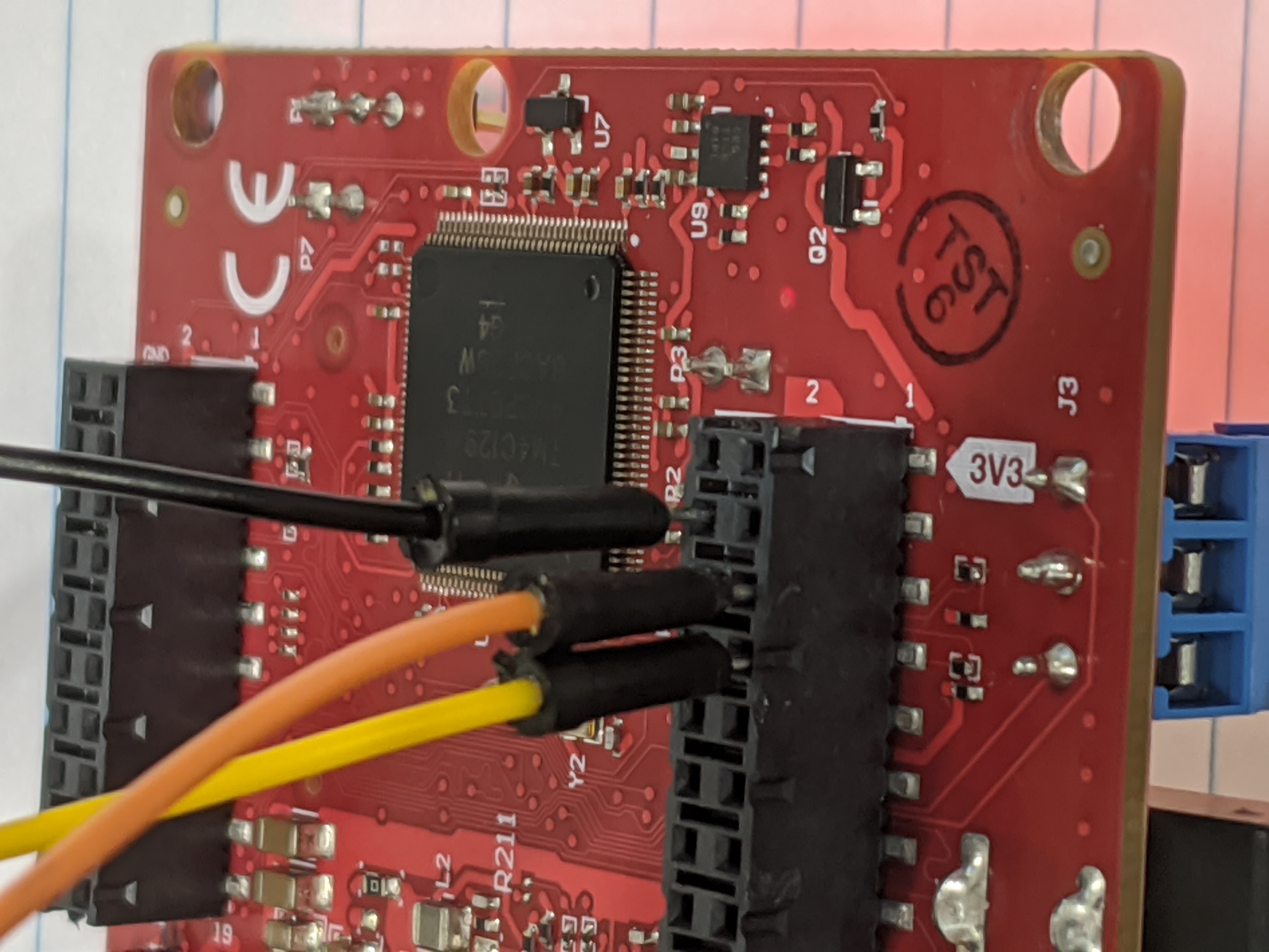

I'm attempting to flash the binary on AWR1642BOOST-ODS via the AR_RS232RX and AR_RS232TX pins on the J6 connector.
I've followed this thread, that explains the process:
https://e2e.ti.com/support/sensors/f/1023/t/745128?AWR1642BOOST-How-to-Connect-EVM-Booster-pack-J6-pin5-AR-RS232TX-and-pin7-AR-RS232RX-to-PC-other-host
I've made the hardware changes, as shown in the attached pictures. I'm connecting to the pins with a ttl-232r-3v3 cable, as shown as well.

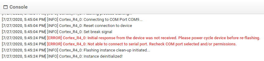

I've set the com port to baud rate of 115200. I get the same error as the other thread, cannot open the com port (picture below).
Does this setup seem correct?
