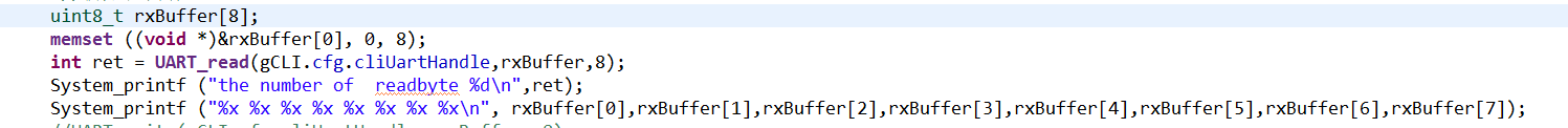

The customer uses the following serial port program, and the received data shifts.

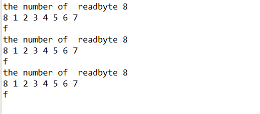

Send the following data from the serial port:
The debugging information of program control is as follows:
The customer would like to know what caused it?

    I created a short little program which emulated the code snippet that you provided minus utilizing the UART API e.g. UART_read(). I was not able to replicate the out of order byte issue. This leads to me to think that there are 2 places that might be at issue.
    1. The serial terminal they are using may be the cause. I usually use PuTTY or Teraterm. Have them try those and see if that changes the output of the program.
    2. I see that they use System_printf() this could be the issue.
    The best way to iron out the cause of this bug is to use a debugger + a memory browser to view how the variables/data structures in the program differ line to line. If they can not find their memory browser then please have them google search their specific IDE and identify if they have a debugger as well as a memory browser. Assuming that they are using CCS, then both of these features are present and need to be used.

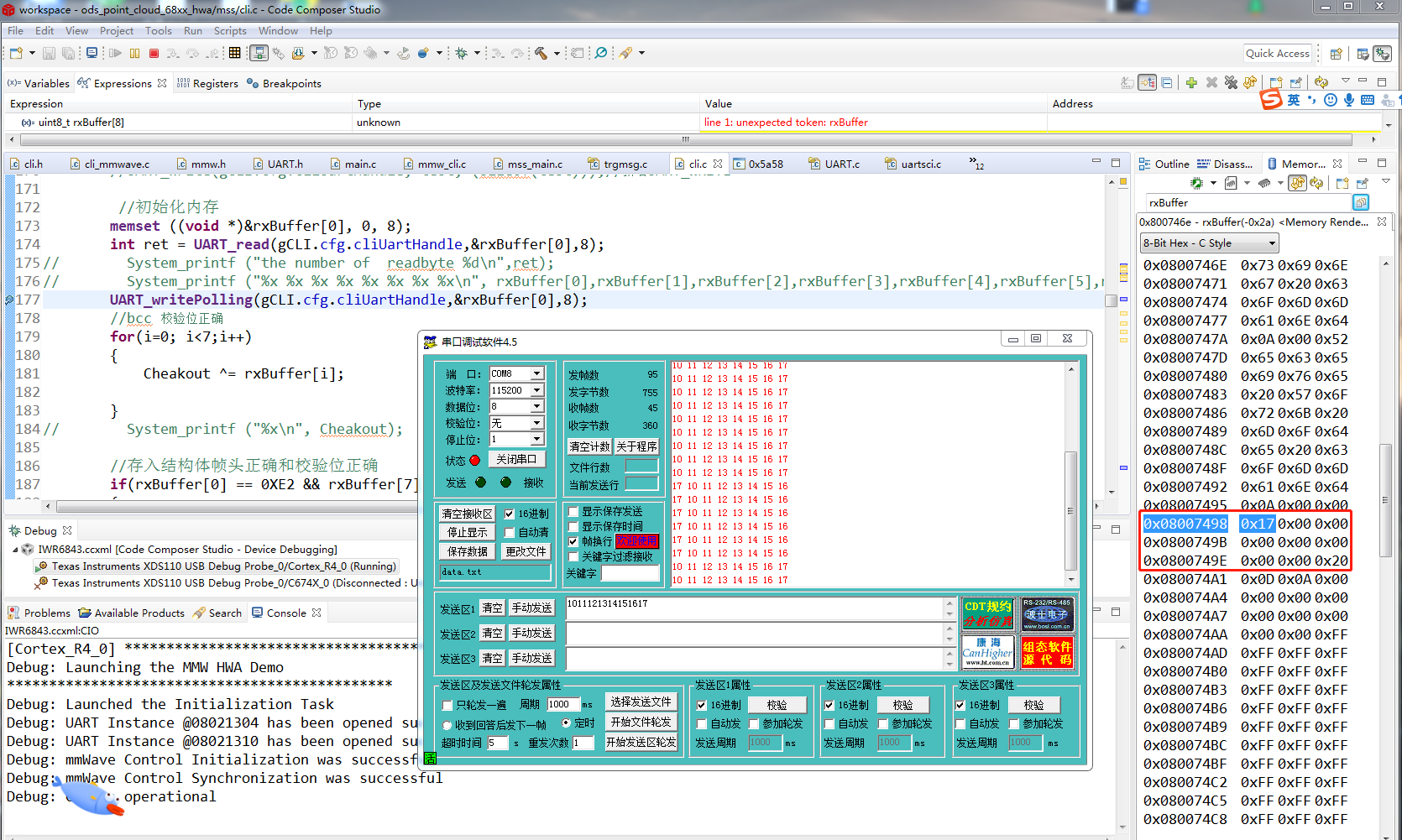

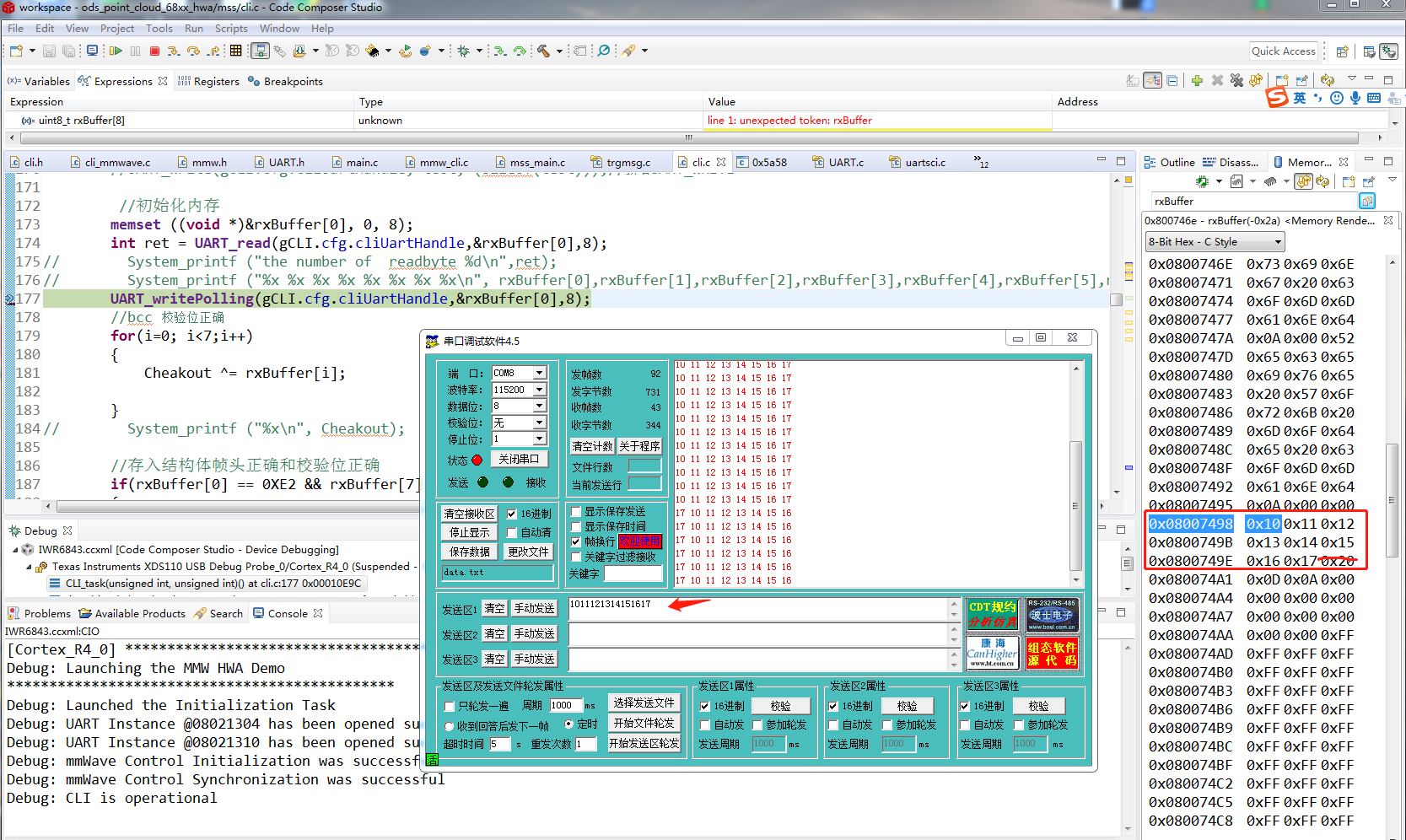

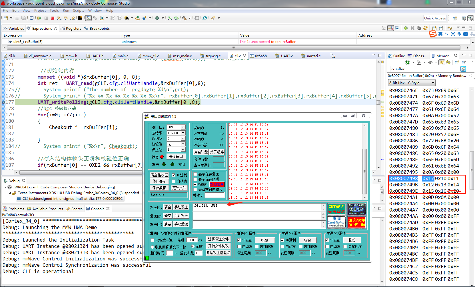

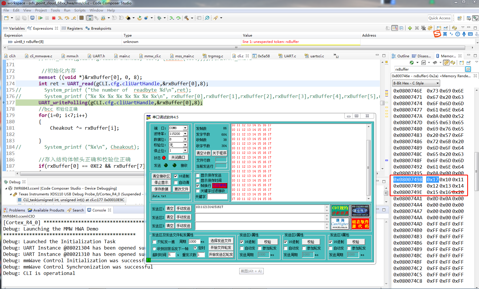

    3. The memory of rxBuffer after UART_read() is found, as shown in the figure below:
    1) The correct memory display of rxBuffer:
    2) Error rxBuffer memory display:
    3) After the error is displayed, the 17 in the memory cannot be cleared.
    4) When the data input is changed to 00010203040506, the wrong data will appear again. After inputting 0001020304050607, the output data is correct.
    Annie
  • Annie:
    I can see from image 1 that indeed that at memory address 0x08007498 you have the correct byte sequence. In image 2 I can see that the 0x17 byte is now out of order.
