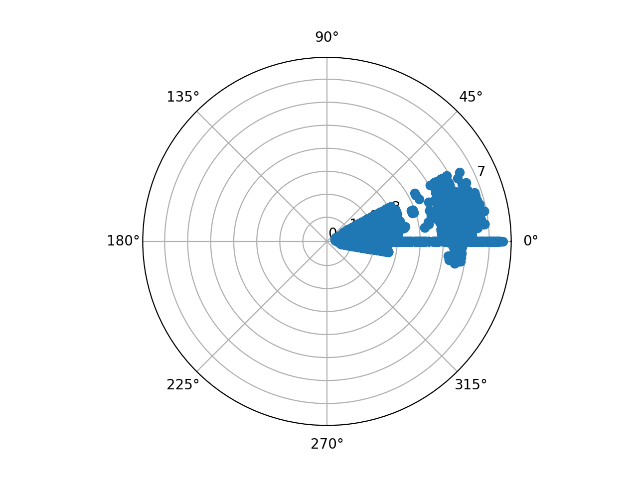

The demo I'm running is 3D_people_counting.It seems that the elevation angle range is -9.74 degs to 28.64 degs,0 is not the center,which means the 0 degs in elevation is not perpendicular to the radar board.
Is there any explanation about this?

    1.We flushed /ti/mmwave_industrial_toolbox_4_3_2/labs/people_counting/68xx_3D_people_counting/prebuilt_binaries/3D_people_count_68xx_demo.bin.We write our own program to receive point cloud.The picture I uploaded shows the raw polar coordinate data obtained from the radar.

    Looking at the graph and the measurements, it appears that the elevation FOV is 38.38 degrees, which is just about the 40 degrees we would expect - however, this FOV is offset from center. Have you checked the .cfg file to see if you are programming any elevation offset into the device? In the default config. see the line:
    sensorPosition 2 0 10
    Which indicates that the elevation is offset 10 degrees up, to make up for a 10 degree downtilt. You are seeing points roughly from -10 to 30 degrees, which centers at 10 degrees - please try changing this line to zero and seeing if the issue is resolved.
    Justin
  • Hi Justin,
    Thank you very much!It helped a lot.
