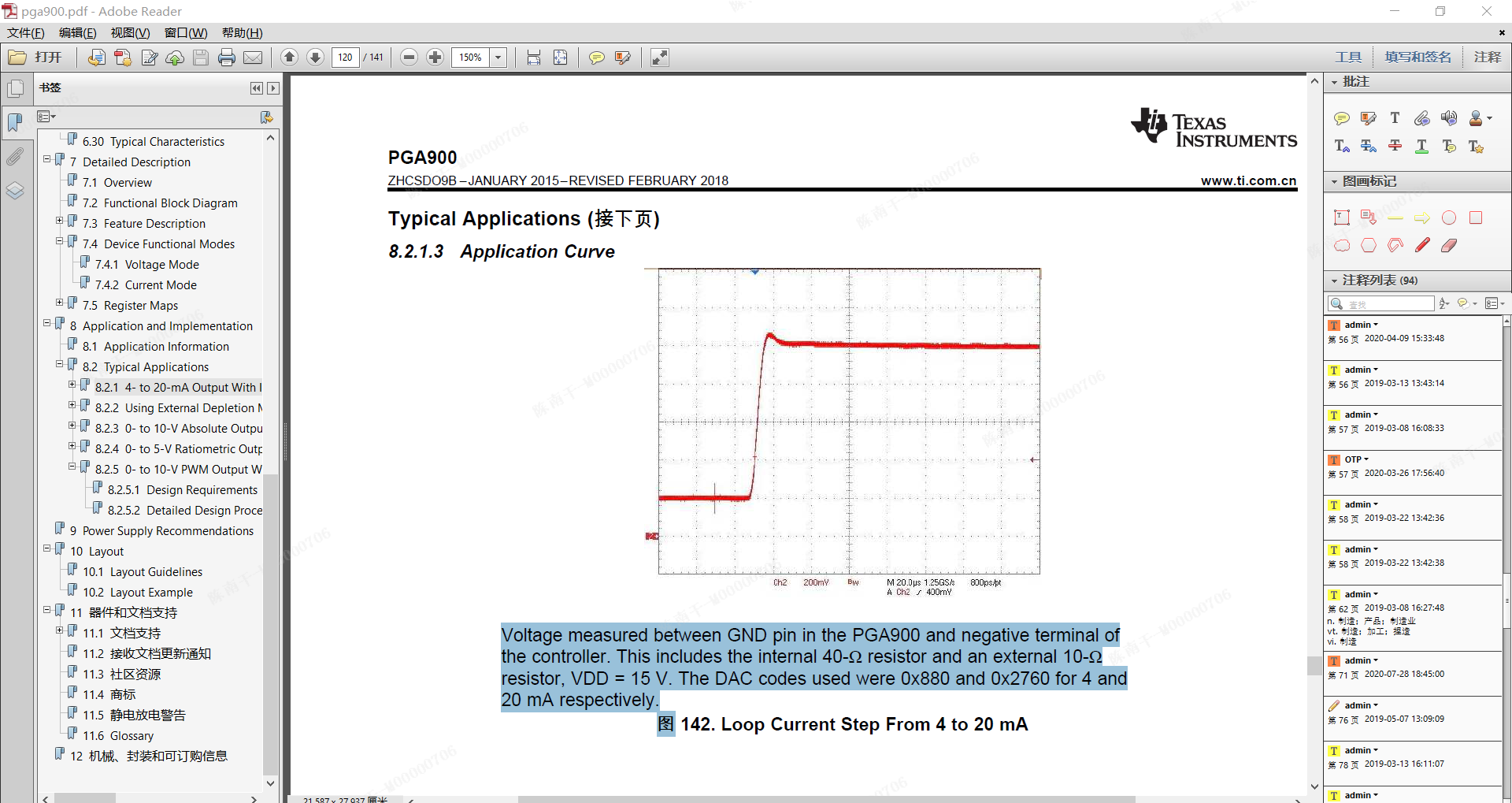

section 1:
Voltage measured between GND pin in the PGA900 and negative terminal of
the controller. This includes the internal 40-Ω resistor and an external 10-Ω
resistor, VDD = 15 V. The DAC codes used were 0x880 and 0x2760 for 4 and
20 mA respectively.(PGA900 datasheet SLDS258  Page )

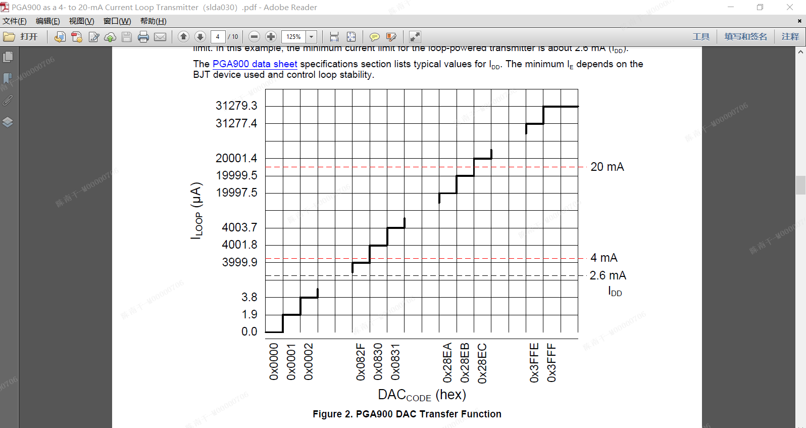

section 2:
 The DAC codes used were 0x830 and 0x28EB for 4 and
20 mA respectively.(PGA900 as 4 to 20 mA C urrent loop Transmitter SLDA030)
So what is more  correct?
  • Hello Chennangan,
    The plot from the "PGA900 as 4 to 20 mA Current loop Transmitter SLDA030" application note is a direct result of Equation 1 from that application note. It is an ideal graph that does not take into account DAC offset or gain error.
    The application curve from the datasheet shows real measured data from a specific PGA900 device. The offset and gain error of that particular device caused it to deviate somewhat from the ideal values described in the application note. The difference between the two values is within the 3.5% FSO error of the DAC in current operating mode. This error can be compensated for when doing the device calibration procedure.
