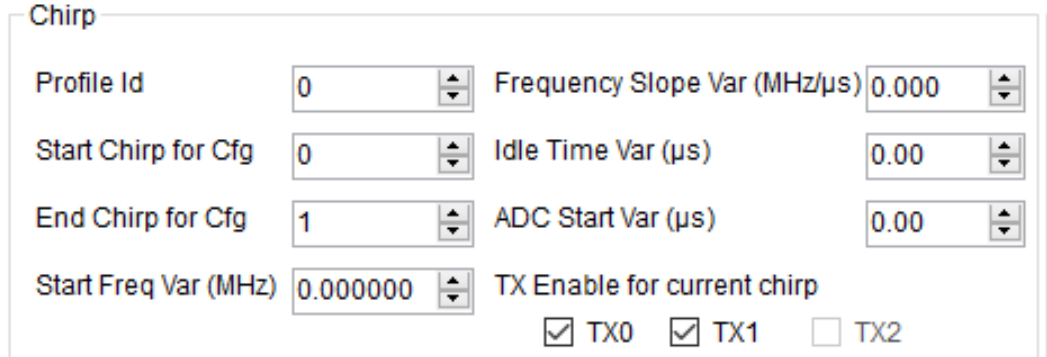

3. In Chirp section, create 2 chirps. First one is: Profile ID=0, Start Chirp=0, End Chirp=0, both TX0 and TX1 are checked (for simultaneous chirp sending) and Set; Second chirp is: Profile ID=0, Start Chirp=1, End Chirp=1, both TX0 and TX1 are checked again and Set.
4. Go into BPMConfig tab. Go into BPM Chirp Config section. For the first chirp (in the MIMO Radar document (Section 4.2) it is referred as S_a=S1+S2): Start index=0, End index=0, TX0 BPM Val (TX On)=0, TX1 BPM Val (TX On)=0 and Set. For the second chirp (in the MIMO Radar document it is referred as S_b=S1-S2): Start index=1, End index=1, TX0 BPM Val (TX On)=0, TX1 BPM Val (TX On)=1 and Set.

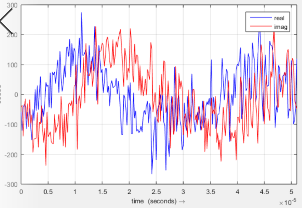

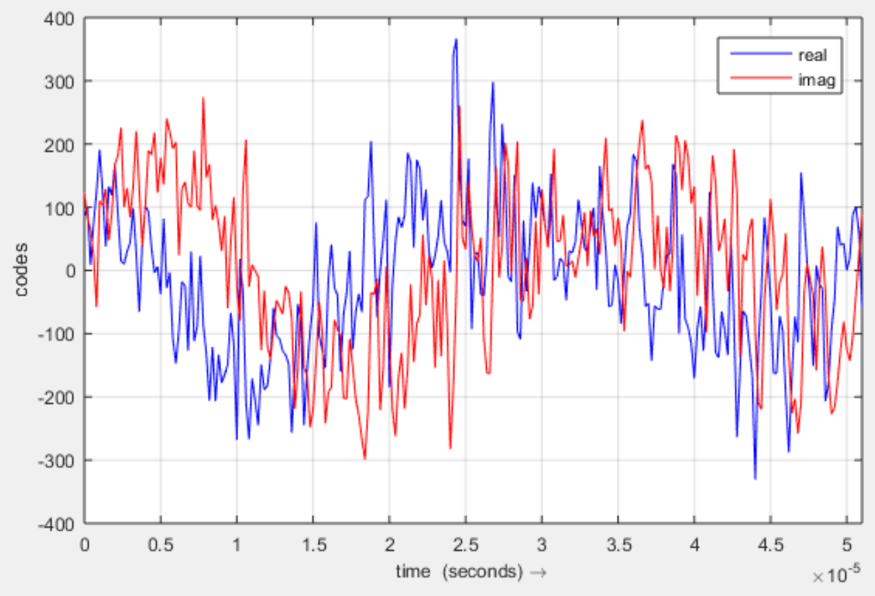

  • Thank you for the information. I followed the steps you mentioned and got the following chirps for 1 transmitter case (Tx0):
    chirp 0:
    chirp 1:
    But I am not sure why we are supposed to use only one TX. Isn't the advantage of using BPM simultaneous transmission from multiple transmitters as stated in the Mimo Radar document (see, section 4.2)?

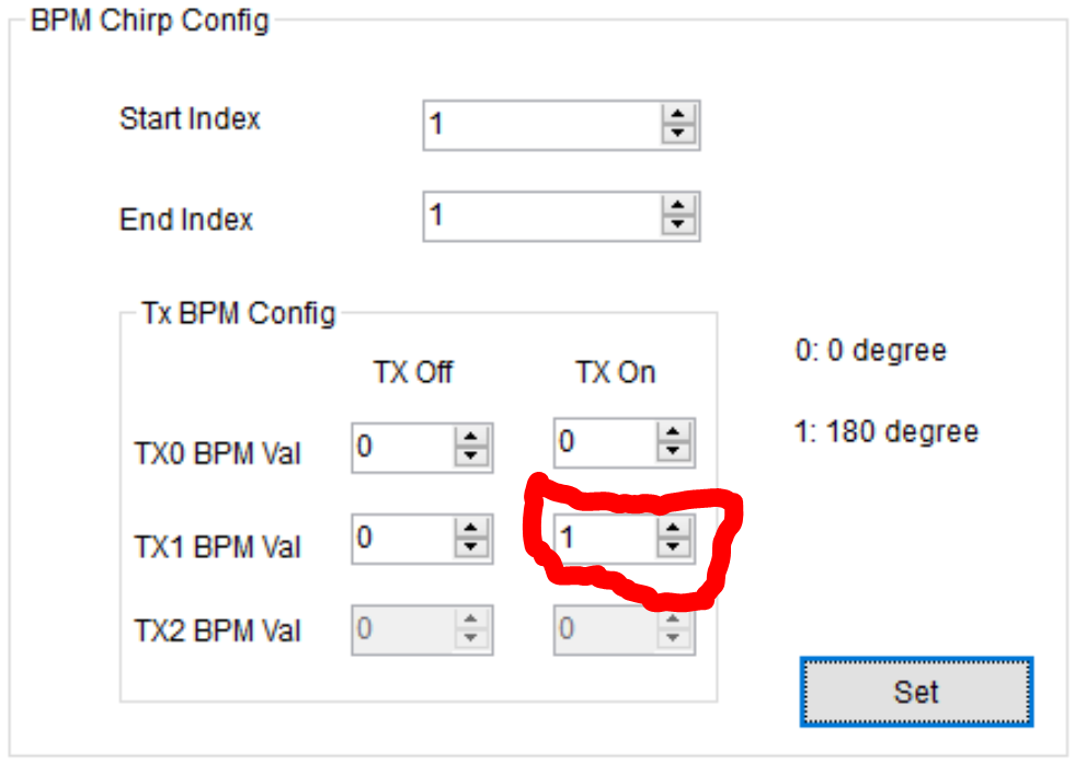

    When i try to extend this to 2 antennas case, I enable both antennas in both chirp configurations and under BPM config tab I set chirp configurations as follows:
    Chirp Config:
    chirp 0 config:
    chirp 1 config:

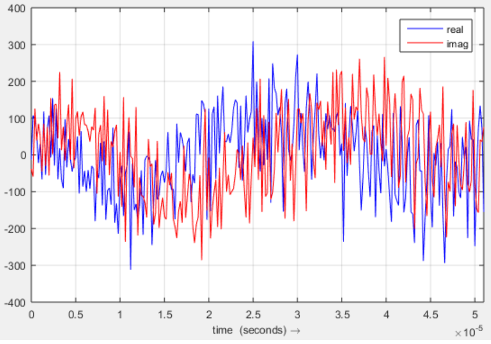

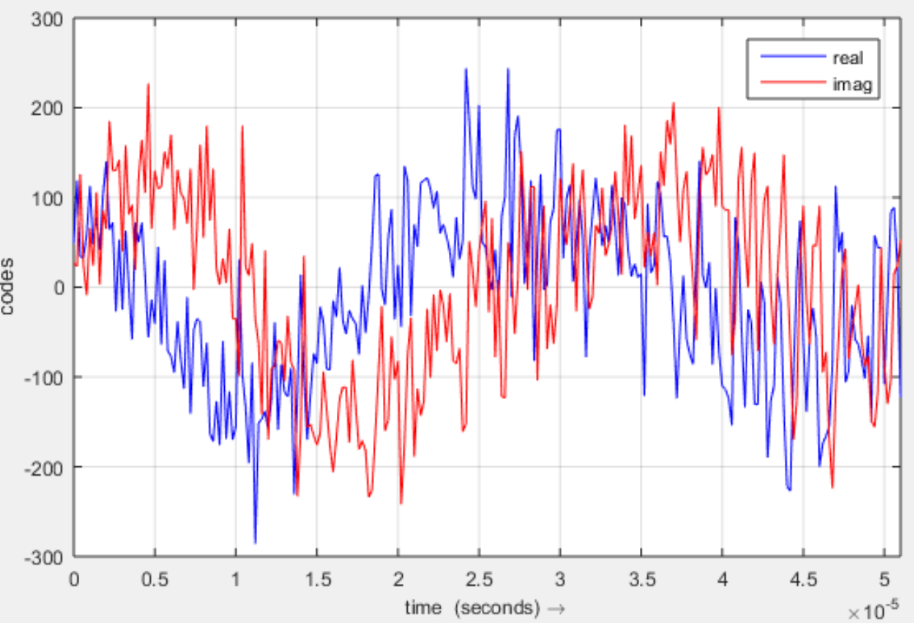

    According to the documentation, this is what I understand from Figure 10. (see '1's in the plot corresponds to 0 phase which is 0 in mmwave studio, and '-1's in the figure correspond to 180 degree which is 1 in mmwave studio). When I do this configuration like this, I get my chirps as follows:
    chirp 0:
    chirp 1:

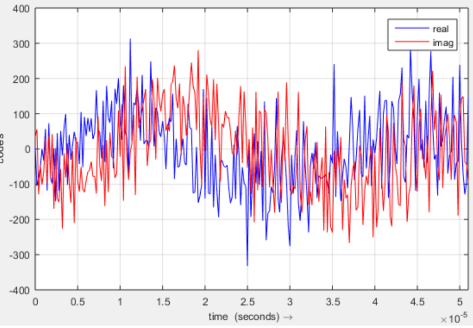

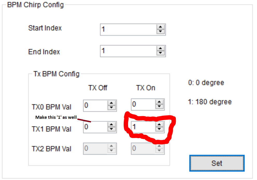

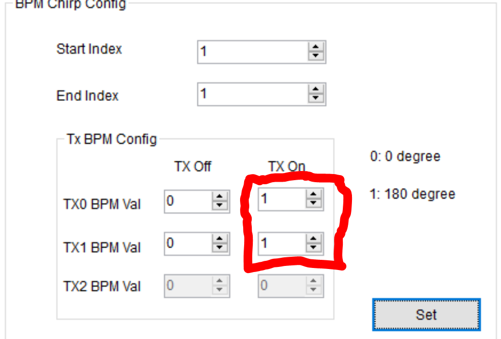

    As you can see, there is no 180 degree difference but when I add phase to both antennas then I can get the 180 degree phase difference:
    chirp 1 config:
    chirp 1:
    As we can see this time we obtained 180 degree phase difference. So, doesn't this contradict with what document says? Because according to the document we should add phase only to one antenna. Please correct me if I am wrong.

  • Hello Emre,
    Other thread link I have mentioned was to demostrate the phase shift by 180 degree in the chirp plot.
    But in the real case you need to use two Tx (one with 0 deg and other with 180 deg)  to use the BPM feature of the device.
    And in the mmwave studio:
    You need to set value '1' for Tx off and on both together to enable 180 deg for specific Tx antenna.
    Jitendra
