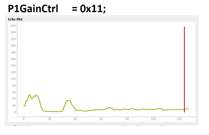

I am developing 200khZ solution based on pga460 I am having few problems which i would like to disucess.
I am following reference design and no passives are place in paralelle to transducer. The following components are used in the design.
TLV61064A (Supply @ 7.5V)
Wurth Transformer 750317161

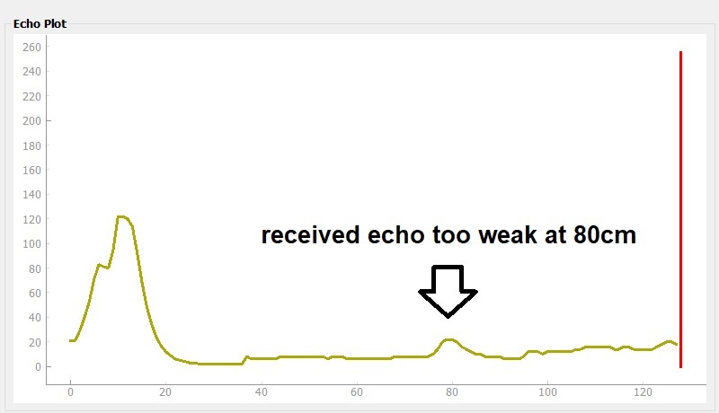

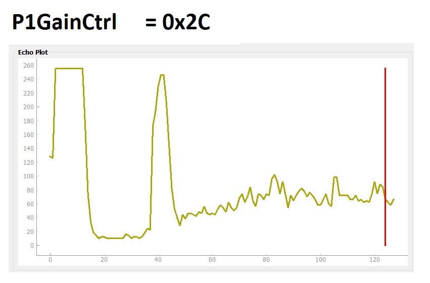

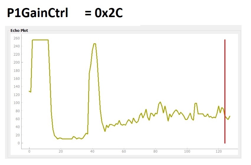

I am using echo profiling to finely tunned the system. From profiling data, it seems like the transducer is not generating strong echo, and therefore the intensity of the received echo is also very low. To tackle that problem I have increased P1GainCtrl to maximum 0x2C and it starts to work but now the deadzone is large around 14cm. I am also not satisfied with the performance overall sometimes it didn't detect the object at all.
I also tried epcos B78416A2386A003  but the same results. I have also noticed one problem that sensor only worked by turning off current limit feature CurrentLimP1 = 0xFF.
Please have a look at register settings. if there is any problem in settings.

  • Hi Samuel,
    I am surprised you were able to get working results when pairing the 200kHz transducer with the WE 750317161 transformer, because this transformer is intended to be paired with low frequency (30-80kHz) transducers due to its 3mH inductance. The EPCOS B78416A2386A003 should generate a more efficient transmit pulse because it is intended to be paired with high-frequency (180-480kHz) transducers due to its lower inductance of 230uH.
    To debug:
    1. Can you oscilloscope probe the transducer's positive terminal to check and compare the transmit pulse integrity of the two transformer options.
    2. You should not need to disable the current limit to generate sufficient SPL. Typically, 200~300mA is sufficient. In fact, disabling the current is not recommended since this could damage the driver block if you don't externally limit the current.
    3. The FOV of the 200kHz is very narrow, so alignment to the target is crucial to enable proper detection. What is the targeted object?
    4. A digital of x16 or x32 is not recommended to for the burst decay stage. You should start with a low DG initially (x1-x4) for the short range, then bump up to a long range multiplier (>=x8) for the long range. You'll want to bring in your TH9 point much sooner to enable the LR multiplier immediately after decay. You'll have to use very short TH1-8 threshold time values to do so. You are currently using mid-code values (0x88), which are too long.
    5. Assuming you are using a UART connection, do you have the EVM's MSP-EXP430F5529LP board to connect to your PGA460, and use the GUI to check, compare, and optimize performance?
    6. You may need to add a damping resistor of 10kOhm (ideal starting value) in parallel to the transducer to reduce the decay/deadzone time. You can read more about the the matching components (parallel tuning capacitor and damping resistor) as described in section "3.4 Passive Tuning" of the PGA460 Ultrasonic Module Hardware and Software Optimization app report.

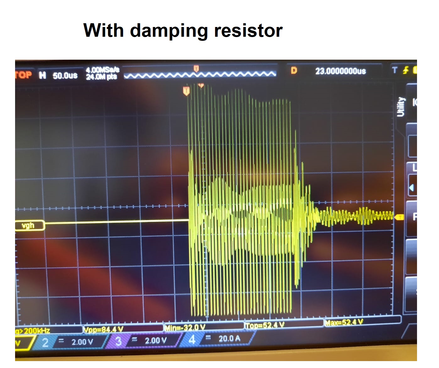

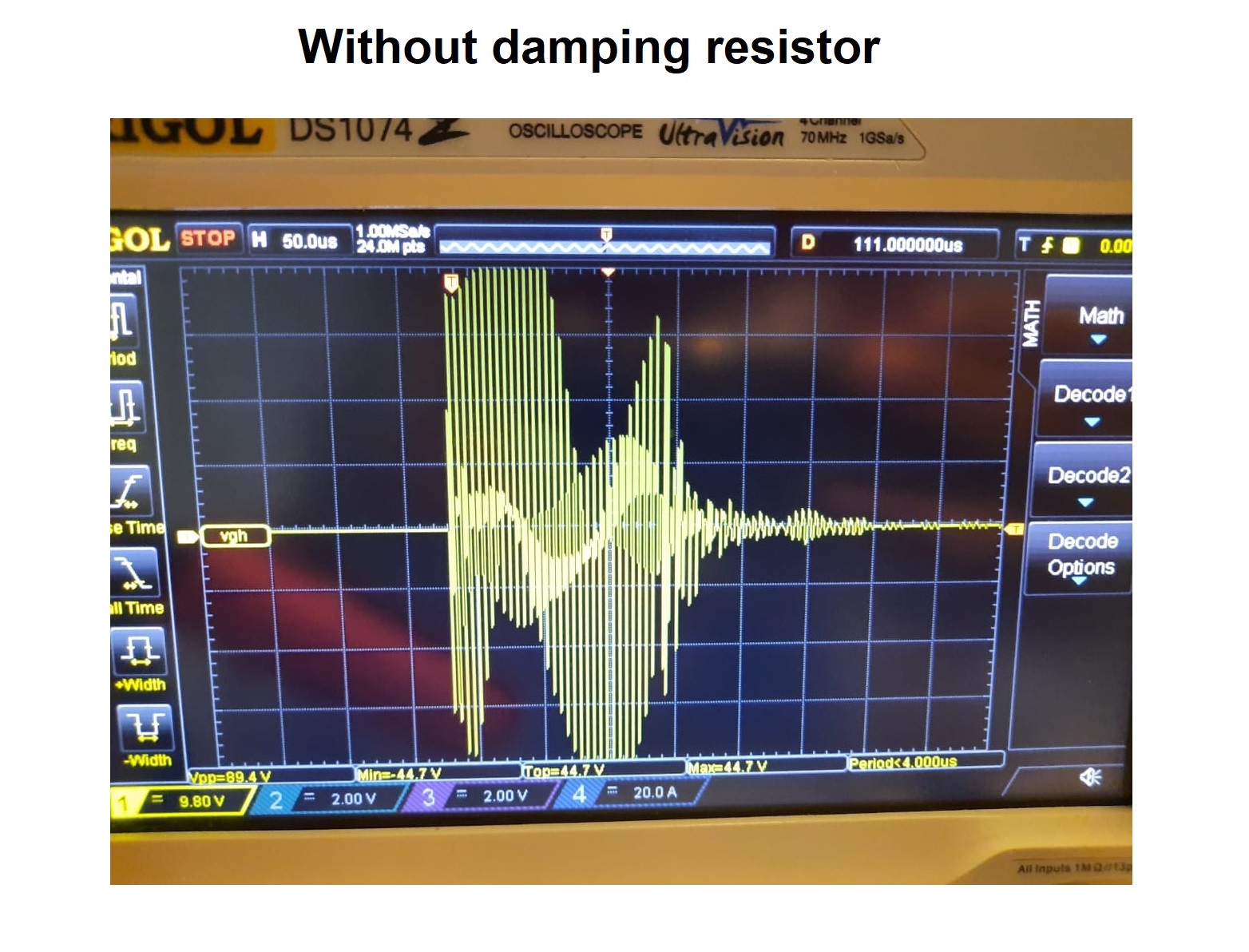

    2- I have updated my gain (x4 for burst decay stage and x16 for long-range) , thresholds, and current limit setting. I have also added 10k damping resistor but still, I am getting more than 15cm deadzone. The incoming
    echo amplitude is too small so it is sometimes missing the object.
    3- I have recorded the echo burst stage on the oscilloscope and have attached the images in the message. From oscilloscope i have figured out the Vpp are very low. I couldn't figure out what is the issue.

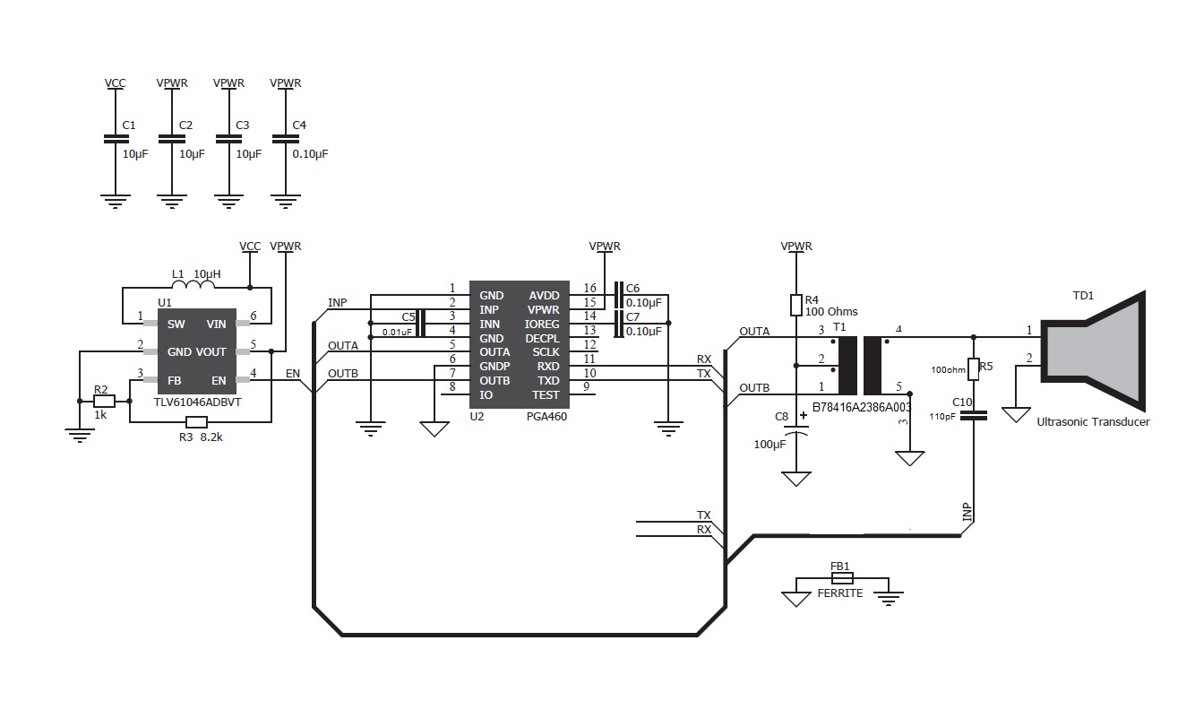

    The attached images are recorded with B78416A2386A003 transformer operated at 7.5 so Vpp should be (7.5 x9 ) x 2 = 135V but oscilloscope has recoded Vpp 84V .
    I have also attached schematic can you check if we are doing something wrong.
    4- I do not have EVM board but I have written some script in python for echo plotting and I am sharing the plot as well.
    Thanks for your time.

  • Hi Samuel,
    I suspect the weak echo is due to your distorted transducer driver voltage, resulting in a lower transmitted sound pressure level. The driving voltage should more ideal sinusoidal with fewer transients and offset. You may need to add a tuning capacitor in parallel to the transducer instead of just the damping resistor to better match the transformer to the transducer. Please refer to section "3.4 Passive Tuning" in PGA460 Ultrasonic Module Hardware and Software Optimization app report. You will most likely need to spot check a few capacitor values in the 50-1000pF range. I typically use a capacitor bank to sweep several values as I monitor the oscilloscope output of the transducer driver voltage.
    Your schematic looks fine. You may want to replace FB1 with a 0Ohm short to see if this also makes a difference.
