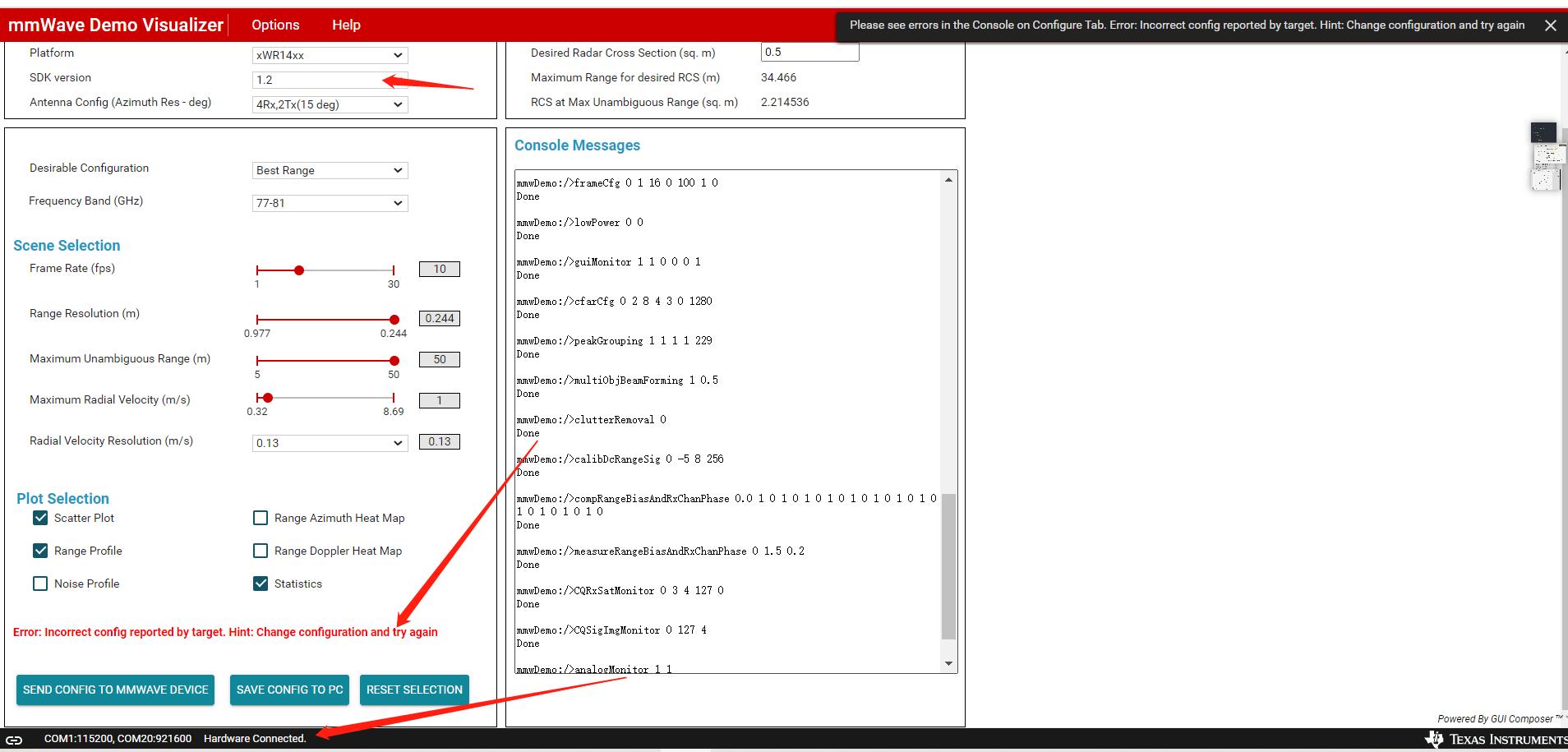

IWR1443BOOST: 'cfarCfg' is not recognized as a CLI command
Part Number: IWR1443BOOST
  1. iwr1443boost ES2.0
  2. SDK 1.2
  3. flash bin file :industrial toolbox 2_5_2_win----C:\ti\mmwave_industrial_toolbox_2_5_2__win\mmwave_industrial_toolbox_2_5_2\labs\lab0002-vital-signs\lab0002_vital_signs_pjt\Prebuilt_binaries\xwr14xx_vitalSigns_lab_mss
  4. when I flash:SOP101,at mmwave demo visualizer SOP:001.
  5. But it still makes a mistake.'cfarCfg' is not recognized as a CLI command!!!
  6. if I flash the bin file in SDK 1.2,D:\ti\mmwave_sdk_01_02_00_05\packages\ti\demo\xwr14xx\mmw\xwr14xx_mmw_demo_mss,it still makes a mistake.!!ERROR:Incorrect config reported by target.Hint Change config and try again.
  7. I have tried it for more than 10days .I didn't know there was a mistake
when I flash the SDK 1.2bin file,
