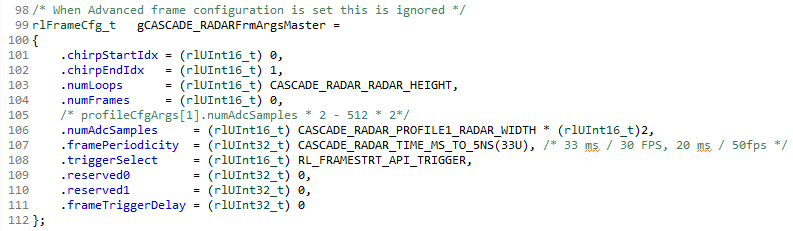

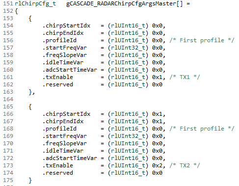

I have successfully run unit_test from C:\PROCESSOR_SDK_RADAR_03_08_00_00\ti_components\drivers\pdk_01_10_04_05\packages\ti\drv\vps\unit_test\cascadeRadarUt with one active Tx on master as it is in source code. Now i try to run master with two active TX.
I changed CascadeRadar_main.h:
#define CASCADE_RADAR_NUM_TX_ANTENNA (2U) instead 1U and commented out string #define ENABLE_TEST_SOURCE ;
also i changed CascadeRadar_main.c:
and
But I get zero values of any elements in massive gCascadeRadarFrmRecdNum.
When i run it with one active tx i can receive and read transmited frames.
Whats wrong i did?
