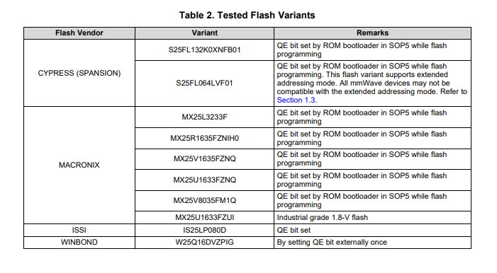

I am refer to  the link below.
https://www.ti.com/lit/an/sprach9b/sprach9b.pdf

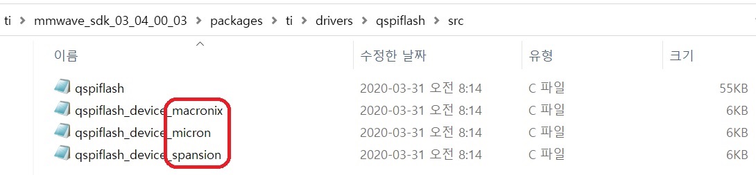

Cypress devices is obsolete.
mmwave sdk isn't supported to ISSI & Winbond.
mmwave sdk 03.04.00.03 is supported to macronix, micron and spansion(cypress) devices.
It isn't supported to wide.
I want supported to mmwave sdk for ISSI device.
ISSI device is different to 3 commands about Macronix device.
