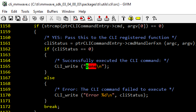

  We would like to control radar silently. But it will show the characters when we input the configurations via User UART in the terminal. Are any ways to turn off command response?

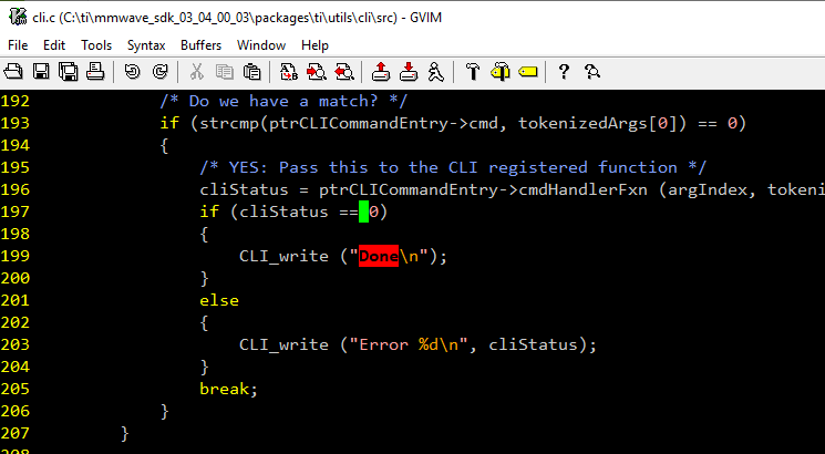

    Are you looking to disable the Done response after each command or looking to completely silent the terminal? To remove the "Done" response, you'll need to:
    1. Comment out the lines as shown in the following files namely cli.c and cli_mmwave.c. Complete path is shown in the editor snapshot below.
    2. Then re-compile the cli library and
    3. Finally, re-build the demo code to link the new cli lib.
    But if you want to completely silence the terminal, then you need to research the terminal software you're using (e.g. TeraTerm or Putty) to see if it allows silencing local echo of characters.
    -Nitin
