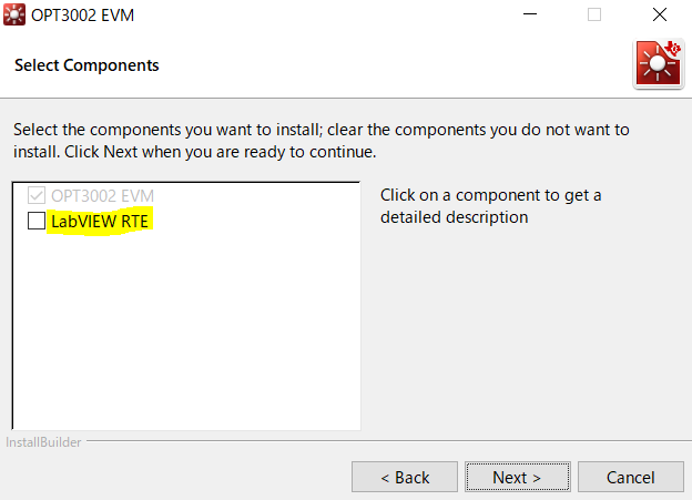

    Thanks for your reply. First picture shows the error message. It says it need version 2014 or compatible version.
    BTW, I got new response from the customer.
    He said he reinstalled the software by selecting  "LabVIEW RTE" option again(as shown in second picture below), but it still went wrong.
    After that, he confirmed the "Readme" file and there was a download link for version 2014.
    And It worked normally after he downloaded version 2014.
    But I am wondering how could it not work when selecting  "LabVIEW RTE" option when installing or use the newest version(since it should be compatible with version 2014 )
