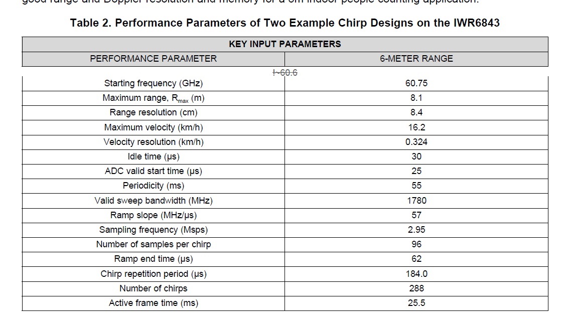

I refer to tidue71d-page.9-table 2 and change ODS_6m_default.cgf
from
profileCfg 0 60.75 7 7 41.10 0 0 54.71 1 96 2950.00 0 0 24
to
profileCfg 0 60.75 30 25 62 0 0 57 1 96 2950.00 0 0 24

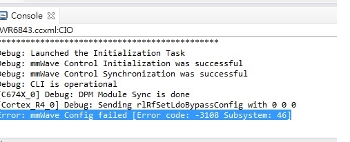

When I send configuration in people_counting_GUI, the GUI does not work. I enter debug mode and get Error code. I have 2 questions
1. Why the new configuration cannot work?
2. Do you have document about the error message?
