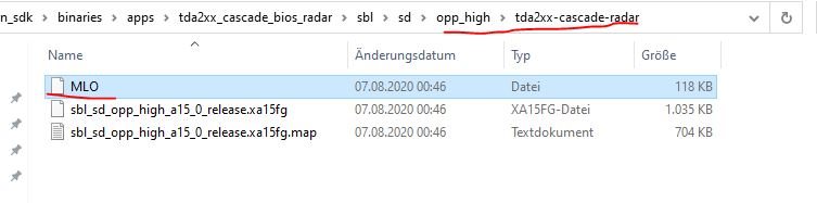

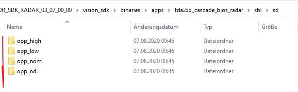

I got several files .xearp32F and .map ,.xem4, .rprc
I did the steps in vision SDK TDA2XX user guide v3.7
3.6.3 Steps to generate MLO
3.6.4 Steps to generate appImage
after running these two steps, I can get opp_high opp_low opp_nom opp_od folders and related data.
Question: how can I generate this image file sdimage.bin.bz2?
 the sdimage.bin.bz2 data is about 234MB.
the AppImage and MLO files are very small compared to the prebuilt image sdimage.bin.bz2 file.
