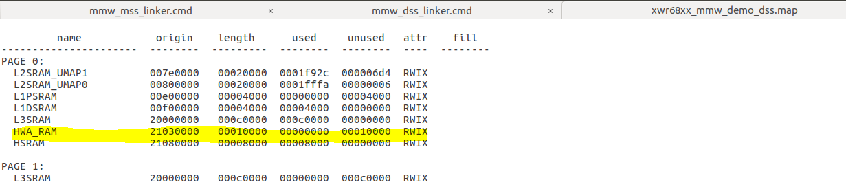

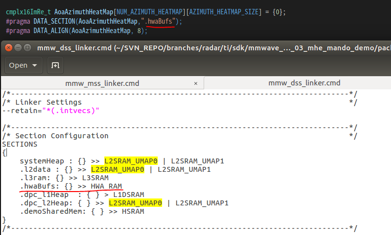

Currently I am migrating Radar algorithm from MATLAB to sensor.
But there isn't enough space in L1D, L2, L3.
Is it possible to use HWA_RAM to store global variable in DSS?
I tried below. It doesn't work.
Do you have any idea for my problem?
