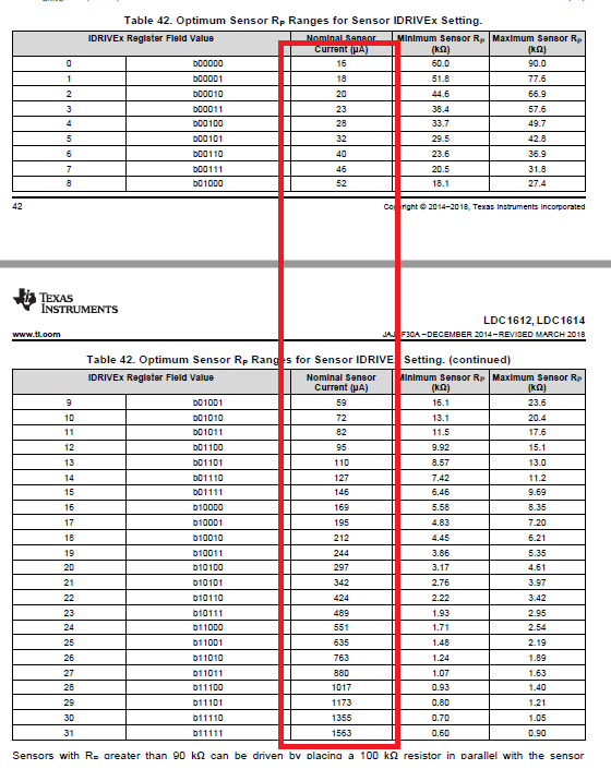

1. The IDRIVE setting is described in the d/s as shown below. However, the IDRIVE setting in Power Mode of EVM GUI seems to be different from the d/s. Which one is correct?

  • 1. You are right that is how you set the IDRIVE current, those are the correct registers.What you are confusing are the IDRIVE settings and sensor activation time (8.1.4.2 Sensor Activation)  When low power sensor activation mode is enabled, the IDRIVE code determines how much current the device supplies to the sensor. To determine the optimal current drive setting, move the system target to its furthest distance from the sensor and click the Detect iDriveInit with Auto-Amplitude Correction button. This will take a measurement to determine an appropriate current setting. After the setting has been measured, the code value of Idrive must be adjusted. If the low power sensor activation mode is disabled, the Idrive settings are ignored.
    2. You want to set the amplitude such that its remains within the 1.2-1.8V range at the min and max travel distances of your target to optimize effective resolution and better SNR.
