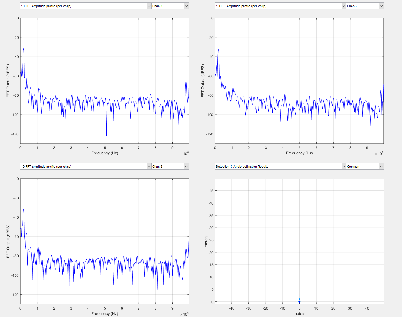

            I am working on developing my own post processing script (matlab) on the AWR1243 adc data (captured using DCA 1000)  but I see that the 1D FFT for range estimation on the mmWave studio post processing and my matlab post processing is similar but still very different. Could you point out what maybe the reasons for these differences :
1.5dBFs difference in power levels of peak
2.Large number of side lobes or noise from the system in my post processing
3.Very high levels of noise
WIth regards,
Mohan
    The post processing performs a winodowing+1D FFT on the data similar to this code snippet. Maybe you are using a different window.
    This code snippet is NOT the studio post processing script. It is just an example we have used for a project
