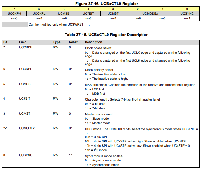

  • user4523305,
    According to the TDC7201's datasheet "Figure 1. SPI Register Access: 8 Bit Register Example", data is latched on rising edge of SCLK (CPHA=0) and the clock idles at 0 (CPOL=0). This combination is SPI MODE 0 as you first correctly indicated.
    To better understand how the SPI is confgiured on the MSP430F5529, you'll need to refer to the MSP430x5xx and MSP430x6xx Family User's Guide (Rev. Q). This document explains the details of the UCB0CTLx registers of the TDC7200_basic_spi_rw example. For example, in the following line of code:
    UCB0CTL0 |= UCMST+UCMSB+UCCKPH+UCSYNC; // 3-pin, 8-bit SPI master
    The default value of '0' is used for UCCKPL for "inactive state is low", and UCCKPH is set to '1' for "data captured on the first UCLK edge and changed on the following edge". This effectively sets SPI MODE 0. See the following UCBxCTL snippet from the family user's guide for details:
