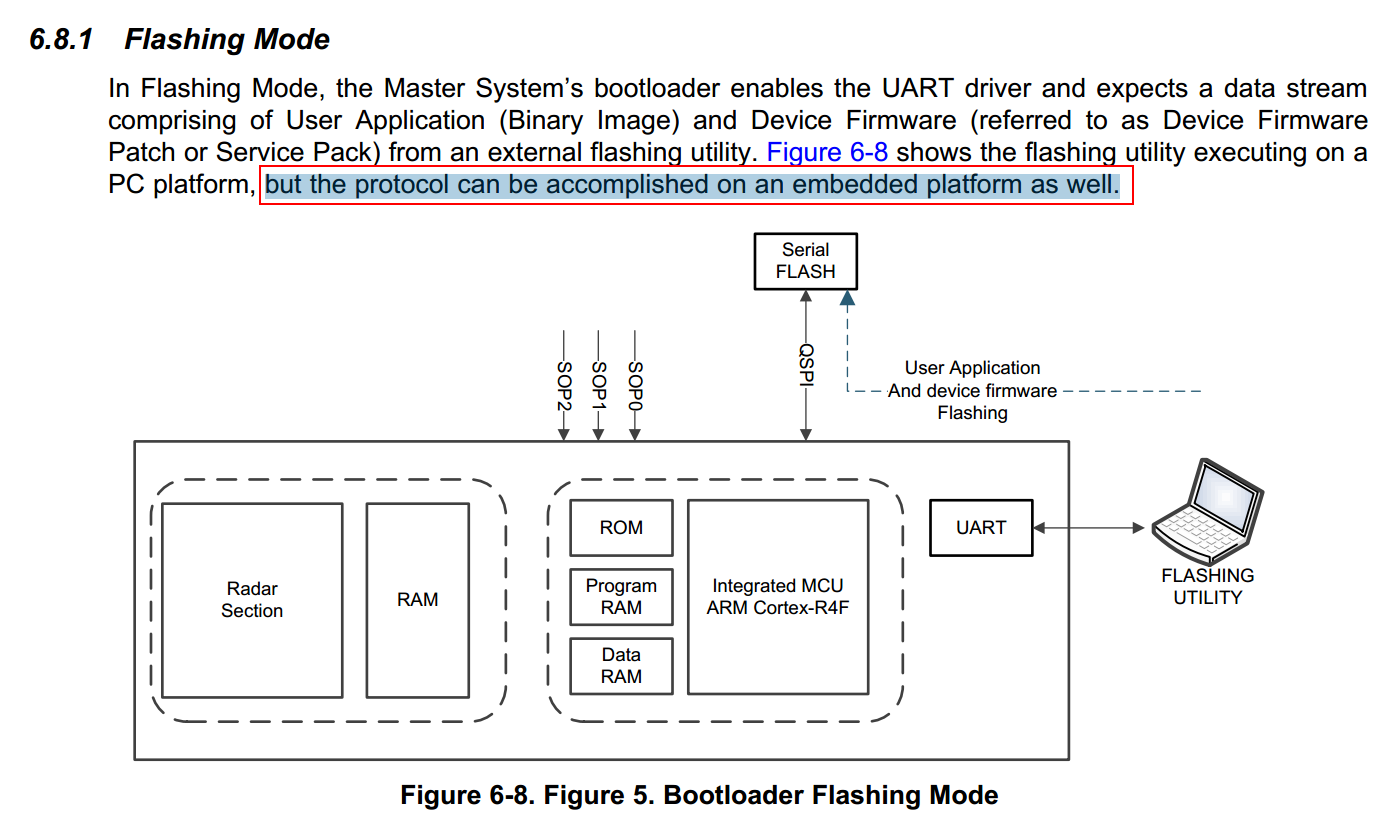

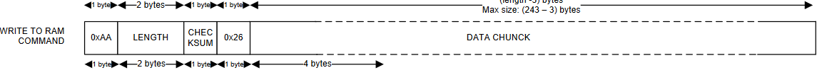

Hi Support team
In my application, there is a MCU(STM32F103) to control the whole board. IWR6843 RS232_RX/RS232_TX(CFG UART) are connected to MCU’s UART0, MSS_logger is connected to MCU’s UART1. The .bin image has been stored in a FLASH which is connected to MCU’s SPI interface. Now I want to use MCU to burn the IWR6843 (Using MCU firmware to simulate the function of UniFlash), are there some examples/DEMO available?
