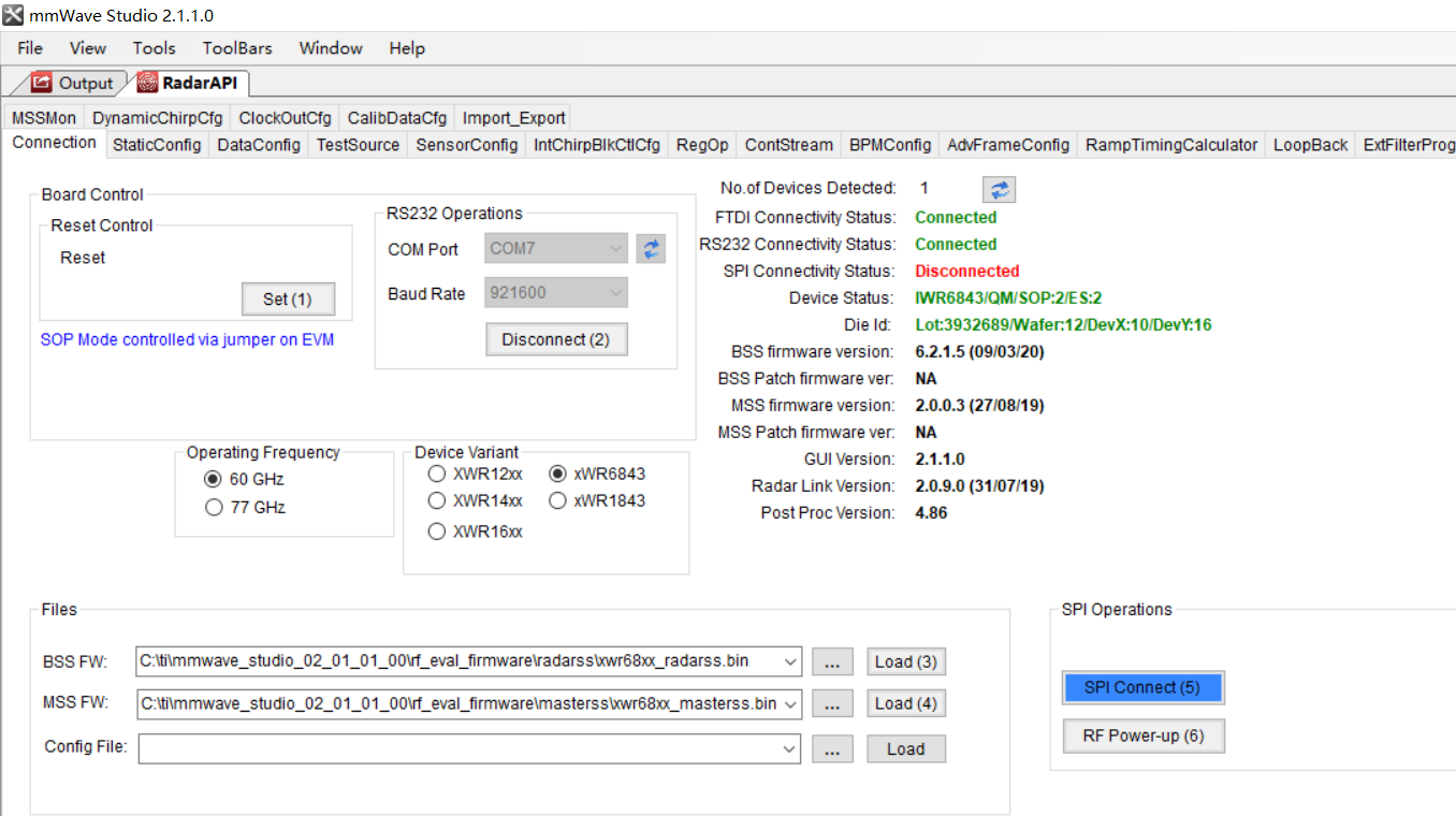

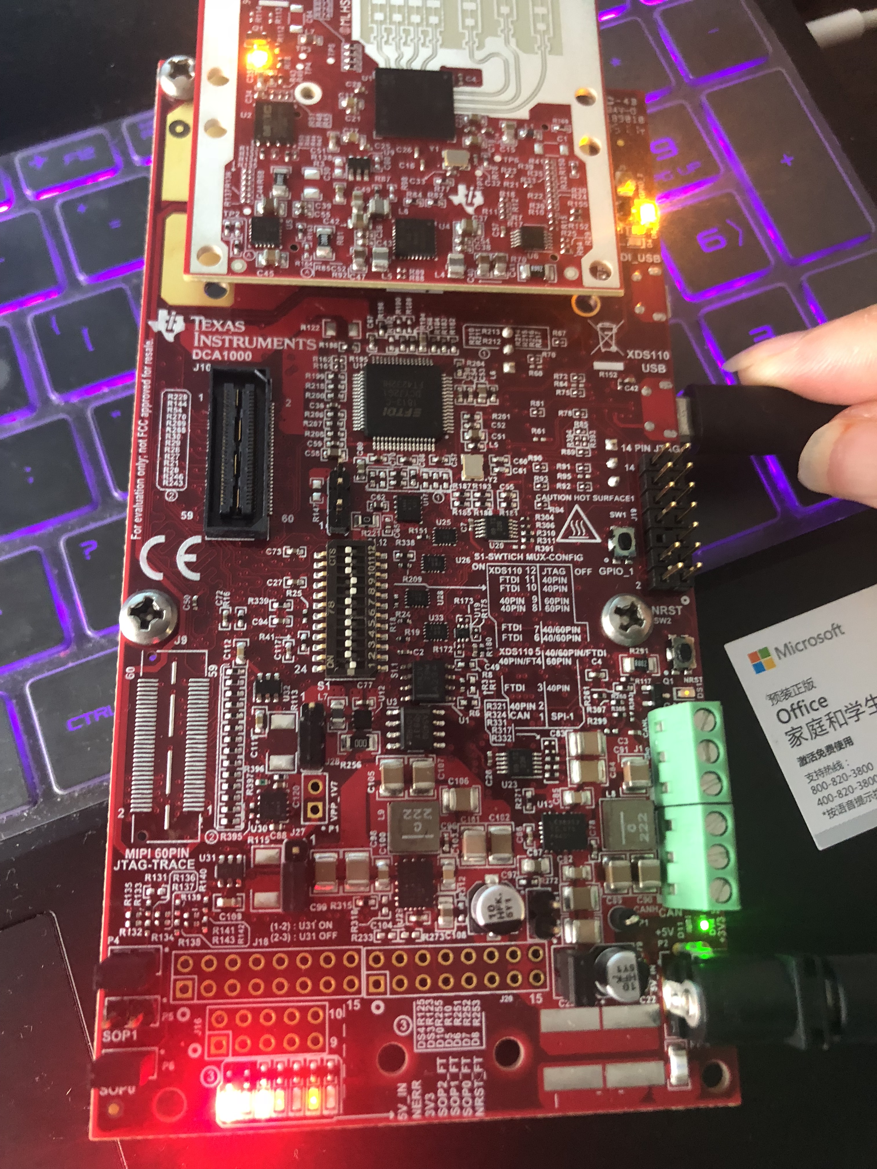

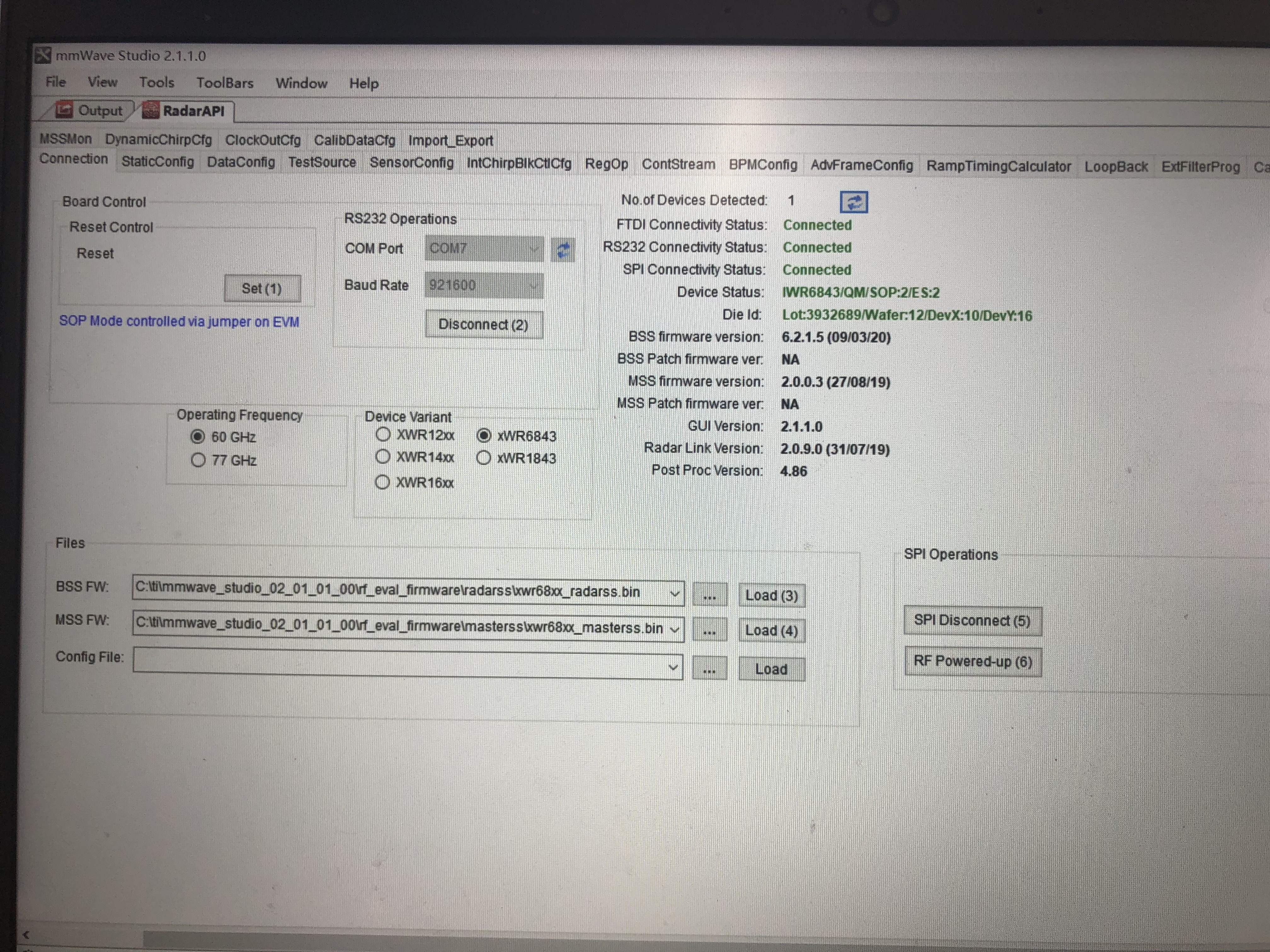

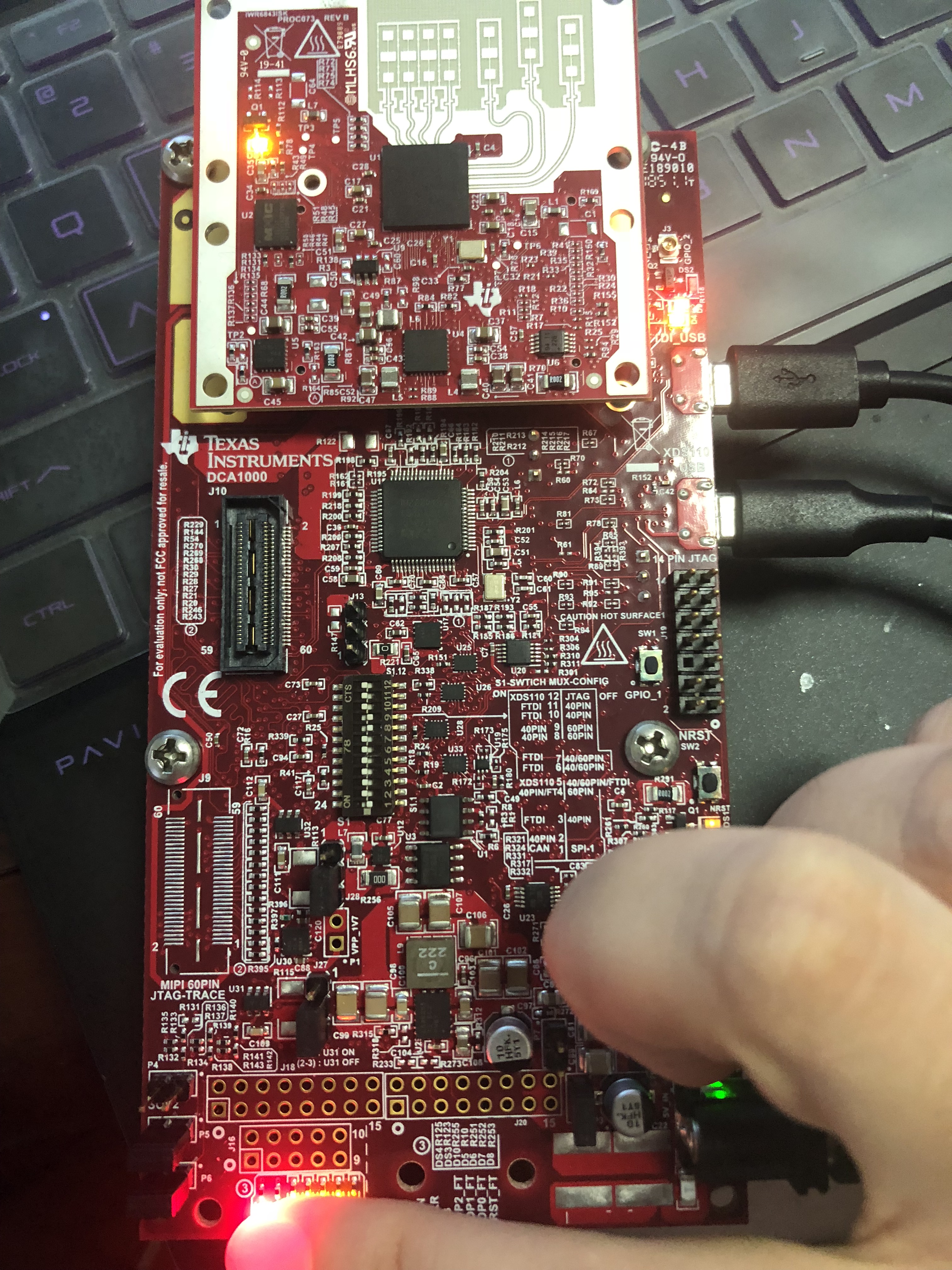

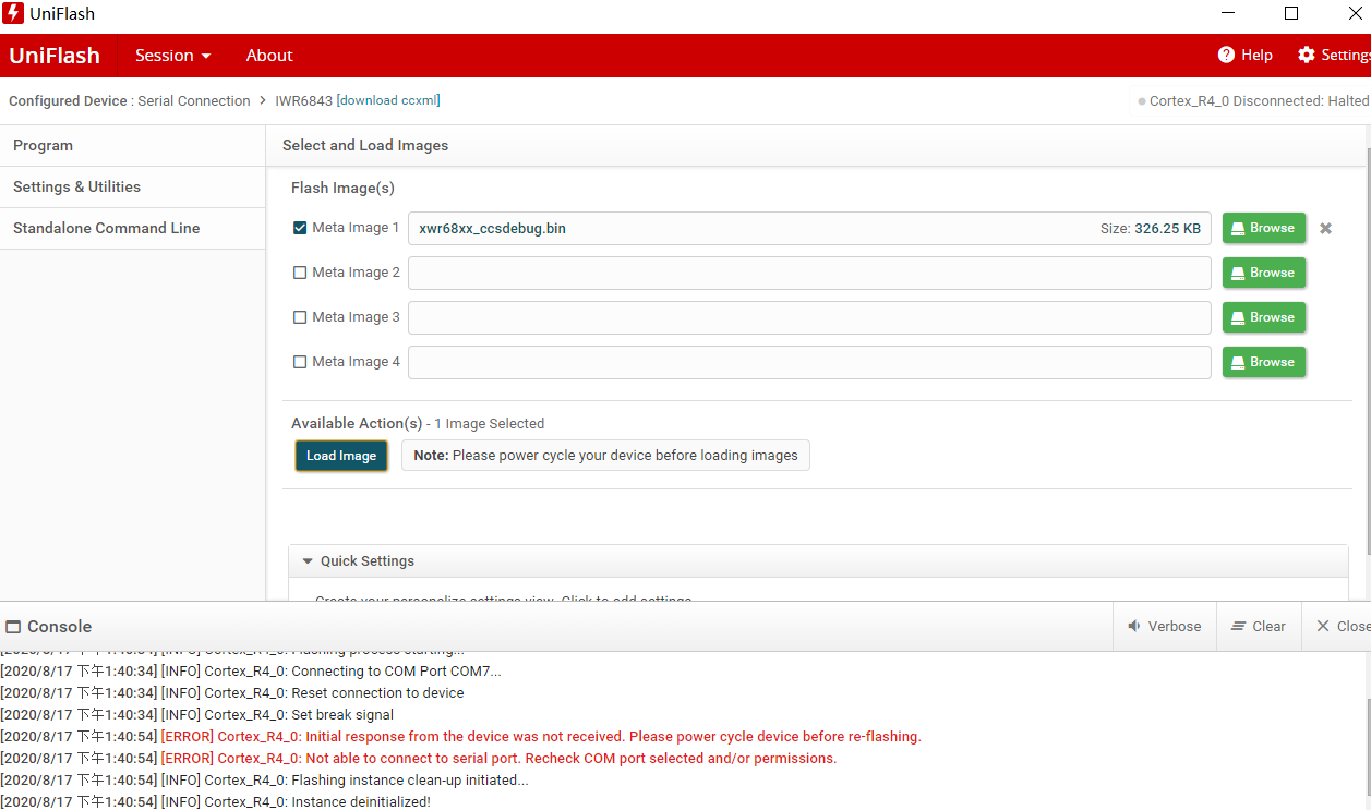

Hello,now IWR6843ISK has the same problem. I am sure the COM ports have been enumerated right and   have the right SOP settings for the flashing operation. But when using Uniflash and I get an error:

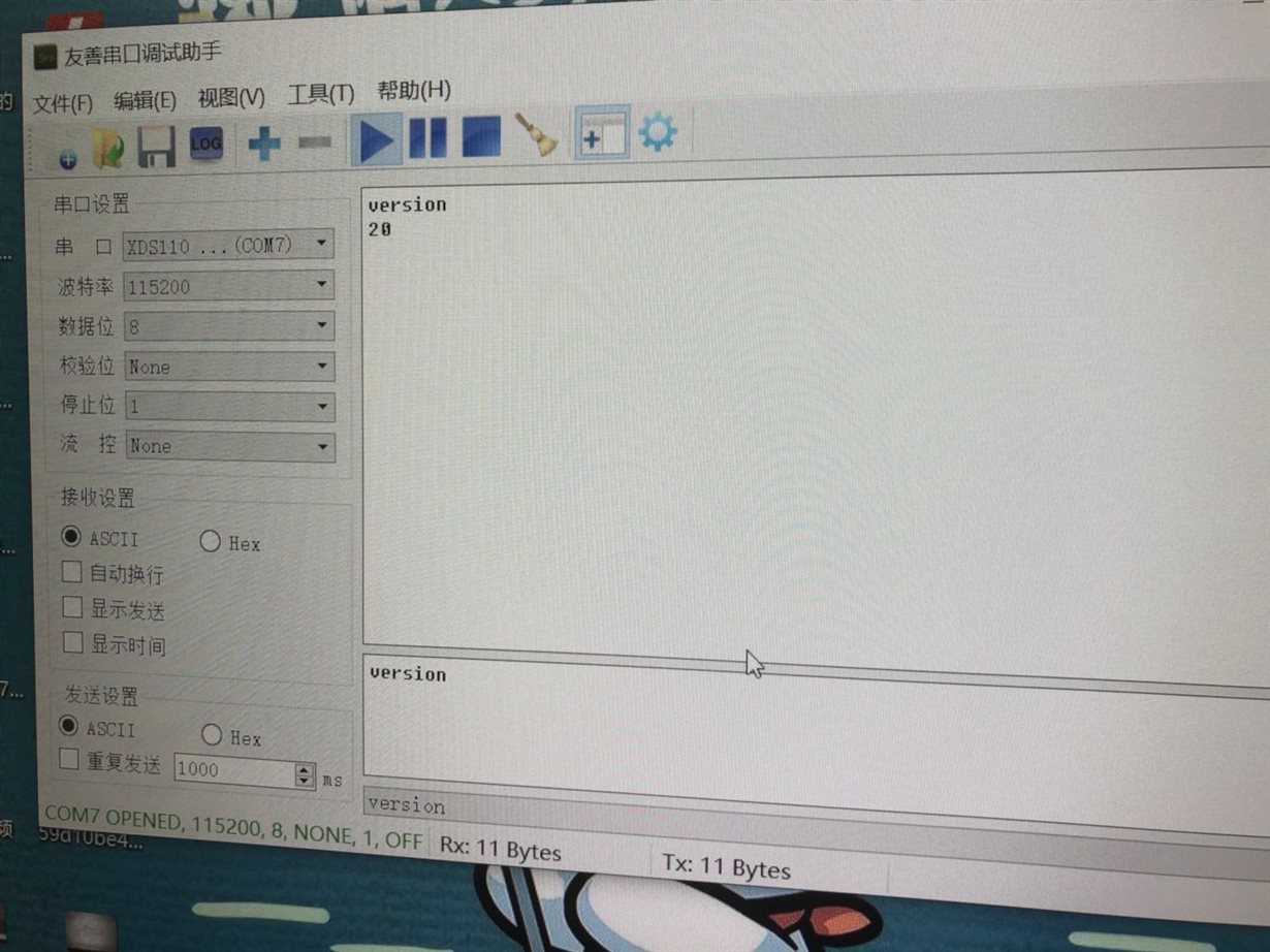

"Initial response from the device was not received. Please power cycle device before re-flashing." I am using XDS110 Class Application/User UART (COM7).There was no program in the chip before..The chip version is ES2.0. SDK version 3.4.0

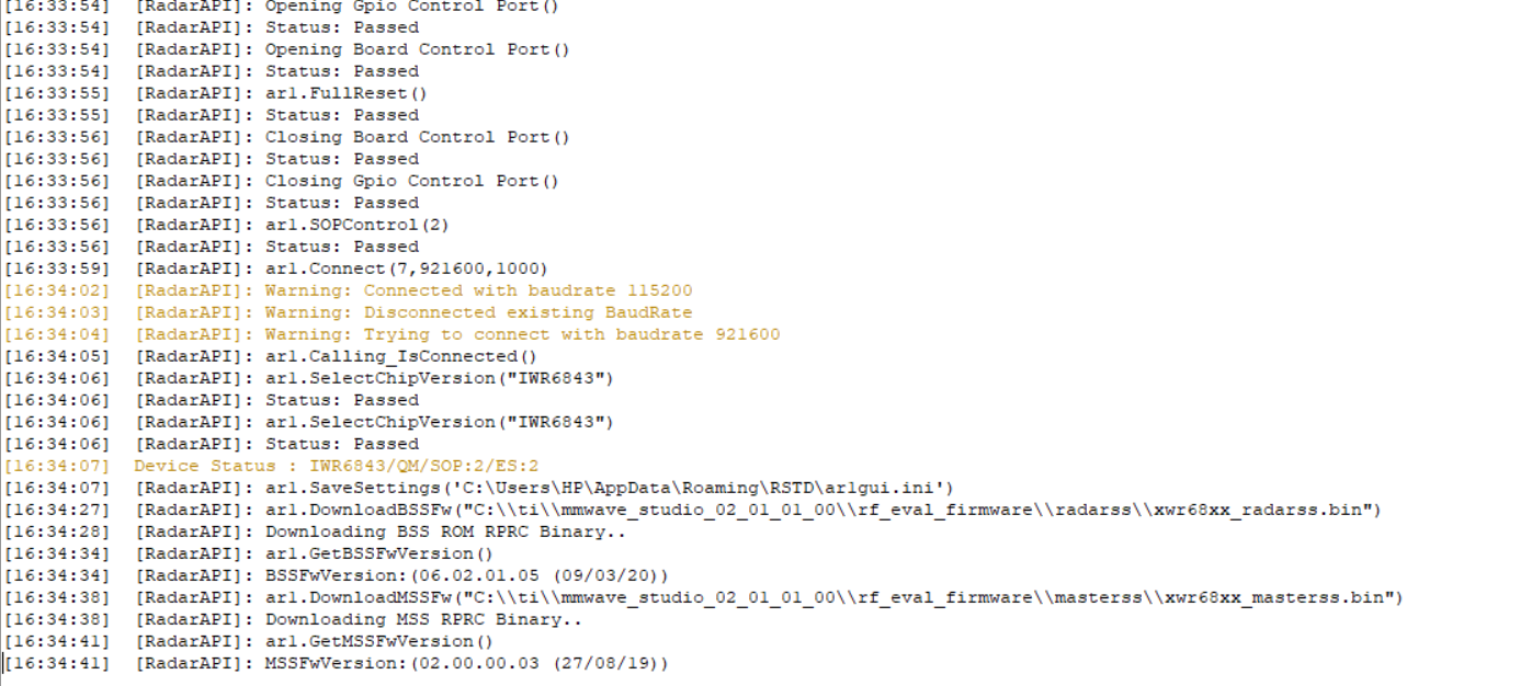

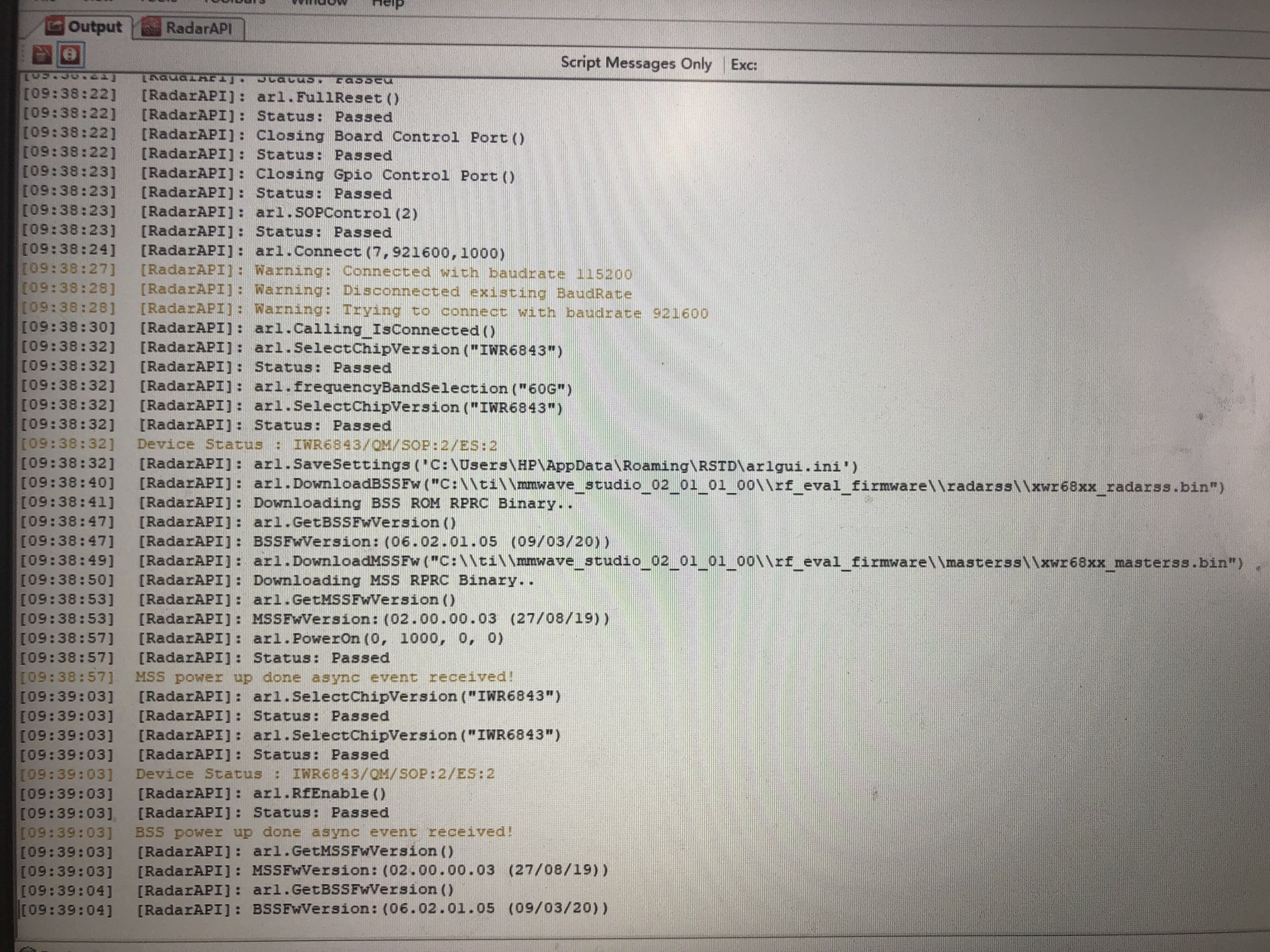

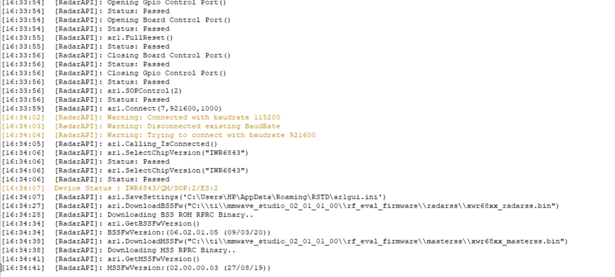

Then I used CSS to burn the program and there was an error:  (I did not use Unflash to burn the ccs debug bin file, because the same error will occur:"Initial response from the device was not received. Please power cycle device before re-flashing." )
