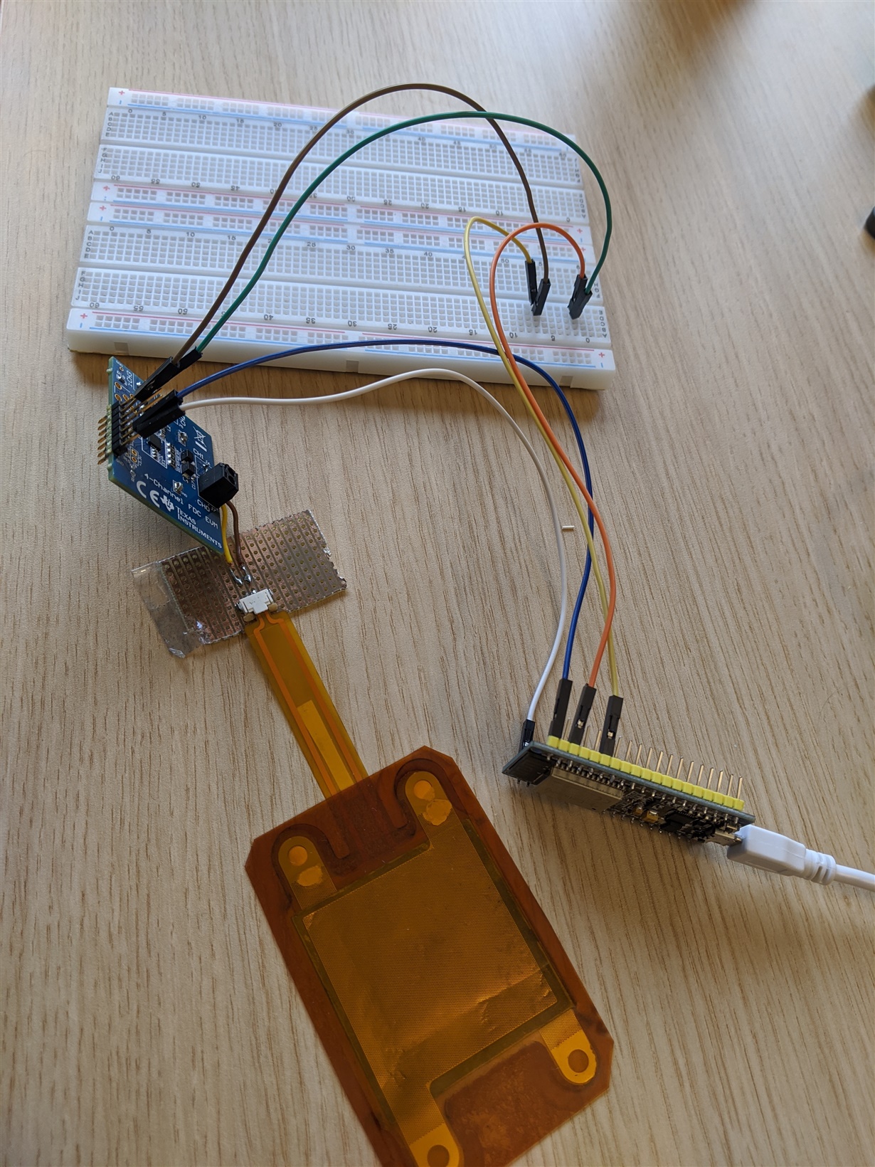

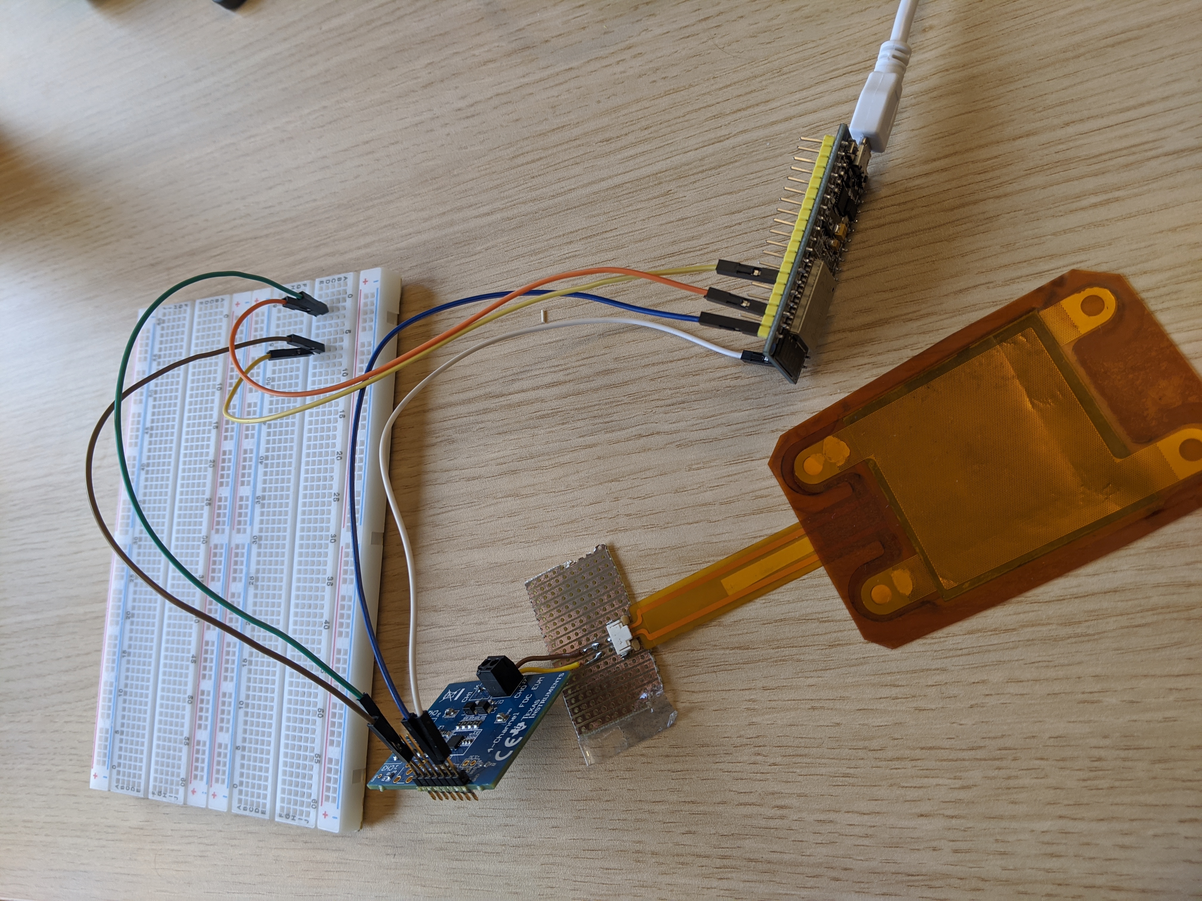

Connection:
ESP32 <--> FDC2214EVM
  • GND <--> GND
  • 3.3V <--> 3.3V
  • GPIO21 <--> SDA
  • GPIO22 <--> SCL
My problem is that if i start the ESP32 normally the communication via I²C should start. But it is not working. I am using the FDC2214EVM without the USB-Part and without the 2 sensor areas. I am only using the breakout board with 4-channels. The funny thing is that it works when I reset my ESP32 microcontroller and put my finger on the SDA pin and the SCL pin at the same time. Probably the I²C bus will be short circuited for a short moment.
Additonally i am using the Arduino IDE to flash my ESP32 and for the FDC2214EVM i am using the LIb from https://github.com/zharijs/FDC2214.
My Code for the ESP32 is the following:
