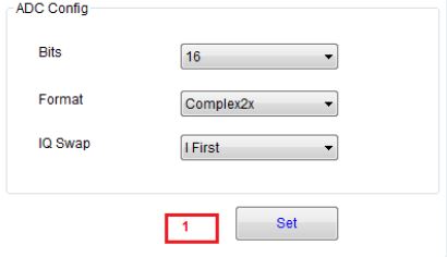

In ADC Config of mmwave studio, we can select I first or Q first.
In profile.cfg file of SDK, the parameter <SampleSwap> of adcbufCfg can be setted to be 0 or 1, which represents I in LSB, Q in MSB or Q in LSB, I in MSB respectively. But I don't understand the relationship between settings in SDK and mmwave studio. If we set the <SampleSwap> to be 1,does it mean the I first in mmwave studio?
