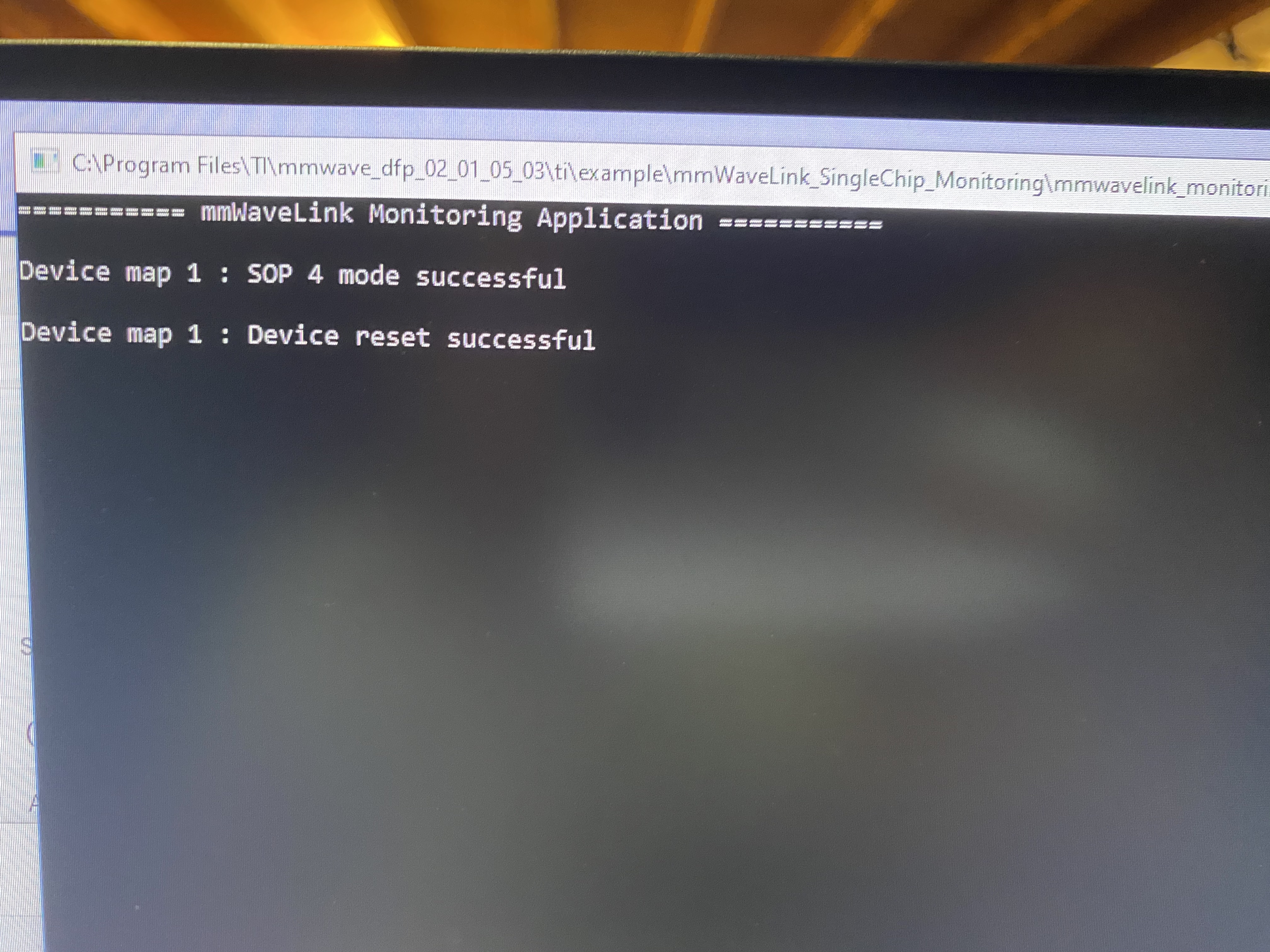

However, when I run mmwavelink_example.exe, it got stuck at below and never moved on

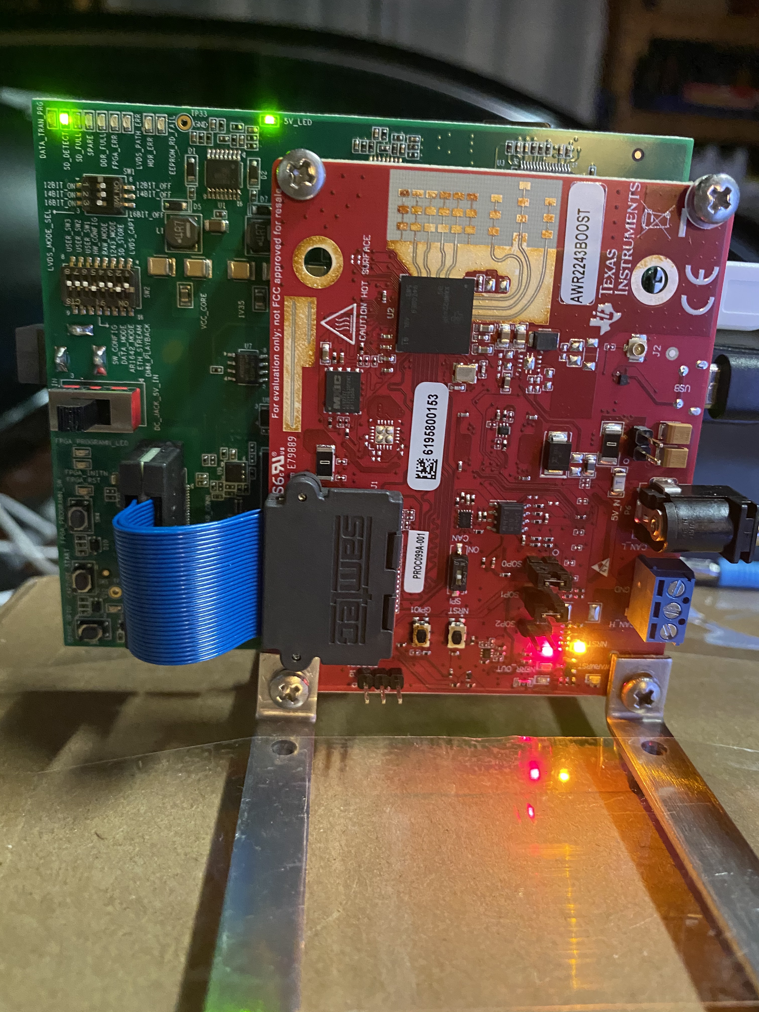

The board looks like this when it's powered.

    If you are running mmwavelink_example from DFP then device needs to be set in functional mode. As per your picture you have set jumpers on SOP-0 and SOP-1 header.
    Connect only SOP-0 jumper (other SOP-1 and SOP-2 leave open) to make device in functional mode.
    Then try the above example.
    NOTE:
    - If you are using DevPack with AWR***BOOST then SOP control can be done by the software (application/mmWave Studio). With DevPack, BOOST SOP jumpers can be overridden.
    - But with DCA1000EVM that override is not possible, user needs to manually set the Jumper on BOOST EVM to set device into functional (SOP4) or development mode(SOP2).
    Jitendra

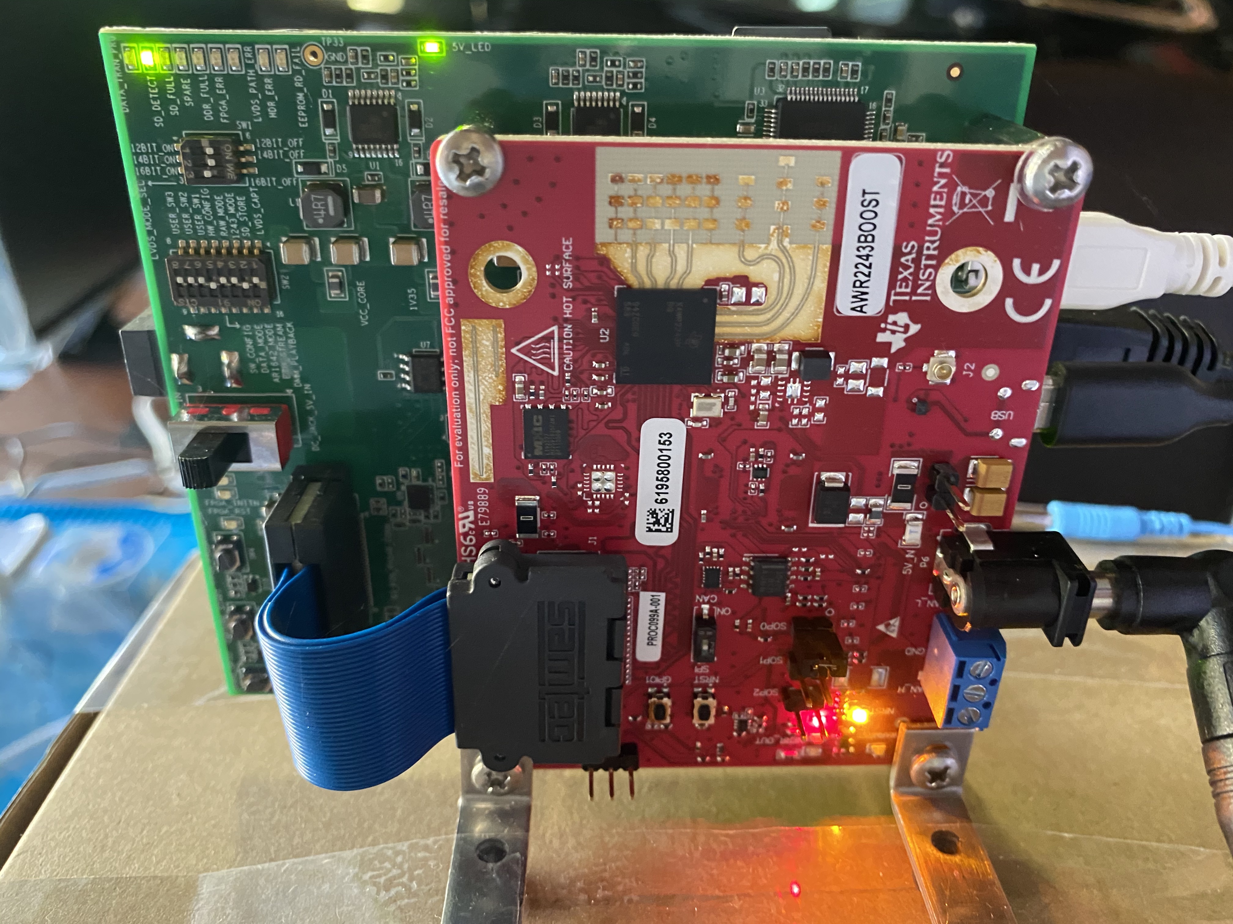

  • Thanks Jitendra for the quick response. However, after "Connect only SOP-0 jumper (other SOP-1 and SOP-2 leave open)", still stuck in the same place, no difference. See the Jumper setting below. Look forward to your further debug instructions.

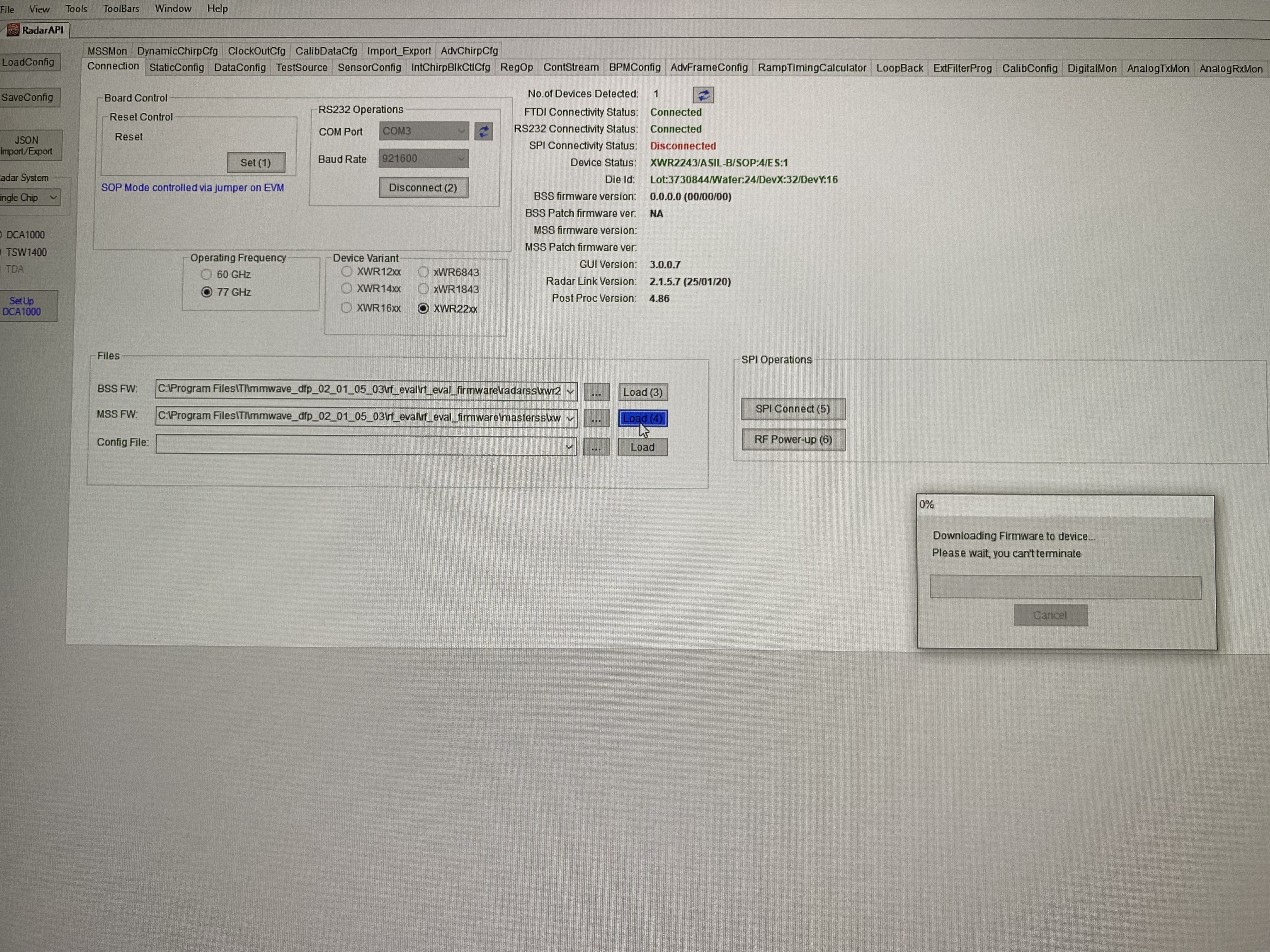

    Result: I can open the mmwave. But when I click buttons 1,2,3,4, it got stuck in 4th button, which shows "Downloading Firmware to device..." forever;

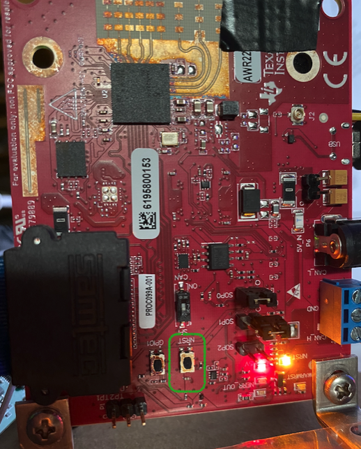

    Experiment #2:  Run mmwaelink_example.exe, when it gets stuck at "Device reset successfully", press NRST button (at the bottom) at the AWR2243boost EVM board. The button is circled out below in the picture.
    Result: it didn't do anything with pressing NRST. Still stuck at "Device reset successfully"

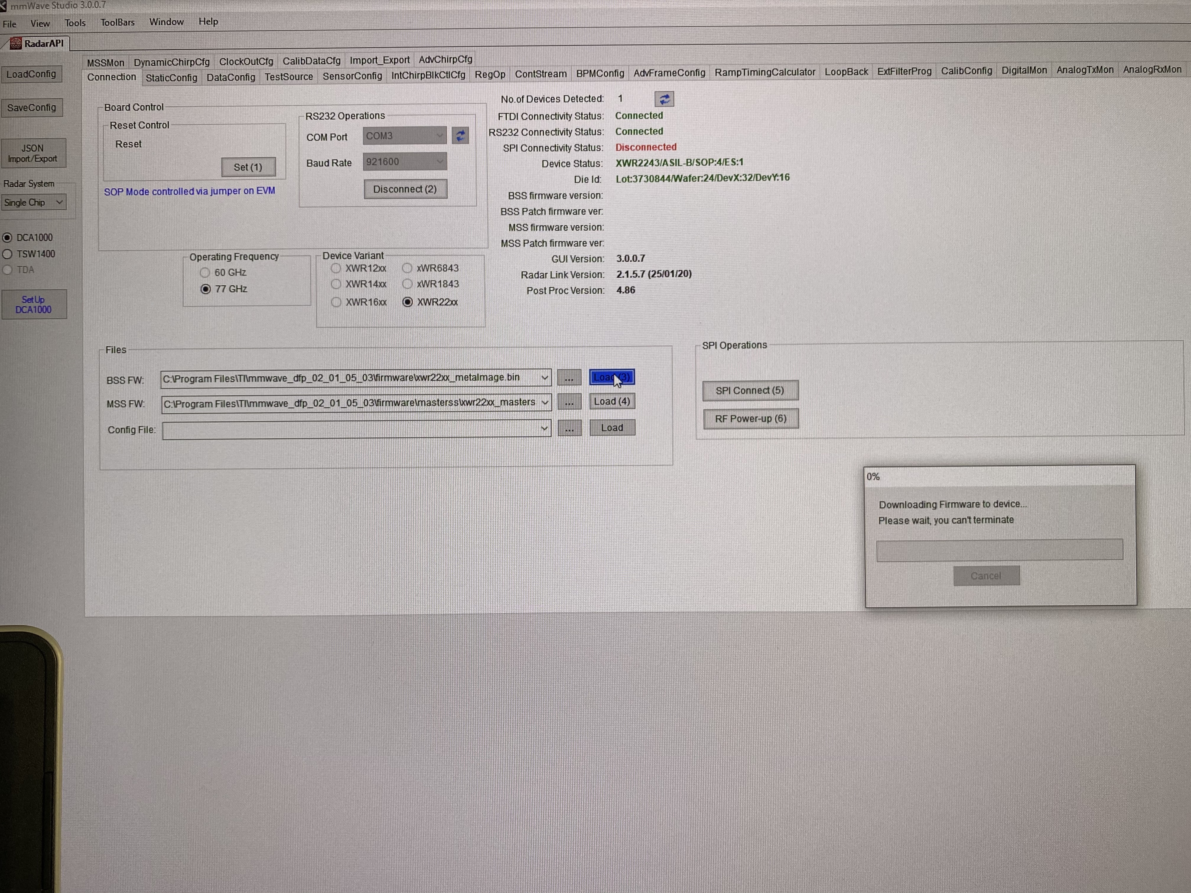

    In Functional mode with mmwave studio you need to use single metaimage binary (firmware\xwr22xx_metaImage.bin) file from BSS FW text field.
  • Hi Jitendra,
    In functional mode, I changed the binary file in BSS FW text field to firmware\xwr22xx_metaImage.bin and loaded it. Then it got stuck at 0% right there. See below. Please advise.
  • Hello Hank,
    In SOP-4 functional mode, there is slight change in the step.
    You need to connect SPI first, then download the firmware (meta image binary).
    As mmwave Studio is meant to use in mainly SOP-2 (development mode), so functional mode details are not given in the documentation.

    When you start the application it first reset the device, if it is not able to do that for some reason then try to manually reset the AWR device (by pressing NRST on EVM).

    Interesting. I just tried mmwavelink_example a few times, it runs with no problem. Is it possible the steps you asked me to go through somehow changes the board's status?
  • Main issue at your end with mmwavelink_example is that it's not able to reset the board and blocked at wait-for-poweron-async-event.
    So if you do device reset by mmwave studio then run, so effectively reset happens by studio and further steps is done by example, which makes that work.
    I assume that you are unblocked with this issue now.
    Jitendra
