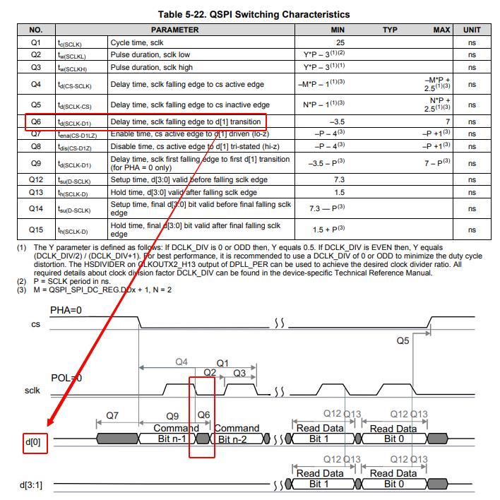

AWR1642: Question about QSPI timing in datasheet
Part Number: AWR1642
Other Parts Discussed in Thread: AWR1843
Is there a typo for d[1] in Q6/Q7/Q8/Q9 explanation? Shall it be d[0]?
