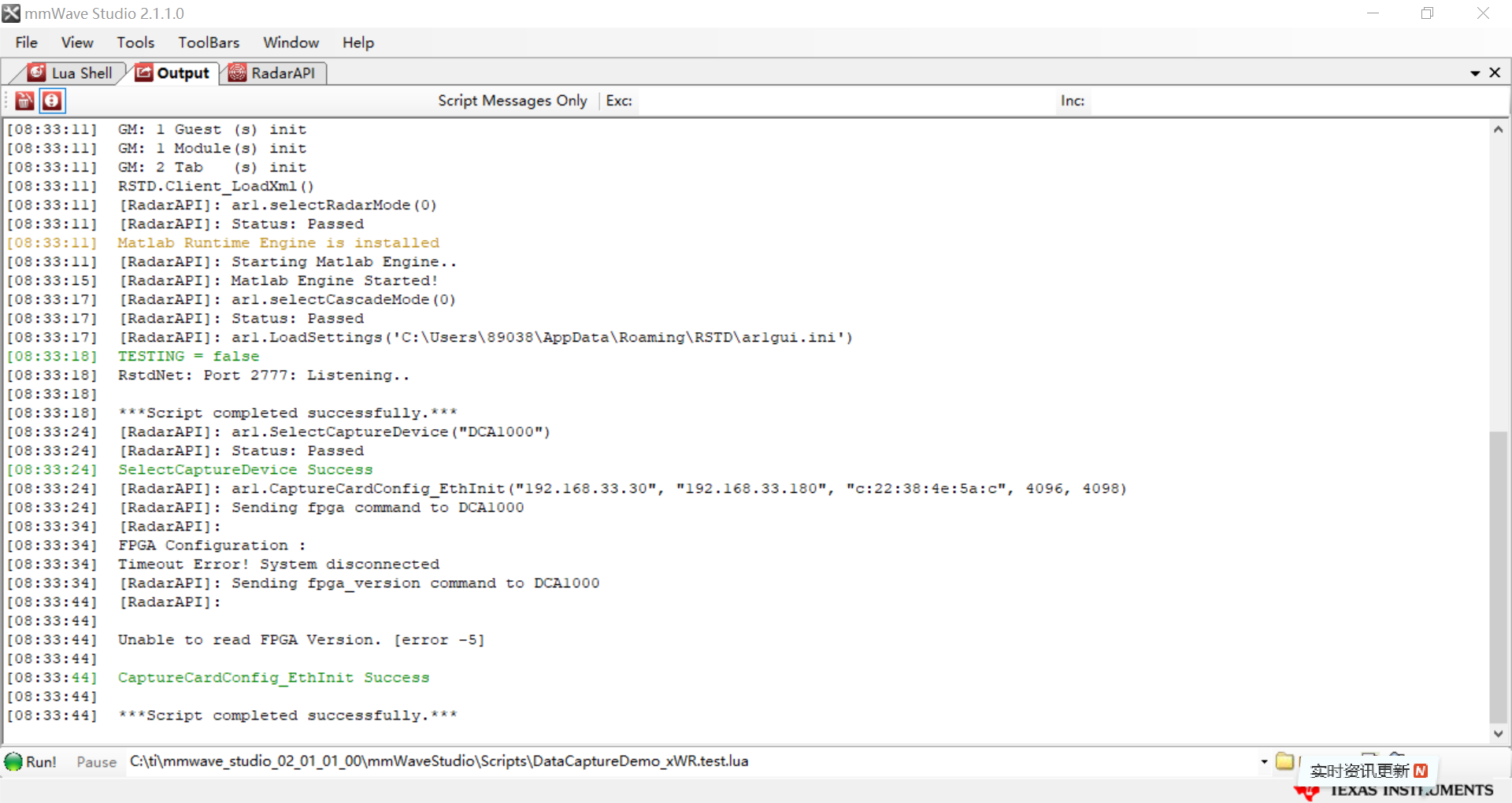

DCA1000 configure IP fail , what is the reason
1.1 as below:
[08:02:53] [RadarAPI]: ar1.SelectCaptureDevice("DCA1000")
[08:02:53] [RadarAPI]: Status: Passed
[08:02:53] SelectCaptureDevice Success
[08:02:53] [RadarAPI]: ar1.CaptureCardConfig_EthInit("192.168.33.30", "192.168.33.180", "c:22:38:4e:5a:c", 4096, 4098)
[08:02:53] [RadarAPI]: Sending fpga command to DCA1000
[08:03:03] [RadarAPI]:
[08:03:03] FPGA Configuration :
[08:03:03] Timeout Error! System disconnected
[08:03:03] [RadarAPI]: Sending fpga_version command to DCA1000
[08:03:13] [RadarAPI]:
[08:03:13]
[08:03:13] Unable to read FPGA Version. [error -5]
[08:03:13]

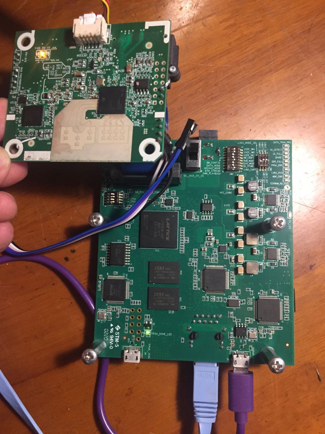

There is a IWR6843 board(customer board) and DCA1000 board, I connect them with LVDS
2.2
IWR6843 board is burn software correct
It support output ADC info by LVDS, and need to test
2.3
IWR6843 support with 5V/3A power
DCA1000 is powerd by IWR6843 board
2.
DCA1000
FPGA_DONE_LED is green
5V_LED is green( it is indeed green,  cant now show obvious in snapshot picture)
2.5
A USB line and A network line is connect between PC and DCA1000

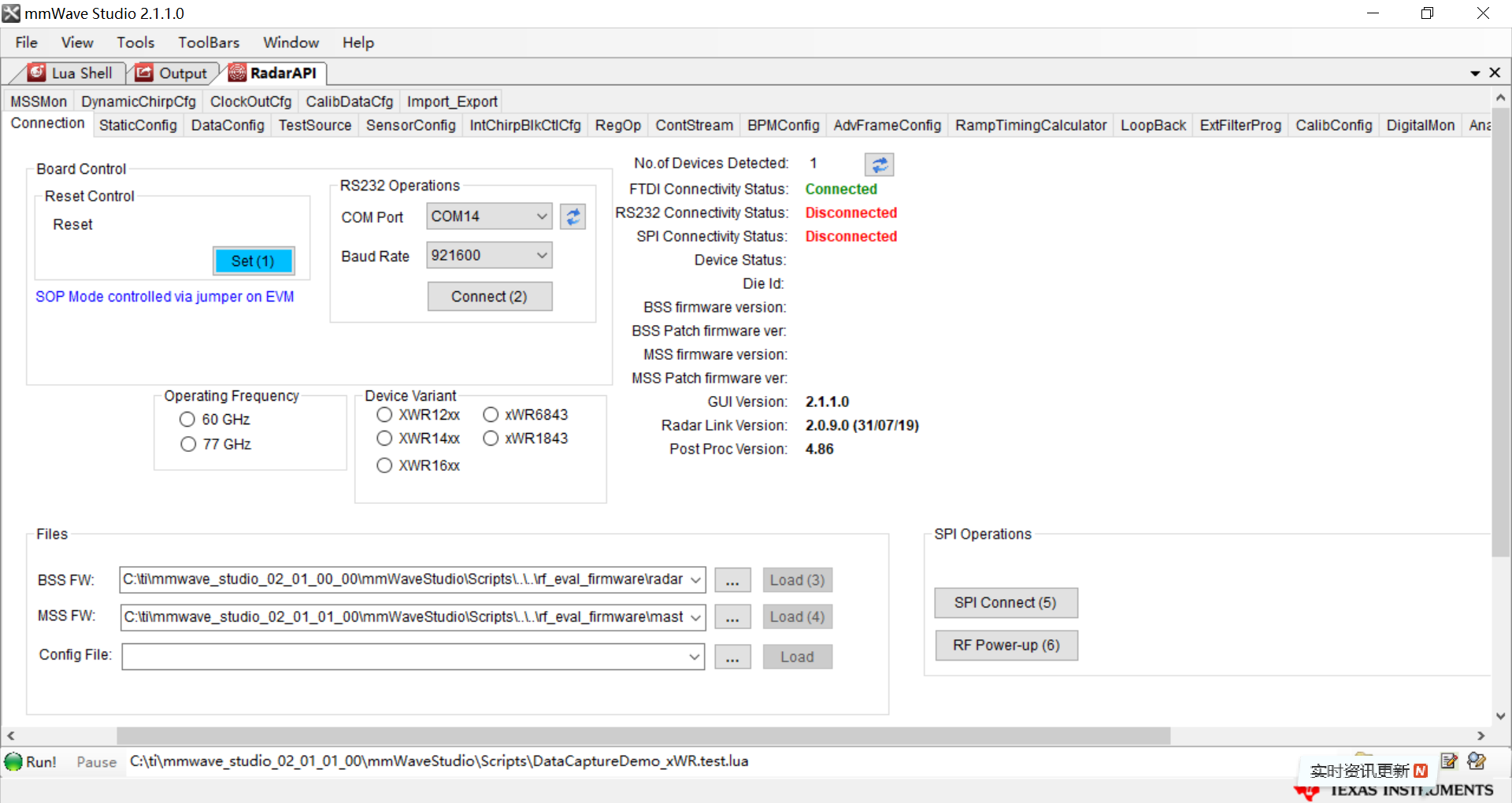

I do as below
3.1 Power ON
3.2 Run mmWave Studio 2.1.1.0
3.3 Run DataCaptureDemo_xWR.test.lua
3.4 watch output

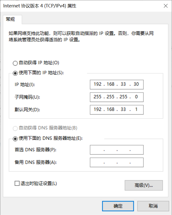

  • 1. Network is set correctly ,and firware are closed .

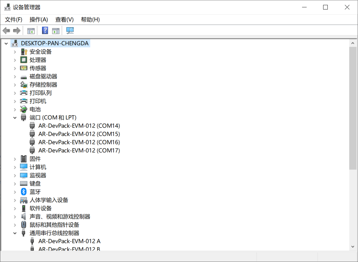

  • 1. the USB cabe seem correct

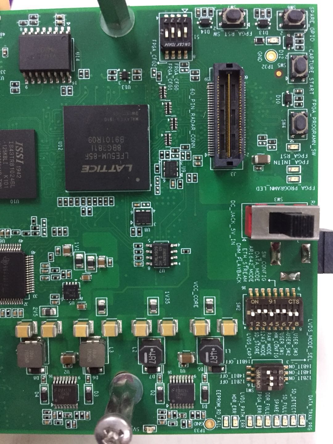

  • 1.And DCA1000 is
    SW_CONFIG
  • 1.
    DCA1000 switch details
  • I found a SOP mode on IWR6843 issue, let me check first.
