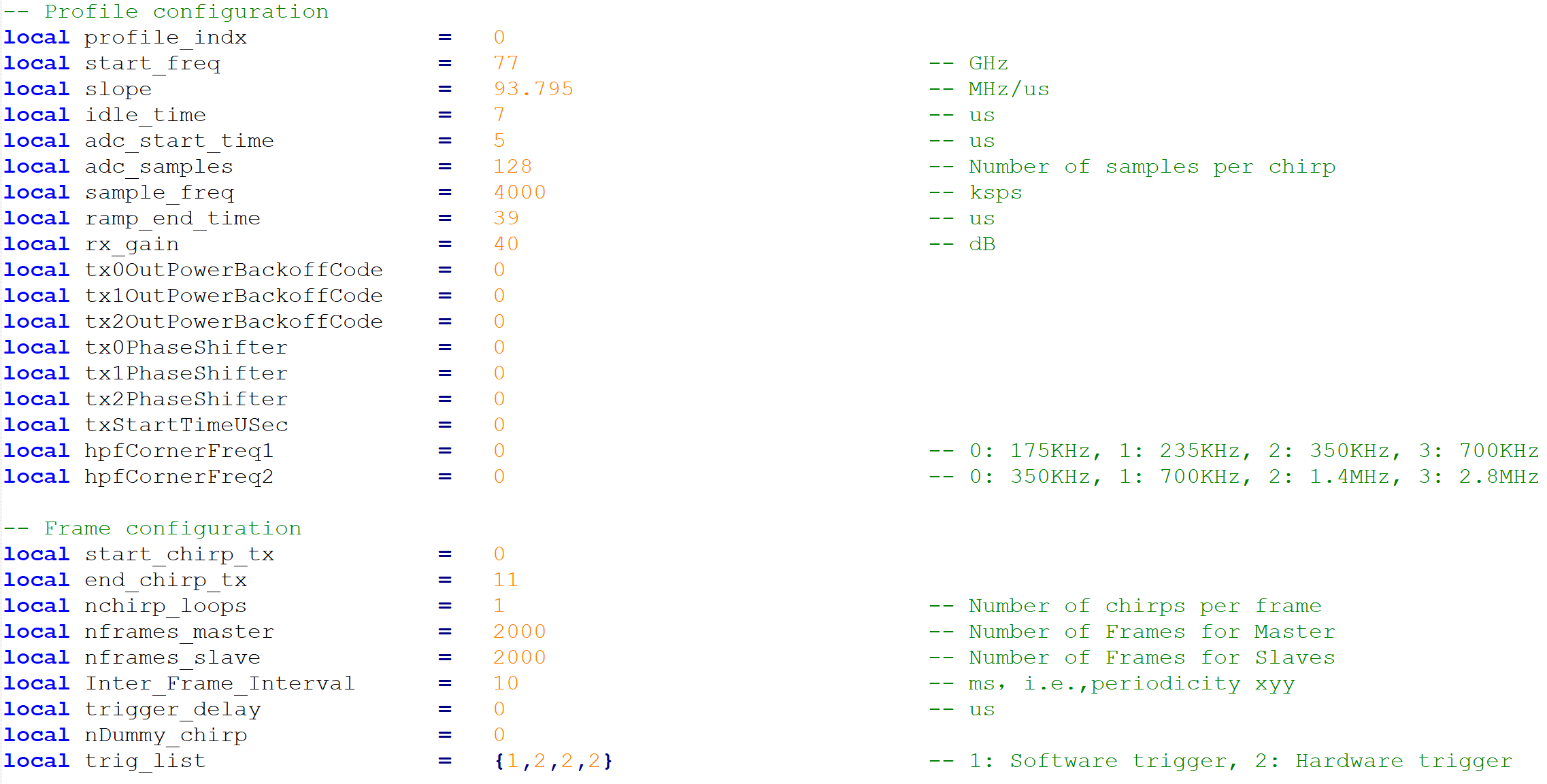

When I use the MMWCAS-RF-EVM and MMWCAS-DSP-EVM, I can capture the raw data with mmWave studio software by tranfering from SSD.
However, the question is the total number of frames of the transferred raw data is not equal to the setting number of frames. For example, when I set the frame is 6000, the number of caputered frames is about 5800 (they are different for per caputure). The frames are lost large.
So, how to solve this problem?
Thanks very much for your help.
