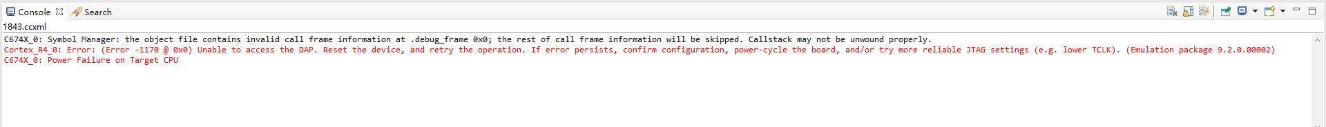

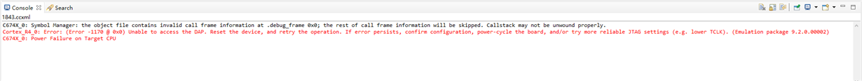

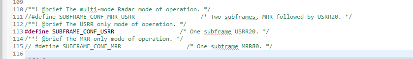

Due to the negligence of our schematic diagram design, our awr1843 board could not support the simultaneous sending of three TX antennas, so I need to change the MRR demo to the USRR only mode. I commented out both macro definitions SUBFRAME_CONF_MRR_USRR and SUBFRAME_CONF_MRR in mrr_18xx_mss and mrr_18xx_dss projects, leaving only SUBFRAME_CONF_USRR.This seems not enough, because when CCS debugs the project, there will still be a direct power failure. Do I need to modify anything else in the project?
  • MACRO changes you made looks correct to enable USRR.
    But the error message what you have posted doesn't map to this code change.
    Does the application boot up with this code change? What is the status of application when you flash the metaimage from this build?
