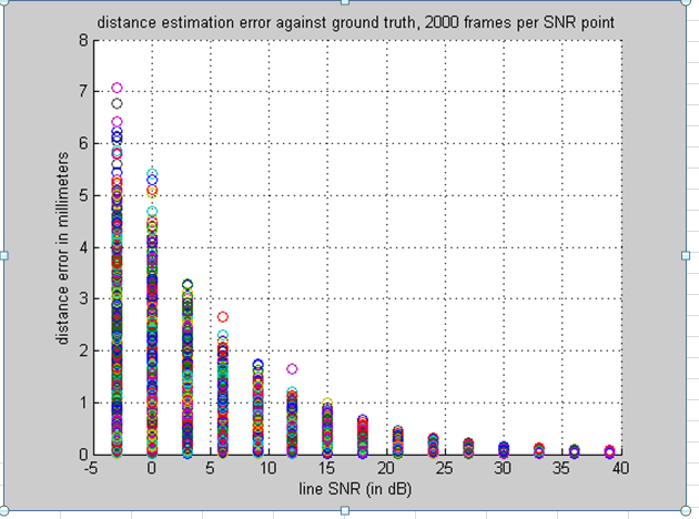

Thank you ,Chethan!
I agree your point , but I would like to know the level measurement accuracy with software setup, for example in your below lab, what is the level measurement accuracy? what is min distance can be used to do the level measurement? for example can I detect 50mm distance?
Thank you!
steven
Steven,
Measuring 50mm distance should not be problem at all, With the decent SNR within couple of millimeter should be possible.

But I find some big error to measure 50mm with your demo board, I consider sensor has to be calibrated, do you how to do this?
steven
Steven,
Could you please share what kind of error you are seeing? Any measurement plot would be helpful to understand.
Yes, calibration is necessary you could refer below link for calibration link in SDK package.
