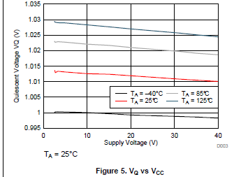

I have a question for temperature drift of V_Q of DRV5053.
According to Figure 5 (below) from the datasheet, VQ value increases as the temperature increases.
Do all DRV5053 devices have this same tendency?

Oba,
Thank you for your question. Unless noted otherwise in the datasheet, you should expect the performance of each parameter to apply across each packaging or sensitivity variant.

Hello Scott,
Thanks for your answer.
What I want to know is about piece-to-piece variation. I know this graph is usually just typ data.
Do all pieces (DRV5053PA) have the same tendency that VQ value increases as the temperature increases ?
Or is there a possibility that some pieces could have different characteristic?
Oba
Oba,
I understand what you mean now. I have seen no data to suggest that the device to device trend is anything beside what is shown here in the datasheet. I would anticipate that they all follow this trend.
