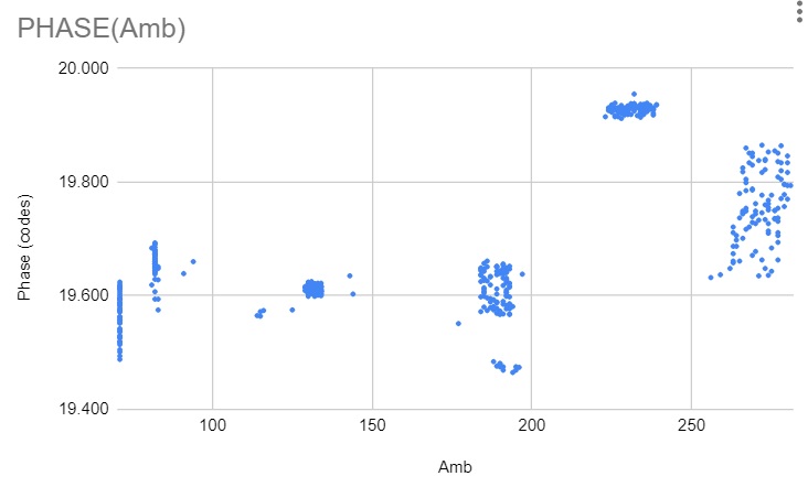

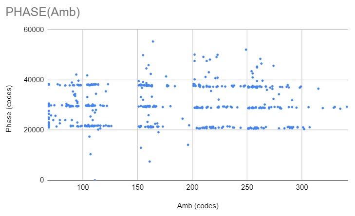

In addition, I went on with this calibration step although the 10000 codes were not reached. The plot obtained is the following one.
Could you tell me why am I receiving this 3 slopes?

    I don't think your picture attached properly. Could you please repost this? Also could you elaborate what you mean by test step when you say "while running the TEST step, the amplitude is 12000 codes".  Could you also provide more details for this step "When I run the step 4, the amplitude measured is 50 codes"? What exactly are you running and if you could share the output for this that would be helpful.
    Alex
  • Hi Alex
    Thank you for your quick reply.
    Here is the reposted picture.

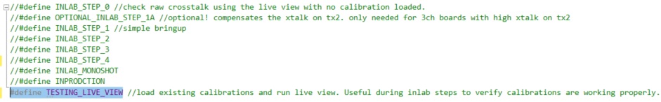

    I am running the SDK in Visual Studio. I'm following the docs "OPT3101 SDK Users Guide" and the "How to set up and calibrate OPT3101 based systems for
    proximity sensing". The different steps for calibration are defined in the main.cpp. The TESTING_LIVE_VIEW is used for verifying that the calibration works properly.

    Moreover, when I plot the data collected I am not getting those three slopes I attached in the last post. The plot obtained now is the following one:
    Could you please verify if what I have done is correct?

    Regarding phase ambient, please first ensure that all other calibration tests were done correctly (temp xtalk, xtalk correct, phase temp) and that the board is stable over temperature. What is the raw xtalk magnitude measured before correction? Then we can look at your test setup for phase ambient. Can you share a picture of the setup and describe how you are varying the light level? Why are there large gaps in the ambient in the graph where it jumps 130 to 190 to 230? Also there are also locations where there are many phase values for a given ambient in your plot. It looks like the readings are not stable when ambient is constant. If you refer to the guide you see that plot data is much more stable so this will need to be troubleshooted.
