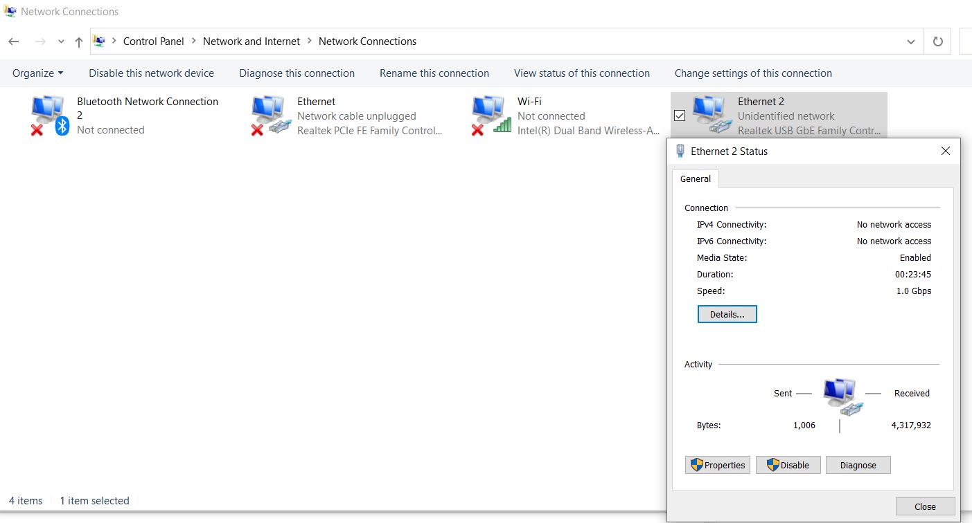

We are using DCA1000 EVM with AWR1642BOOST ES1.0 and mmwave Studio v 1.0.0.0 running on Window 10. We followed the exact steps in the DCA1000 quick user guide when connecting both the DCA1000 and the AWE1642 EVM and the mmwave studio was used to configure and control the devices to capture the raw ADC data. We faced similar issues posted in  previous forums
- Unable to identify the FPGA version: FPGA version is 0.0.0.0,
- Ethernet connectivity issues: Ethernet Cable is disconnected Please check......!!!”
- Data Capture related issues.
Based on the recommendations given in the forums and going through the DCA1000 Debug Handbook: the following steps were taken to resolve these problems.
  • A USB 3.0 Gigabit Ethernet Network Adapter was purchased to resolve the connectivity issues with PC over the Ethernet when direct Ethernet connection from PC to the DCA1000 was initially used. The static IP address was reconfigured correctly.
  • The windows Firewall was disabled, and the ports were enabled in both outbound and inbound rules
  • Two separate power supplies (5V/4A) for the DCA1000 and the AWR1642 EVMs were used all the time.
  • Wireshark tool was installed, and the connection was shown between both the PC and the DCA1000 board.
  • Re-flashed the FPGA to the latest version 2.8 using lattice programmer software.
 As shown in previous forums, the issue was resolved by using either one of the steps or a combination of steps shown above. However, in our case the problem is still not resolved, and the FPGA version is still not identified.
-  Again, when using the mmwave Studio, in the ‘setup DCA 1000'  the FPGA is still shown as version 0.0.0.0., and when we tried to "Connect, Reset and Configure" the RFDataCaptrurecard, the following error message appeared:
“ConnectRFDCCard Status: RFDCCARD_UDP_WRITE_ERR
Ethernet Cable is disconnected Please check......!!!”  . We also tried to increase the packet delay to 100 µs, and we still have the same error message.
-  In addition, after running the DataCaptureDemo_xWR.lua, the Data_Trans_PRG LED on the top left corner of the DCA1000 board is turned on and the Wireshark showed a transfer of UDP packets from the DCA 1000 to PC (please see  the figures below). However, Ethernet connectivity error was shown and the generated adc_data.bin is empty. An error message was also shown after post processing step with MATLAB since the .bin files were empty. The output log file is also attached.

  • Aya,
    Is there a reason that you chose to use a USB to Ethernet adapter over the PC Ethernet connection?
    Kyle
  • Aya,
    Can you provide screenshots of your "Network Connections" screen from the Windows Control Panel? Specifically, the connections for the USB adapter but also the main screen so the other connections are viewable.
    Kyle

  • Hi Kyle ,
    Thank you for your response. it is greatly appreciated.
    Regarding your first reply:
    - I initially used a direct PC Ethernet connection and correctly configured the IP address but I was getting that error message all the time   "RFDCCARD_UDP_WRITE_ERR  Ethernet Cable is disconnected Please check.....!!!".
    In addition I always had zero received bytes when I checked the direct Ethernet status connection in the Control panel window . so I thought there might be a problem with the Ethernet cable. I used another cable but still got the same error.  When I went through similar issues in the forum I found that it was resolved by using USB Gigabit Ethernet Network Adapter. That was the reason I chose to use the adapter for connection. After using the adapter I can see some bytes received as well as UDB packets transferred in the Wireshark window. But still the problem was not resolved.
    - I am attaching the screen shots for my network connections and the USB adapter connection after I ran the data capture demo as you requested hopefully you see some issue I don't see.
    Please advice if there is an issue before attempting to re-flash the FPGA with the 2.5 version.
    Thank you very much

    [15:46:58]  [RadarAPI]: ar1.CaptureCardConfig_EthInit("192.168.33.30", "192.168.33.180", "12:34:56:78:90:12", 4096, 4098)
    [15:46:58]  [RadarAPI]: Status: Passed
    [15:47:00]  Ethernet Cable is disconnected Please check.....!!!
    [15:47:00]  CaptureCardConfig_EthInit Success

    [15:57:32]  [RadarAPI]: ar1.CaptureCardConfig_EthInit("192.168.33.30", "192.168.33.180", "12:34:56:78:90:12", 4096, 4098)
    [15:57:34]  ConnectRFDCCard Status: RRFDCCARD_SUCCESS
    [15:57:34]  Ethernet Cable is disconnected Please check.....!!!
    [15:57:48]  [RadarAPI]: StatusDCCard Event Registered
    [15:57:48]  [RadarAPI]: Status: Passed
    [15:57:48]  [RadarAPI]: ar1.CaptureCardConfig_EthInit("192.168.33.30", "192.168.33.180", "12:34:56:78:90:12", 4096, 4098)
    [15:57:50]  ConnectRFDCCard Status: RFDCCARD_UDP_WRITE_ERR
    [15:57:50]  Ethernet Cable is disconnected Please check.....!!!

    Thank you
  • Hi Kyle ,
    I changed the baud rate to 961200. I still have the same problem when I ran the demo and also when i tried to click on setup DCA1000
    I am attaching both logs to show the details. Please take a look at them and let me know where to go from there.

    - Also , Is there anything wrong with my Network connection status from the screen shot I sent earlier?
