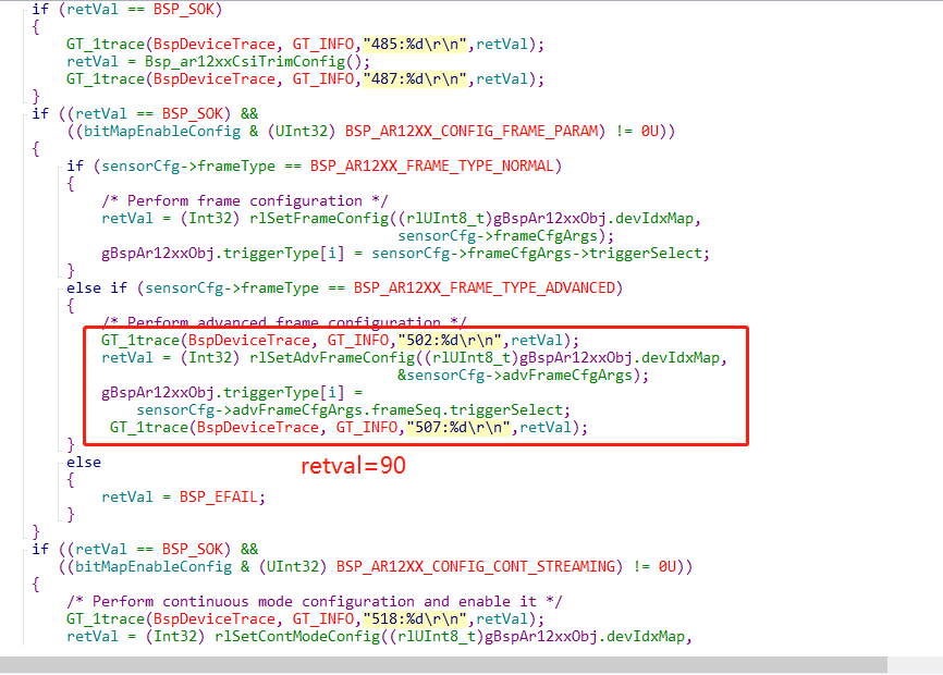

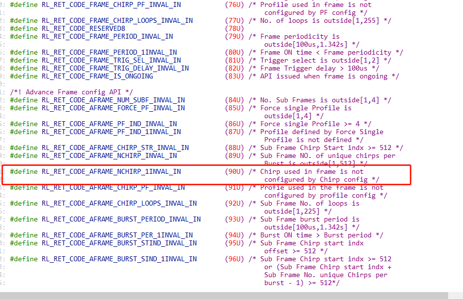

In TXBF mode, add a MIMO mode subframe.After we modify chirp and frame configuration, the error return value is 90 when running.It is worth knowing that the Chirp used in the frame is not configured by Chirp.So please point us out where we need to change.thank you

Make sure that chirp index used in the frame or advFrame are being configured before usingrlSetChirpConfig API.
Check all the chirps index range in all the subframe of sensorCfg->advFrameCfgArgs and back check if those chirps index configured before this advFrame API call.

Thank you very much for your guidance.At present, the program can normally run the subframes of TXBF mode, but the MIMO subframes I configured do not run.There is no alternation.So I also need to make changes in those places to get the MIMO subframes running.
Is this something you are getting return error value or another point that is blocking you for advanced frame implementation.?
You can refer this old thread on similar topic-https://e2e.ti.com/support/sensors/f/1023/p/908681/3405101#pi320995=1
