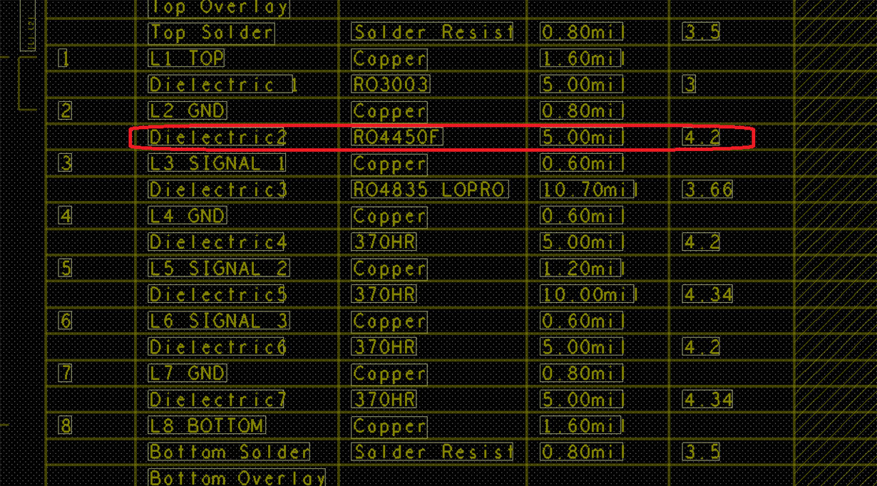

Hi all
I see  TI has a cascade board of four chips of AWR2243 (tidm464)
When i check the design files of this demo board , i find that it uses the material of R04450F for the Dielectric 2.
The RO4450F only has 4 mil thickness and the Dielectric Constant is 3.52 in Rogers datasheet
But in TI's demo board files that it is not the same as the datasheet of RO4450F.
So i want to know why does they are not the same?
