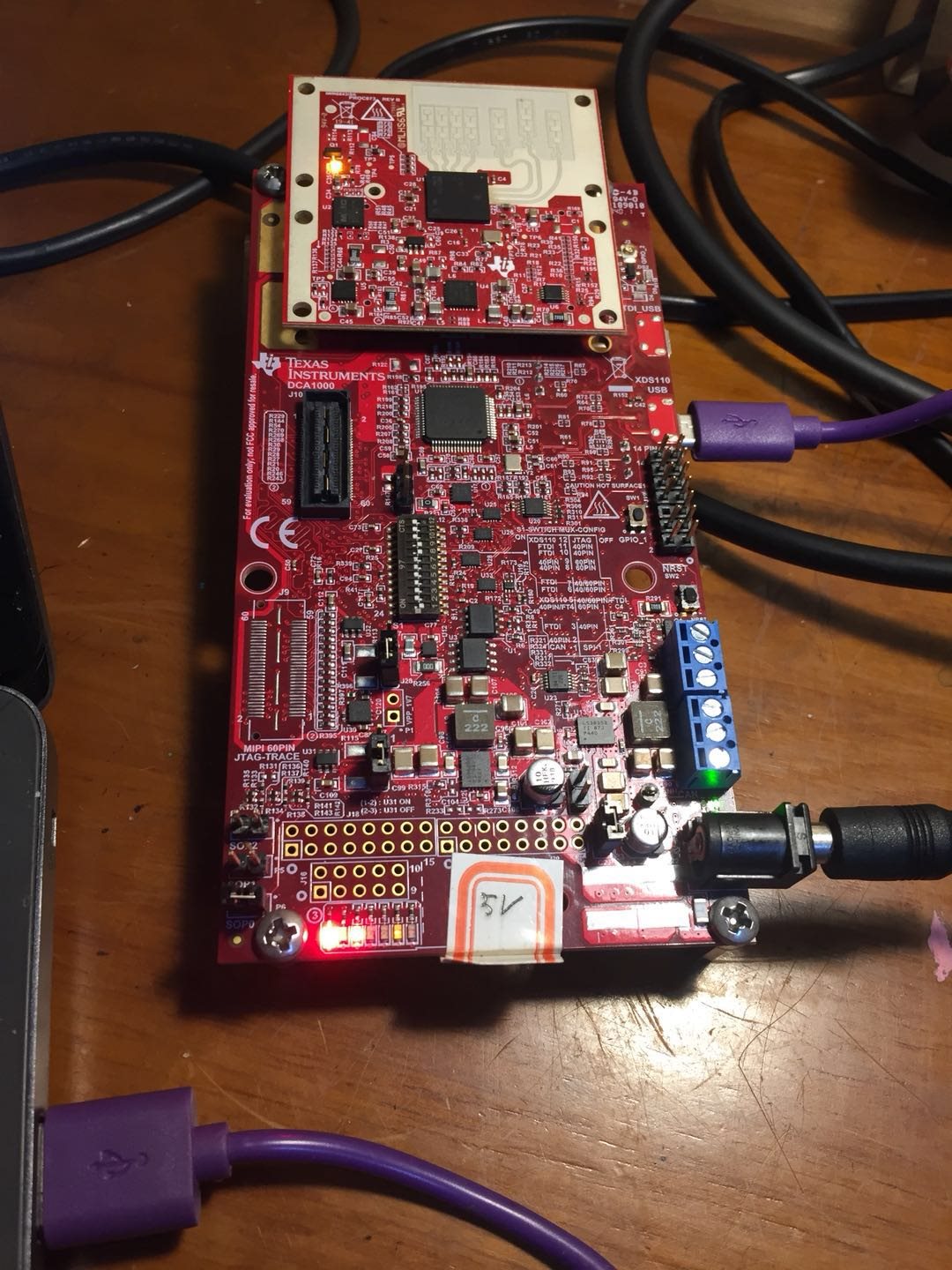

HareWare
IWR6843ISK+MMWAVEICBOOST
SOP0 is 1, SOP1,SOP2 are 0; function Mode
PC connect XDS110 by use cable

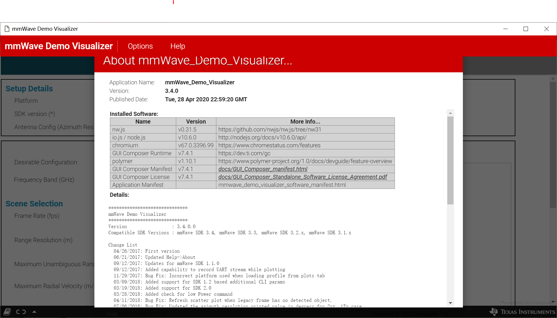

App
C:\ti\mmwave_sdk_03_03_00_03\packages\ti\demo\xwr68xx\mmw
It is compiled and burn correct

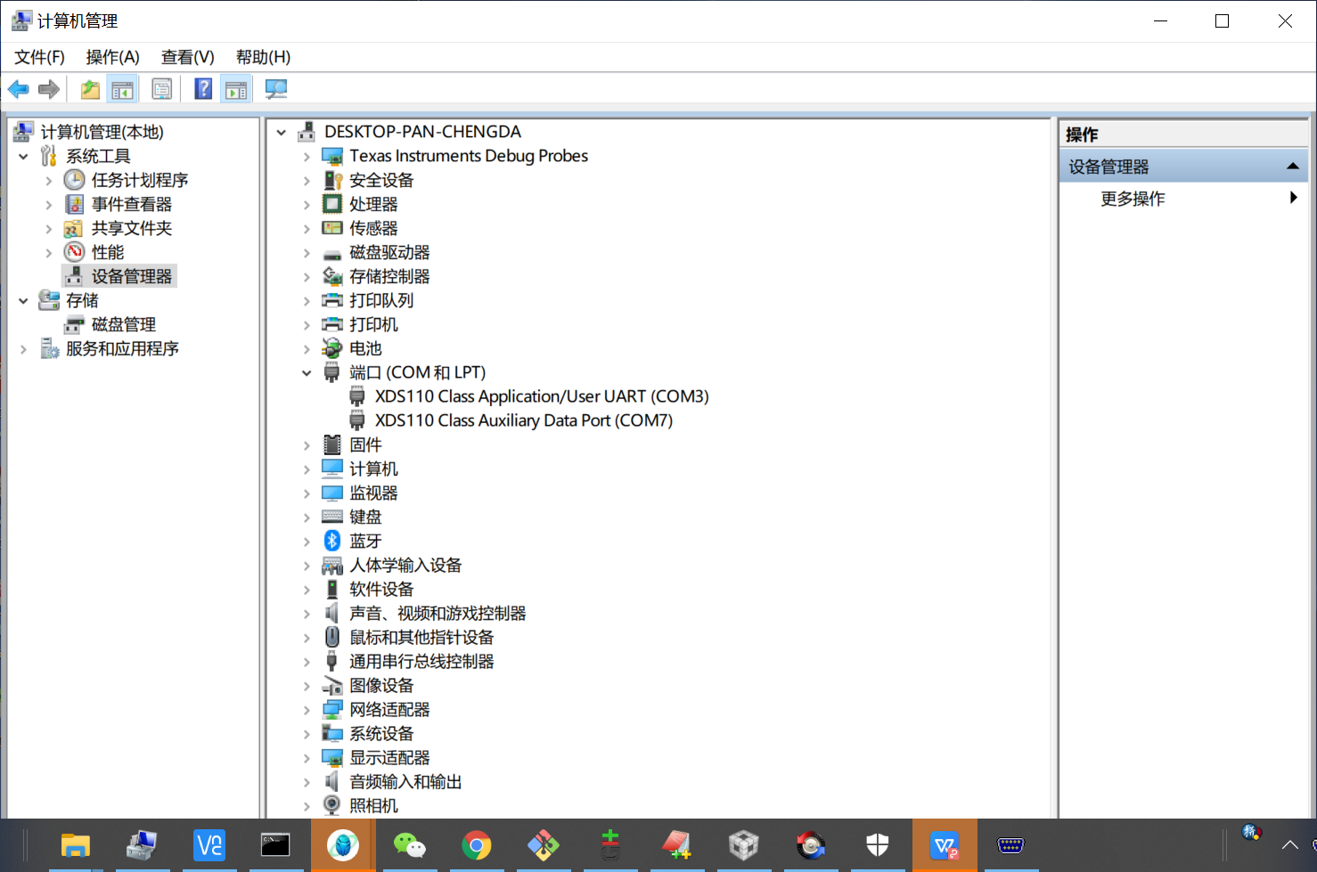

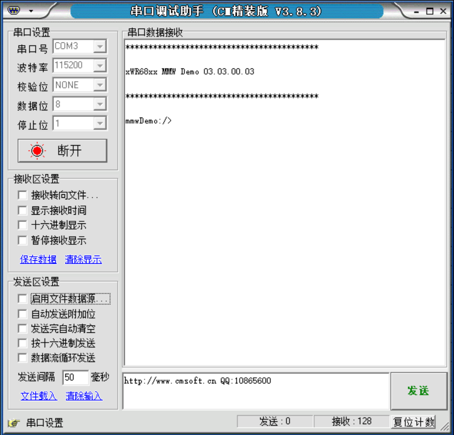

I connect the MMWAVEBOOST by COM3 and reset the IWR6843, it show it works correct.
3.

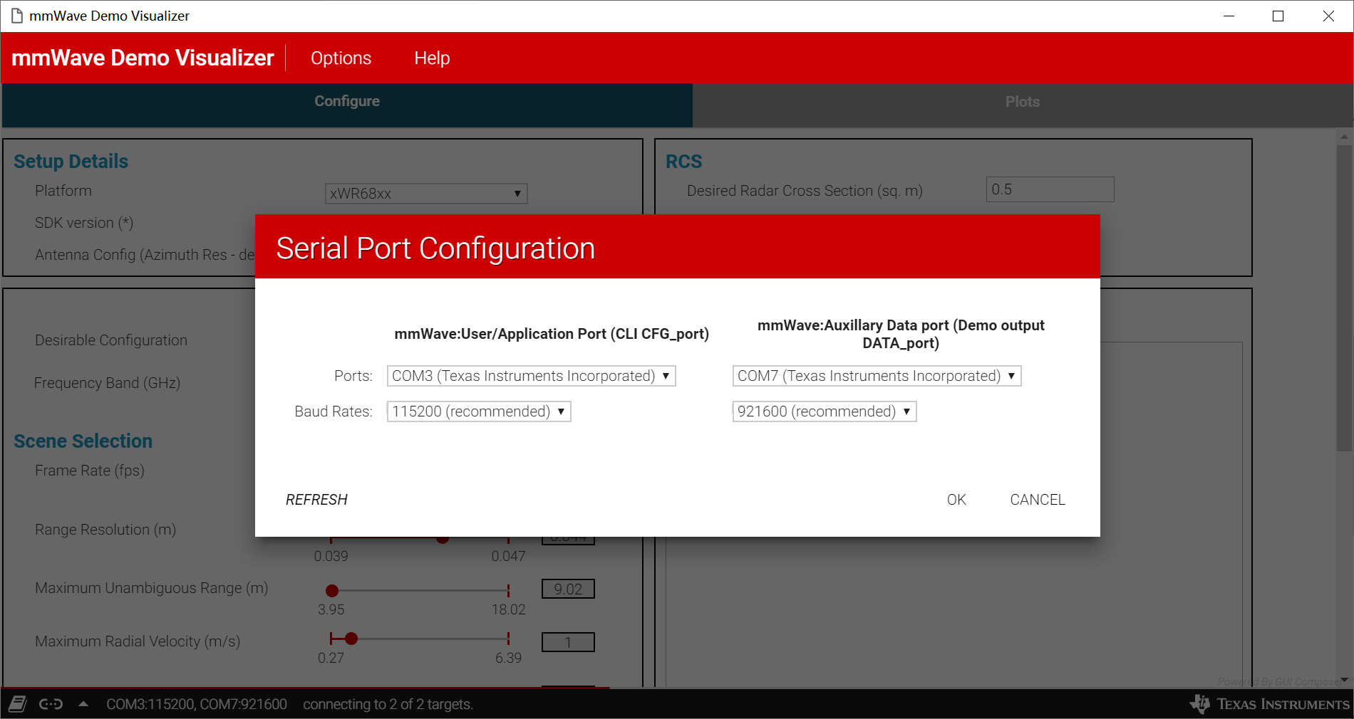

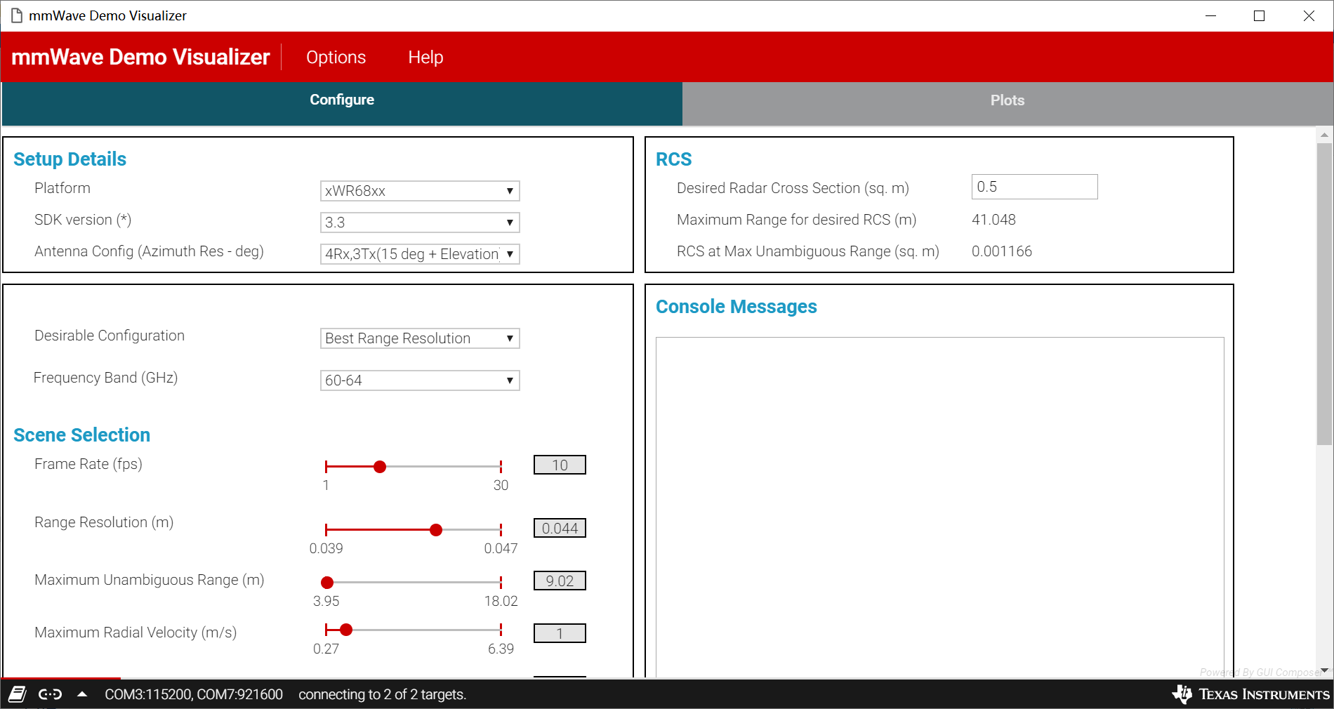

But when I use mmwave demo Visualizer tool, there is no infomation on console message Box.
3.1
I set configuration and click "SEND CONFIG TO MMWAVE DEVICE", there is no response on Console Message Box
3.2
I reset IWR6843ISK ,and there is no response on Console Message Box
3.3
Serial is set correct.
