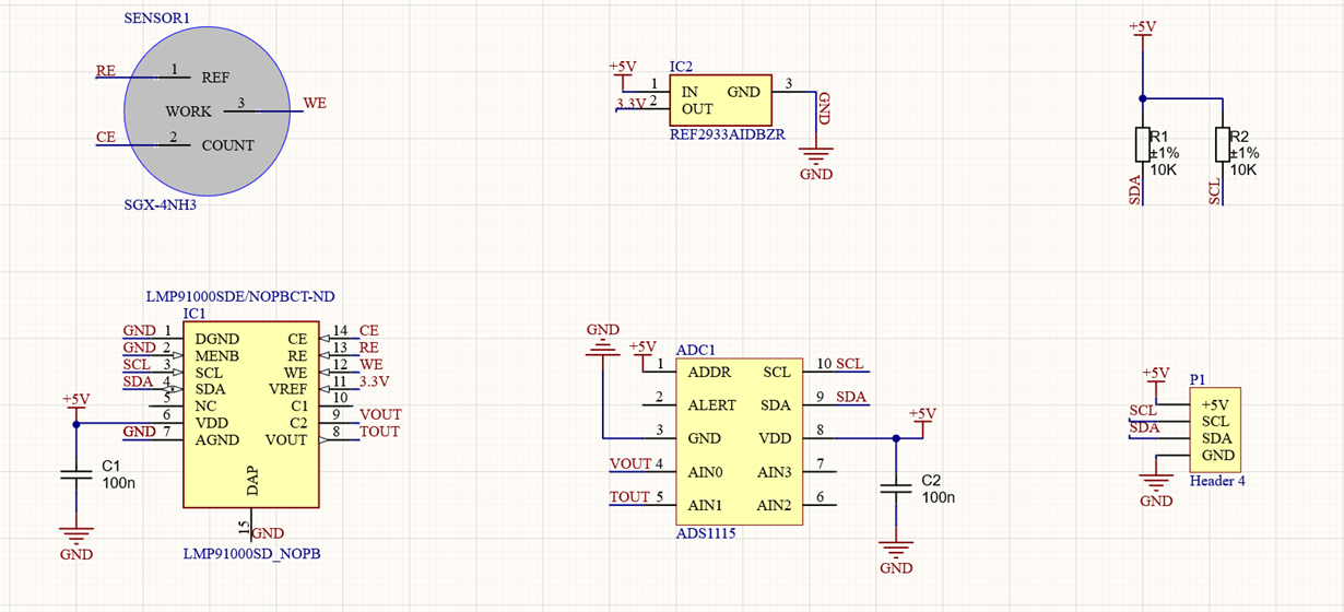

Hi everyone,
I´m suffering some problems with the use of the LMP91000 for measuring oxygen.
The problem comes due to the change in the supply since the output value changes when I change the supply.
When the circuit is supplied via USB connected through the PC , output values are around 95 microAmps. However, when it is supplied via an USB which is connected to an external battery the output values are around 108 microAmps.
Best regards.

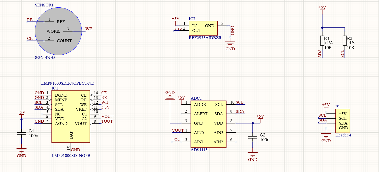

  • Dear Esteban -
    Please post or attach your schematic, which will be very useful in assisting you further with constructive feedback.
  • Dear Josh,
    I attach the schematic.
  • Esteban,
      My experience is that the USB 5V from a computer is typically an LDO and using a USB from a battery is typically a switching boost regulator running off of a single Lithium cell. This means that the switching noise from a boost circuit can effect the REF2933 output voltage due to high frequency noise.
    It's possible that you are seeing a VREF shift. Add a 0.47uf capacitor to the input of the REF2933 and a 100nF capacitor to the output of the REF2933. This should stabilize the noise that is causing the VREF shift.

  • Esteban -
    it just occurred to me that you did not connect CE and RE together - with all other three terminal O2 sensors this is what is done.
  • Hi Josh,
    Thanks for your contribution. I don't really think that is the problem since the configuration I want to use is the 3 lead mode,in which every lead is connected separately as you can see in the picture below.
    Best regards.

  • Esteban -
    Actually - that is an Ammonia sensor, not an Oxygen sensor - so you may either change sensors or set up the LMP91000 similar (and you are right there, with those sensors, you have a three terminal arrangement)
    with a similar sensor from City Tech, NH3 3E 10 SE (from the sensor database in the LMP91000 GUI), the load was set for 10 Ohms and the RTIA was set for 120k, with the Vref divider set for 20%.
  • Hello Josh,
    The sensor in the schematic is not the same we are using, we are using the S+4OXLF oxygen sensor by DD Scientific. I used the one on the eschematic due to its' footprint is the same as S+4OXLF ones. Sorry if that has confused you.
    Thank you,
    Best regards.

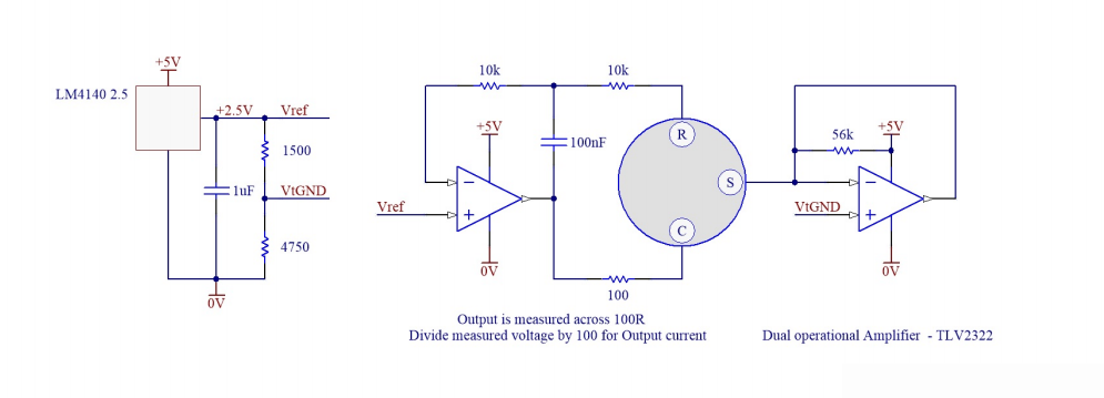

  • Hi Josh,
    I've been using the LMP91000 software trying to find the correct values for IntZero, Rload and Rtia introducing the different specifications of my sensor. Once I entered the values the software told me to short the RE and CE to properly configure it for Oxygen type sensors. So my question is if with every oxygen sensor this must be done or not, and if not in which cases this should be done. I'm also attaching the datasheet of the sensor so you can check the different parameters.
    Asier.

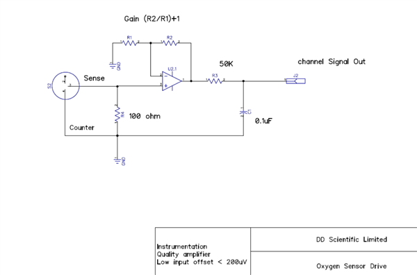

    s_4oxlf_datasheet_iss2.pdf
  • Asier,
    The manufacture of the O2 sensor that you are using recommends a 2 wire configuration. They also show an Rload of 100Ohms. On their web site under support their are a few documents on this.
  • Thanks for your reply Gordon,
    I saw that circuitry some time ago. However, that circuitry doesn't apply any bias on the sensor which in essential for the right performance of it. The company advises to use this circuitry for S+4OXLF but the functioning of it is very different since it doesent use any TIA. The output is measured through the 100R resistor in the potentiostat part of the circuit.
    Asier.
  • Asier.,
    My experience with O2 sensors are that they are operated in 2 wire mode.
    It may be a good idea to contact the manufacture of the sensor and have then guide you in the use of this sensor. They should have a good idea of how to set the variables and wire the sensor to get the results that you are looking for.
    I can only guess what this sensor really needs. Let me know if I can help with the LMP91000.

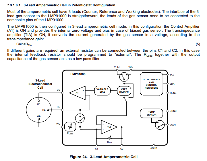

  • Hi Gordon,
    After following your advices and doing several tests it seems I have finally found the correct configuration for the LMP91000:
    Rload = 100 R
    Rtia = 2750 R
    IntZ = 1.649 (50% VREF)
    Regarding the operation mode, I kept it in the 3 lead mode.
    By the moment everything looks good and it is time to test its accuracy.
    Thank you for all your help,
    Asier.
