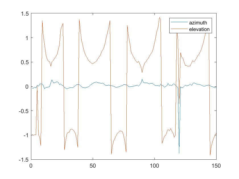

hello, I've tried to estimate the elevation and azimuth using iwr6843aop with DCA1000.
Azimuth looks fine but there seems to be some kind of angle shift in elevation.

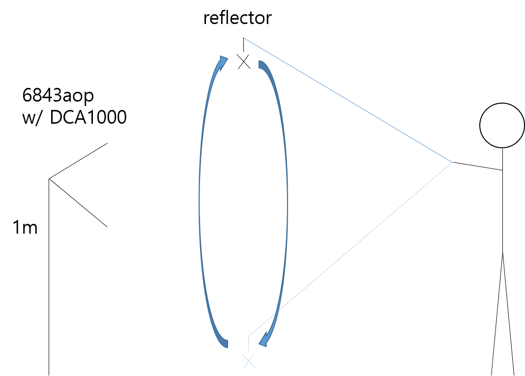

I moved a reflector upside down in front of the radar and the center of the elevation estimation should be 0 degree but it looks like it's shifted about 90 degrees.
Do you have any idea what happened?
I used TDM. The order of tx transmission was tx1-> tx3-> tx2.  Even when i used the order of tx1-> tx2-> tx3, same thing happened.
The figure shows the azimuth and elevation I estimated. The unit of the angle is radian and the x axis is the number of frame.
