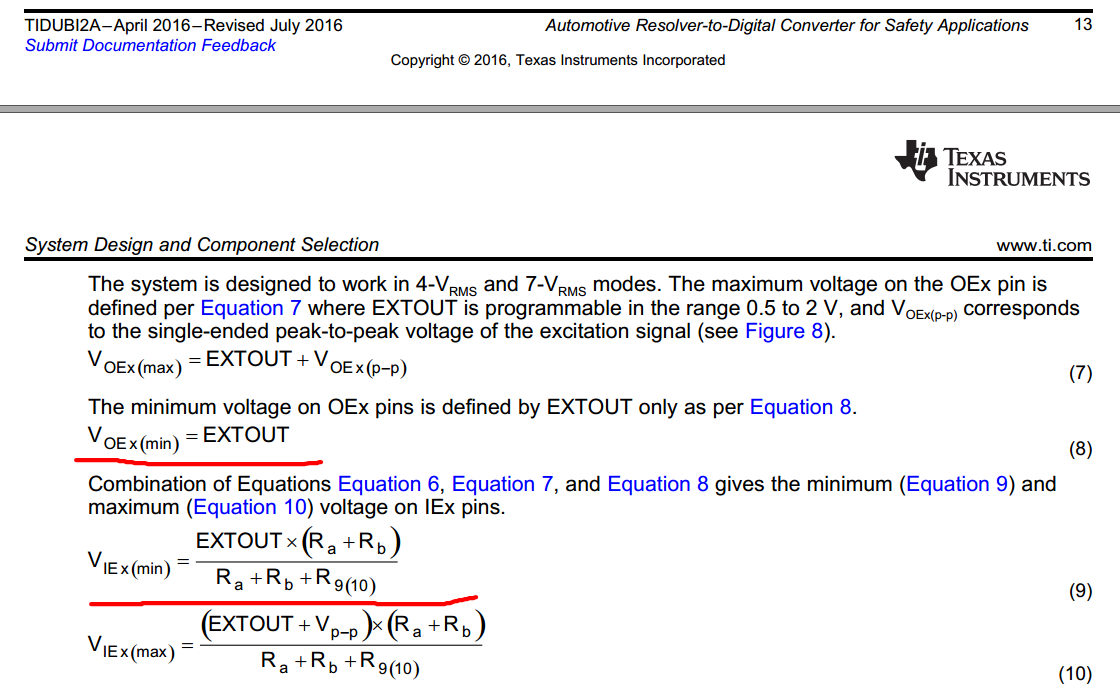

Case 1:
EXTOUT is described as the minimum OEx voltage in the application manual TIDUBI2A.

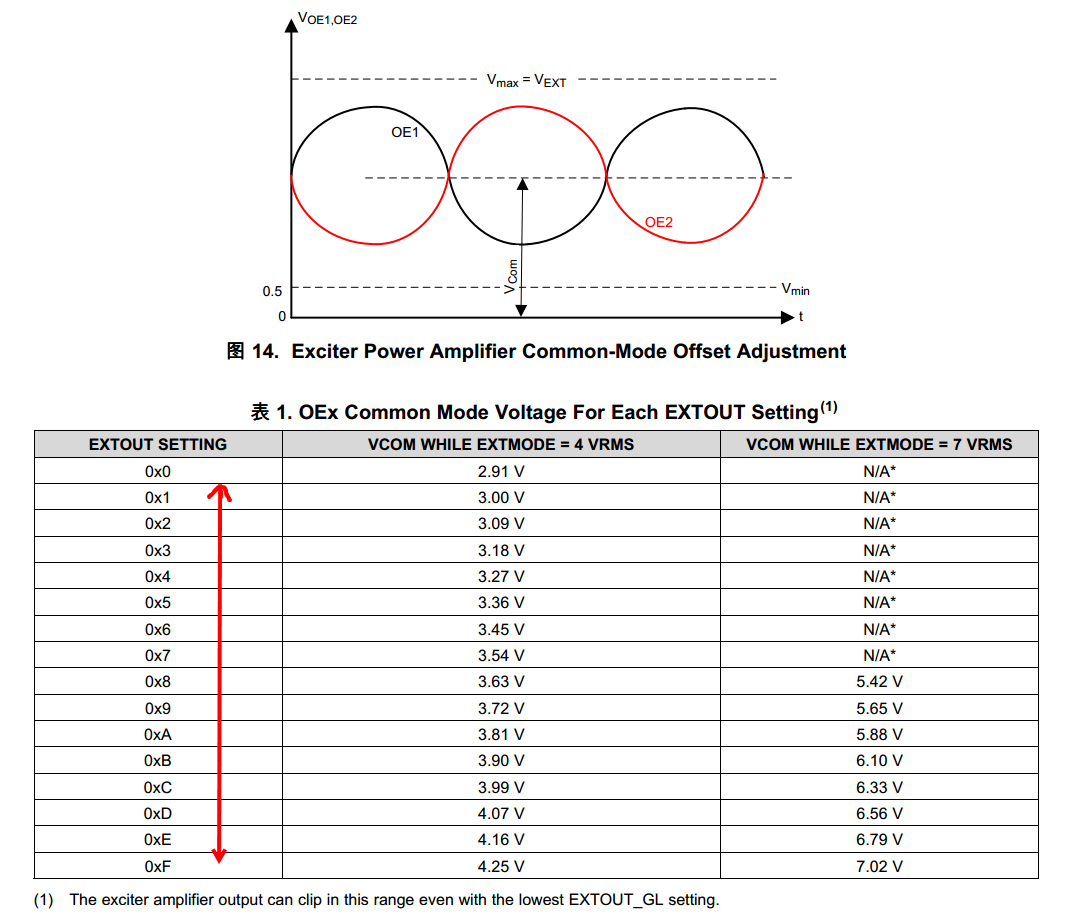

Case 2:
EXTOUT adjusts the common mode voltage of OEx as found in pg 21 of DS, and my case is consistent with this one.
I calculate the OEx(min) by formula " OEx(min) = 4.25 - Vexco/4 " instead of  " OEx(min) = EXTOUT ". And my calculations are consistent with the oscilloscope tests described in my reply later.

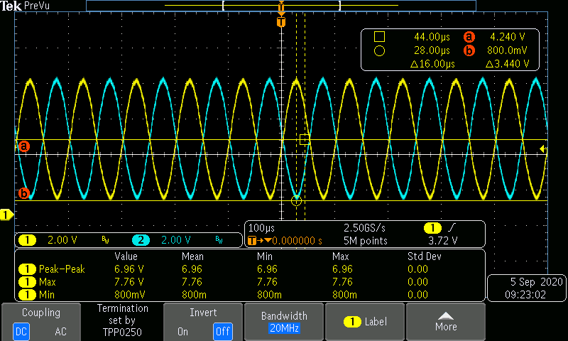

  • The waveforms of OE1 and OE2 . EXTMODE = 4VRMS , EXTOUT_GL = 0xF , EXTOUT = 0x0
    Theoretical OExmax and OExmin were calculated using differential voltage (13.85V) and common mode voltage (4.25V).And the calculated results are consistent with the oscilloscope test results.
    OExmax = 4.25 + 13.85/4 = 7.7125V
    OExmin = 4.25 – 13.85/4 = 0.7875V

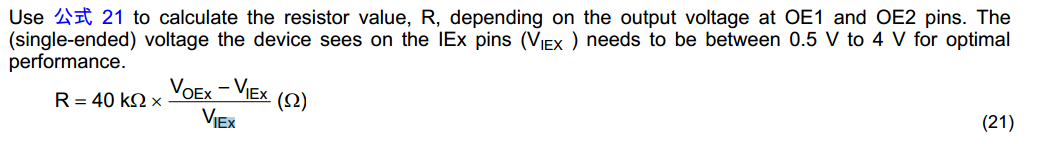

    The appropriate resistance value will then be calculated using formula 21.
    To make IEx greater than 0.5V,  Rmax = 40 * (0.7875 - 0.5) / 0.5 = 23KΩ
    To make IEx smaller than 4V ,  Rmin = 40 * (7.7125 - 4) / 4 = 37.125KΩ
    Because of “Rmax < Rmin”, there is no suitable R for IEx to meet the range of 0.5V-4V
