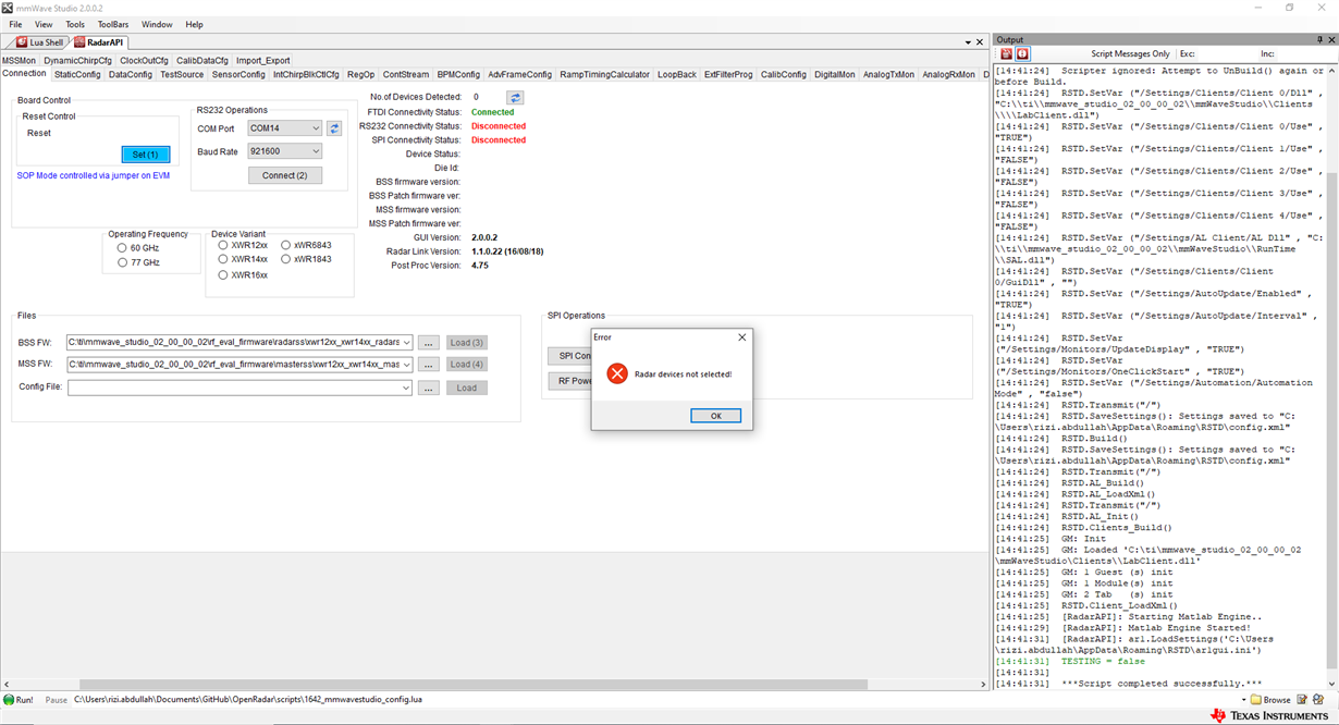

             I have AWR 1243 boost board with a DCA 1000 which were working well till yesteday. Today I tried to boot the boards but they some how dont seem to work
Observations:
* DCA 1000 5V_LED has flickering green LED glowing but at start up the red LEDs on the top right are not glowing at all (LEDs for example SD_detect and so on )
* AWR BOOST board 5v Red led is glowing all the time (I assume the boost board is fine)
*In radar studio  FDTI connectivity status is connected but the radar is not getting reconginsed
*error radar not found.

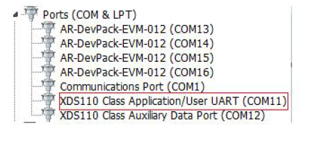

    Did you check the COM ports in the device manager? Are they all recognized as depicted in the Snapshot below (Ignore the highlighted part). In total, there should be 4 AR-DevPack Ports and 2 XDS110.
    In addition to this, could you also check if the power supplies (5V) to both the boards is proper and the connections are tight.

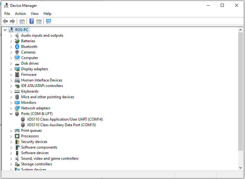

  •  Hello Ishita,
                 I did check for the ports just to be sure. Also it was working till yesterday so I remember clearly I did install the drivers. Also I have attached the snap of my device manager for reference.
    looks like a hardware issue to me. Looking forward to further insights from you.
    Mohan Sunderam
  • Hello Mohan,
    I don't see the 4 new COM ports (AR-DevPack ones) in your attached screenshot, which is why you're not able to connect to the device. Can you update the FTDI drivers and try once again?
    For doing this, please refer to section 2.3 in mmWave_studio_user_guide.pdf.

             I figured just now that the COM ports of the DCA 1000 ports are not being recongnised at all (in the device manager). When I disconnect the BOOST board the 2 COMports also disconnect in the device manager. But when I connect or disconnect the DCA 1000 radar_fdti cable there are no COM ports that appear. Also as stated before the 5V_LED (green LED) on the DCA1000 board is not stable and flickering all the time when its connected. Thats why I assumed its an issue with board.
    Also I tried to unistall all the drivers and reinstall all the required FDTI drivers and restarted my computer, but still I see two ports of the Boost board and not of the DCA board.
