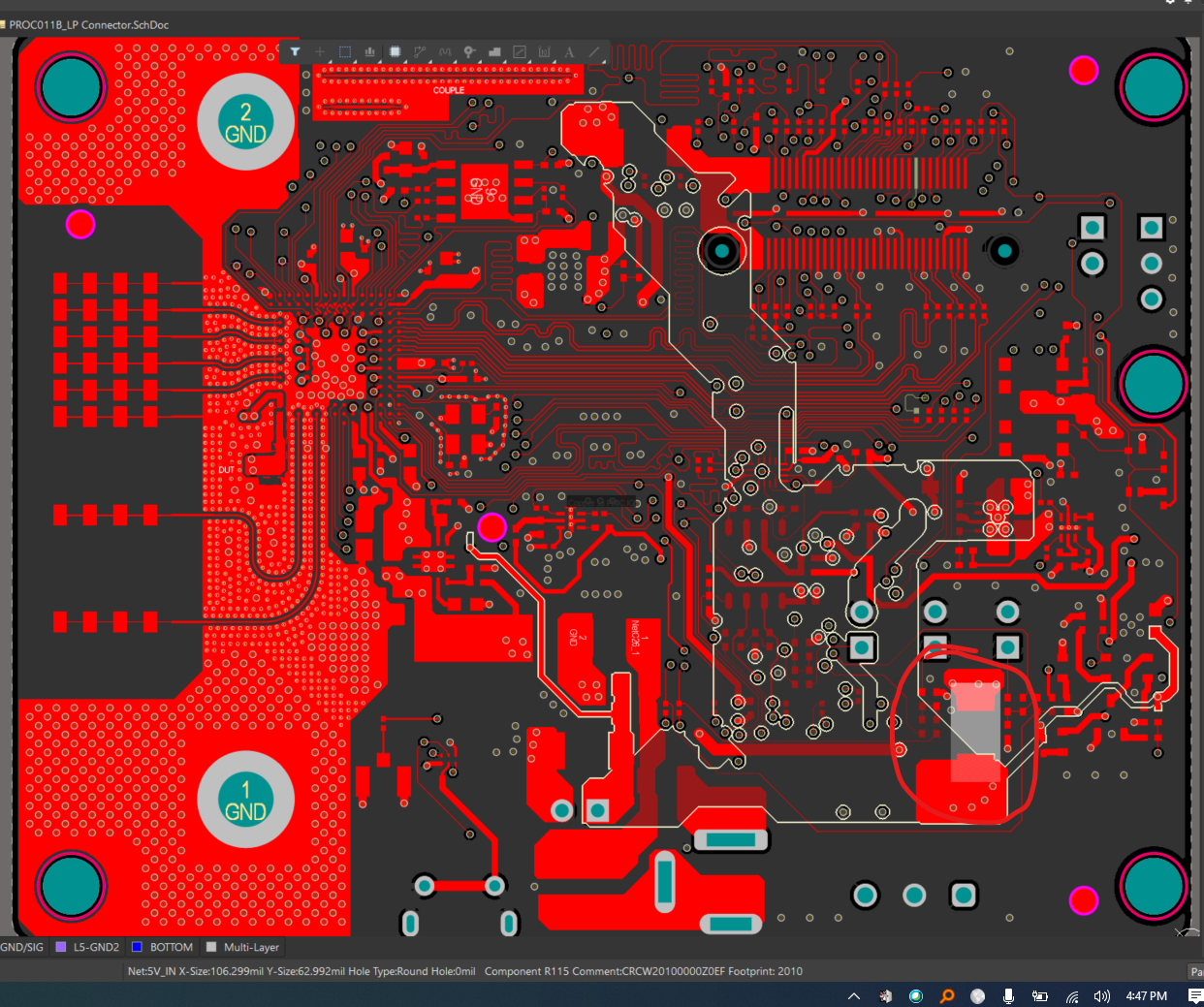

Hello folks,
I have just designed a Shield for the IWR1642BOOST Rev B using J5 and J6.  The Shield is supposed to use the MCU_5V J6 Pin 2.
But as far as I know J6 Pin 2 is not connected to any Source as long as R115 (0 R) is not placed. So I have to find the Position of the R115. But I cant find it in the Assembly Files.
Can anyone help?
