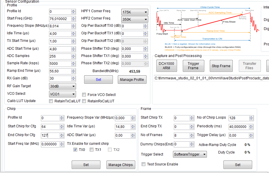

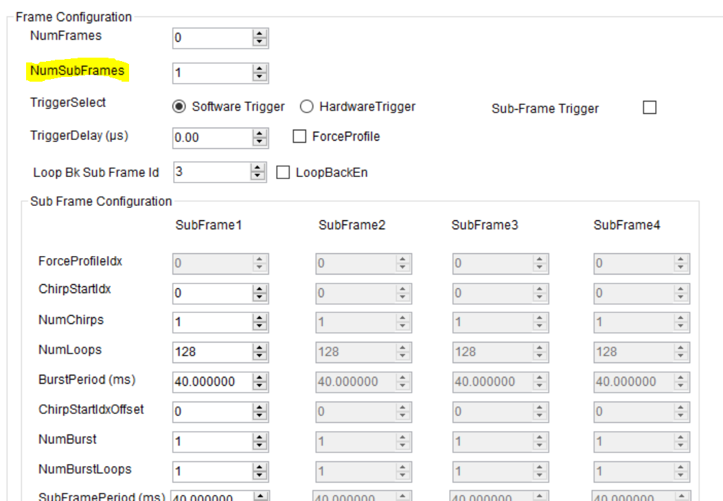

  • Hello Nilo,
    Please follow the below steps for Configuring Advance Frames :
    1. Do all the operations normally until Chirp Config in the "SensorConfig" Tab (Including "Profile Config")
    2. Now instead of configuring "Frames" in the SensorConfig Tab, move to "AdvFrameConfig" Tab.
    Now here, Subframe 2,3 and 4 are disabled currently, but will get enabled based on the NumSubFrames you select.
    In the respective subframes, you can choose the profile ID and chirp start index based on your configuration in the "SensorConfig" tab. The rest of the options have their usual meanings as explained in the DFP_user_guide.

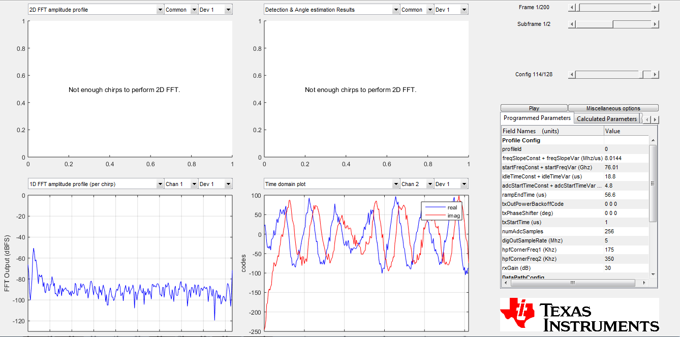

    I tried implementing it manually. The second sub frame is working i think, but in the post processing for the first one ,srr, it says that :
    Not enough chrip to perform 2D FFT
    I choose 128 chrips and one loop, what am i missing?

  • Nilo,
    For that you would need chirp loops > 1.
    Alternatively, you could also keep the num_chirps as 64 and chirp loops as 2 if they're similar.

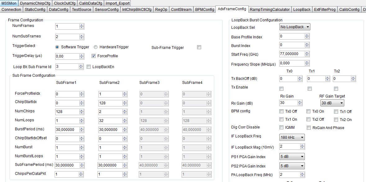

  • Hello Nilo,
    I get your chirp config, but it would to very helpful if you could send a screenshot of your AdvFrameConfig Tab. That would save me some major time in mapping your API config to each parameter in Advance Frames.
    Ishita

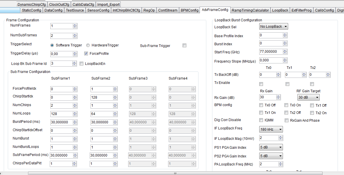

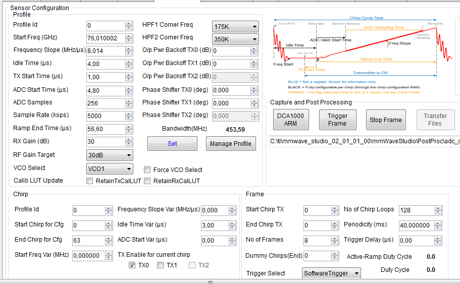

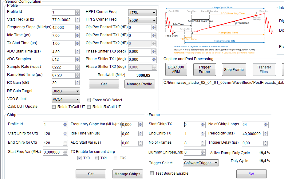

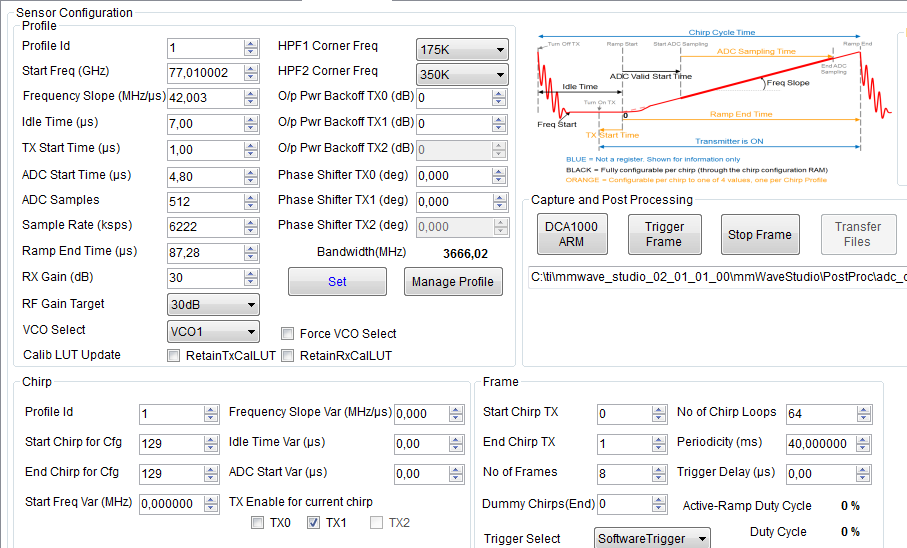

  • Dear Ishita,
    Of course, thank you for checking it.

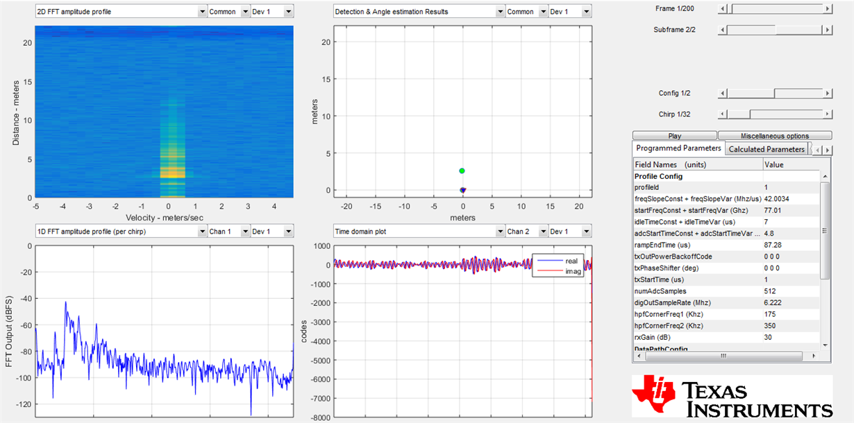

    !.SRR
    2.USRR
    3. Advanced frame
    4.Results
    Thank you and kind regards,
    Nilo

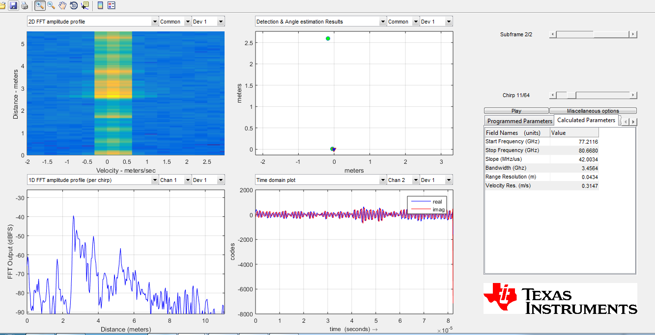

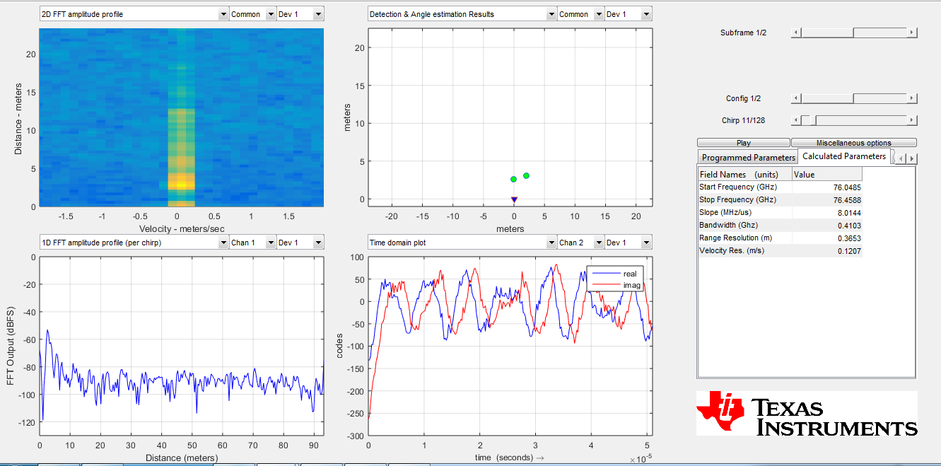

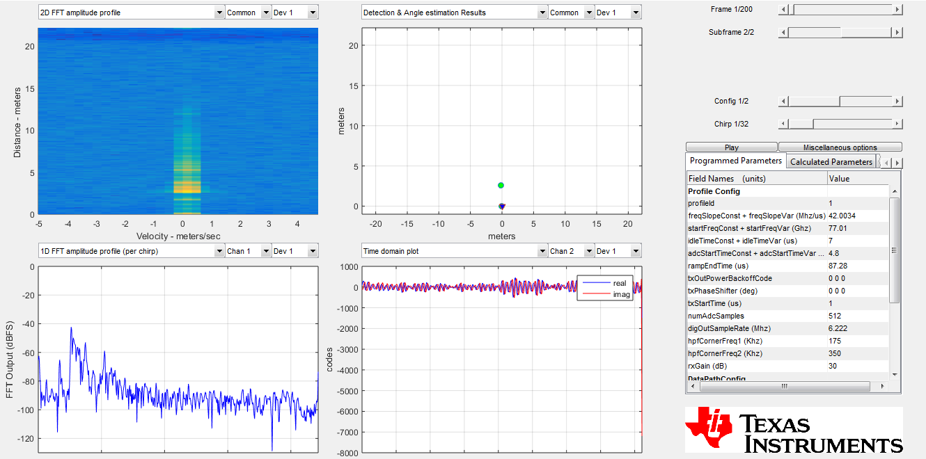

  • Hi Ishita,
    I think it's possibly the adv frame part. I changed it :
    And here is the result:
    Does this look right?
    Kind regards,
    Nilo
  • Hello Nilo,
    Glad you were able to make it work!
    You could cross check your results with the Demo as well and make sure they're correct.
    Ishita
