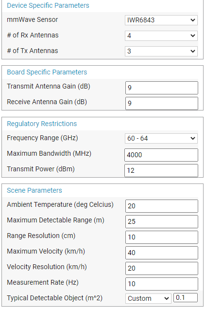

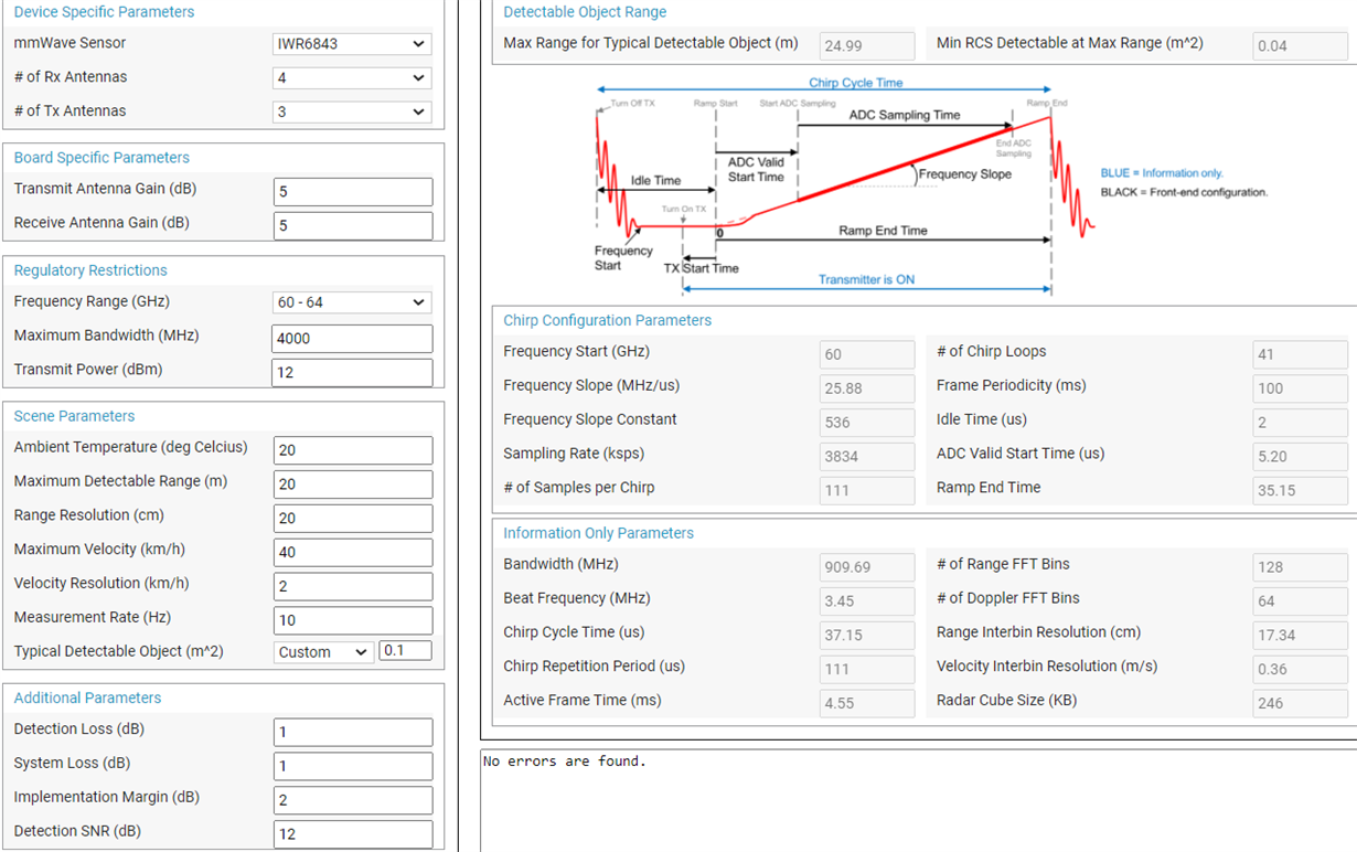

  • Please see config screenshots below:
    8cm resolution:
    20cm resolution:
    It does look like the 'Active frame time' increases slightly with the 20cm config.
    How should this tradeoff be approached in terms of larger resolution improving chirp characteristics? I.e., should the resolution be set as high as possible as long as it's less than or equal to the smallest dimension of the RCS?
  • Ryan,
      Higher active frame time will to improve over all SNR which translates to improving the distance for the same  detection threshold.  Yes, that’s a better trade off, i.e.  resolution should be set as high as possible.
