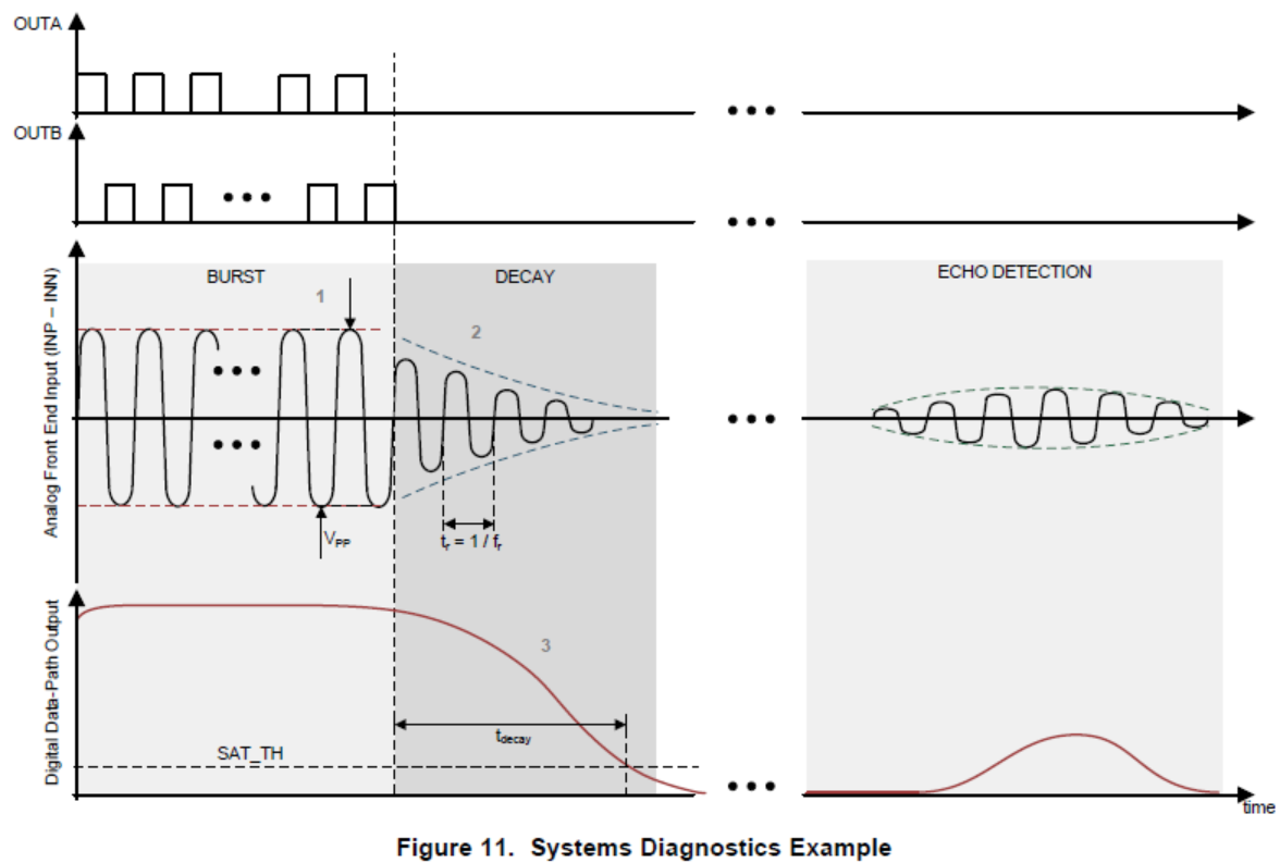

To detect if the transducer has become disconnected or to check other abnormalities, use the built-in system diagnostic feature.
The system diagnostics include:

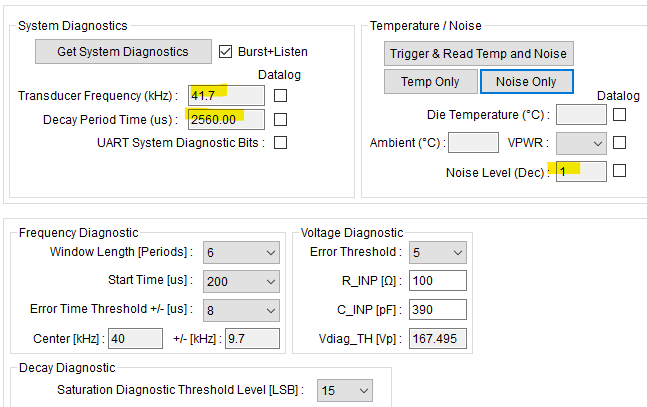

For example, highlighted are the system diagnostic results and settings of a working solution when using a 40kHz transducer in transformer driver mode:

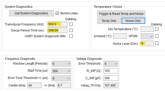

In the case of the same settings where the transducer is disconnect, the highlighted results are:
Notice, in this failing/floating mode, the frequency diagnostic shows a much higher value, the decay time is much shorter, and the noise level increases.
You can use the system diagnostic frequency thresholds to quickly check all diagnostics in the diagnostic field byte when UART_DIAG=1.

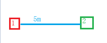

But when there is no object in front of transducer,will this diagnostic result be accurate?
user6060721,
Situtation 2 offers a better result because the ultrasound energy only needs to travel one-way, rather than make a round-trip (double distance in situation 1). The ultrasound energy will be less attenuated in Situation 2. To achieve Situation 2, you must either:
