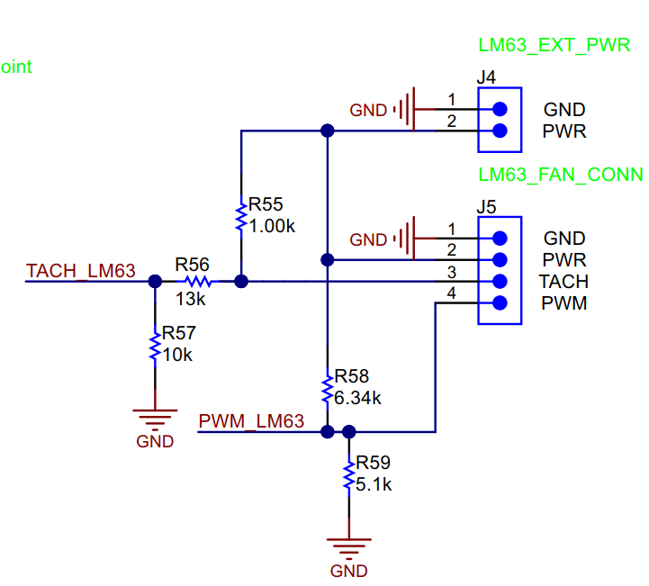

3. what's the purpose and design rules for R55, R56, R57 in the EVM circuit?

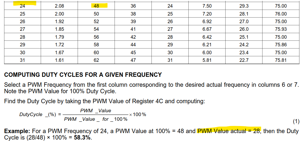

4. how does "PWM value actual=28" in the example came from?

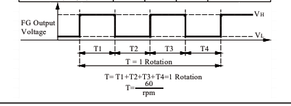

5. RPM
A. from the FAN spec, 2 pulses equal to 1 revolution. Does that corresponding our datasheet formula (2) "f"=1?
B. if Fan spec and our chip definition is different, how to convert the formula?
customer FAN spec:
    This is a resistor totem pole to step down the voltage that powers the fan to stay within out Abs max voltage range.
    The number 28 is just an arbitrary number to give an example.  24 is an arbitrary number chosen for the PWM frequency and 28 is an arbitrary number chosen for the PWM duty cycle.

    5. RPM
    Yes, 2 pulse fan is 2 pulse per revolution which is f=1.

    I have a question about register settings. Before using the fan control IC in the data sheet, four registers must be set. Please give four register recommendations based on fan specifications.
    • FAN operationg frequency: 25KHz
    Q1: Is the value of register 4A set to 0x20?
    Q2:The product will use three target duty cycles (60%, 70%, 80%). But I don’t know the setting rules in register 4B? Please give formula.
    Q3: Is the value of register 4D set to 0x7?
    Q4: The product will use three target duty cycles (60%, 70%, 80%). But I don’t know the setting rules in register 4C? Please give formula.
    This depends on how you would like to run the fan.  Based on 25kHz and if you want to use manual control and PWM output pin be 0 V for fan off.  0x20 is correct setting.
    This registered is for spin up settings and is dependent on how you would like to start your fan from a full stop.
    Register 0x4D = 0x07 would be 25.71kHz when set to 360kHz as shown in the 6th column of the table in the application notes section of the datasheet.
    Please use equation 1 in the application notes section of the datasheet.  Register 0x4C =
    0x08 (~57.14 %)
    0x0A (~71.42 %)
    0x0B (~78.57 %)
