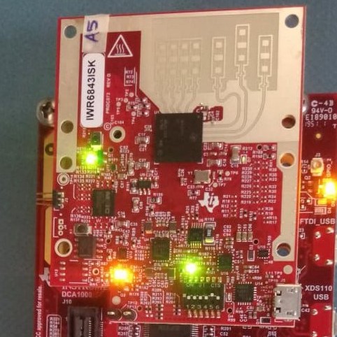

    Please find the following images of setup showing the P3 header which we are mentioning.
    We are uding IWR6843ISK antenna with MMWAVEICBOOST.
    Please find below image of entire setup.

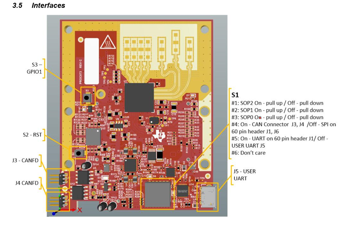

    For stand alone and working with carrier board switch positions are different. Please refer to EVM user guide for the S1 switch position.
    On the carrier board please ensure to remove J13 jumper on the carrier board.  J13 Jumper must be removed without removing the J13 jumpers flashing will have problems. The user manual shows that the default state for J13 is open. We have noticed on the some of the EVM shipped from the factory had pre-installed these jumpers. This need to be removed for flashing purpose.
    Is there a reason that new EVM need to be connected with the carrier board? You could operate the new below EVM without the carrier board with appropriate switch settings.
    In the stand alone configuration you need to configure switch settings for SOP lines, and UART port connectivity to USB UART on J5 USB connector.
    Please refer to EVM user guide for more informaton.

    These are the images showing p3 header ,which you can not see in my previous message.

  • Shraddha,
        Thank you for the picture. P3 jumper must be installed.
    EVM user guide link is shown below.
    https://www.ti.com/lit/ug/swru546c/swru546c.pdf Refer to chapter 3
    For standalone mode of operation, you need change the switch setting (S1) on the module board and use appropriate SOP setting depending upon flashing mode or default functional modes and you need to apply reset push button.
