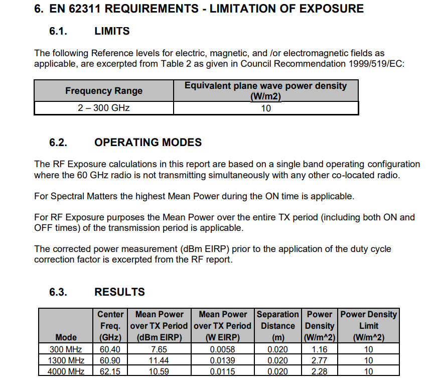

    As described earlier, I wonder, if the beam of a IWR6843ISK-ODS (Rev. A) antenna board may exceed radiation power levels that may be hazardous to human tissue,  if a lens is used to collimate the beam. Specifically, the antenna board is planned to be used with the vital signs lab of the industrial toolbox, that utilizes only one TX-RX-pair, and the beam is planned to be directed at human tissue (e.g. a human face) at 45cm distance from the sender. I tried to estimate the compliance  of the setup with the threshold values given in (IEEE Std C95.1TM-2019 and IEEE Std C95.1TM-2005) but for estimating the maximum incoming energy I would need more clarification:
    1.) Where can I find the angular emmission characteristics of one TX-Antenna of the  IWR6843-ODS (Rev. A) Board? (The "mmWaveICBoost and Antenna Module"-user guide provides an angular anntenna radiation pattern for the IWR6843-ODS on pp. 67-68, but in my understanding this is the combination of TX-emmission and RX-senstivity. Is this correct?)
    2.) From Section 5.7 in the iwr6843 documenation (Document: SWRS219C –OCTOBER 2018–REVISED MAY 2020) the typical output power per one antenna is 12dbm which translates to 16mW. Is this the signal power used for one chirp?
    3.) I would estimate the antenna surface of roughly 1 x 1 mm^2. So I would estimate the power density directly at the antenna as 16mW/mm^2. Could you confirm this?
    4.) The vital signs demo specifies the signal as follows: chirp length 50µs, frame length 50ms, 2 chirps per frame. Is the tx-antenna only emmitting during one chirp or is there a continuous base signal emitted. This information would be crucial for me for estimating the signal energy in a time frame of 100ms (as this measure is crucial for radiation thresholds defined for pulsed RF signals in IEEE C95.1-2019).
    5.) Can you further recommend basic equipment for measuring the microwave radiation energy at certain distances in the spectral range from 60-64 Ghz?
    Thank you in advance,
    Alexander

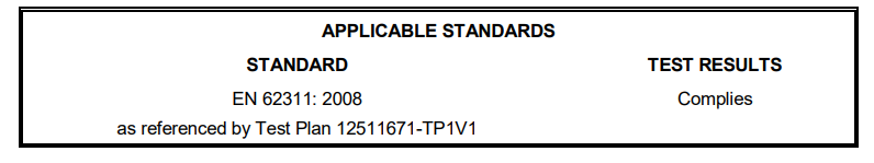

  • Alexander,
    You could refer to below standard applicable to limitation of Exposure compliance certification. With the lens we need to ensure we are not increasing the antenna gain such that we don’t violate the 10W/m^2 power density limits.
    All the report and Test plan we have captured in our TI resource explorer.
    https://dev.ti.com/tirex/explore/node?node=ANZCxyzbUGQoIA1DUZnmcQ__VLyFKFf__LATEST
