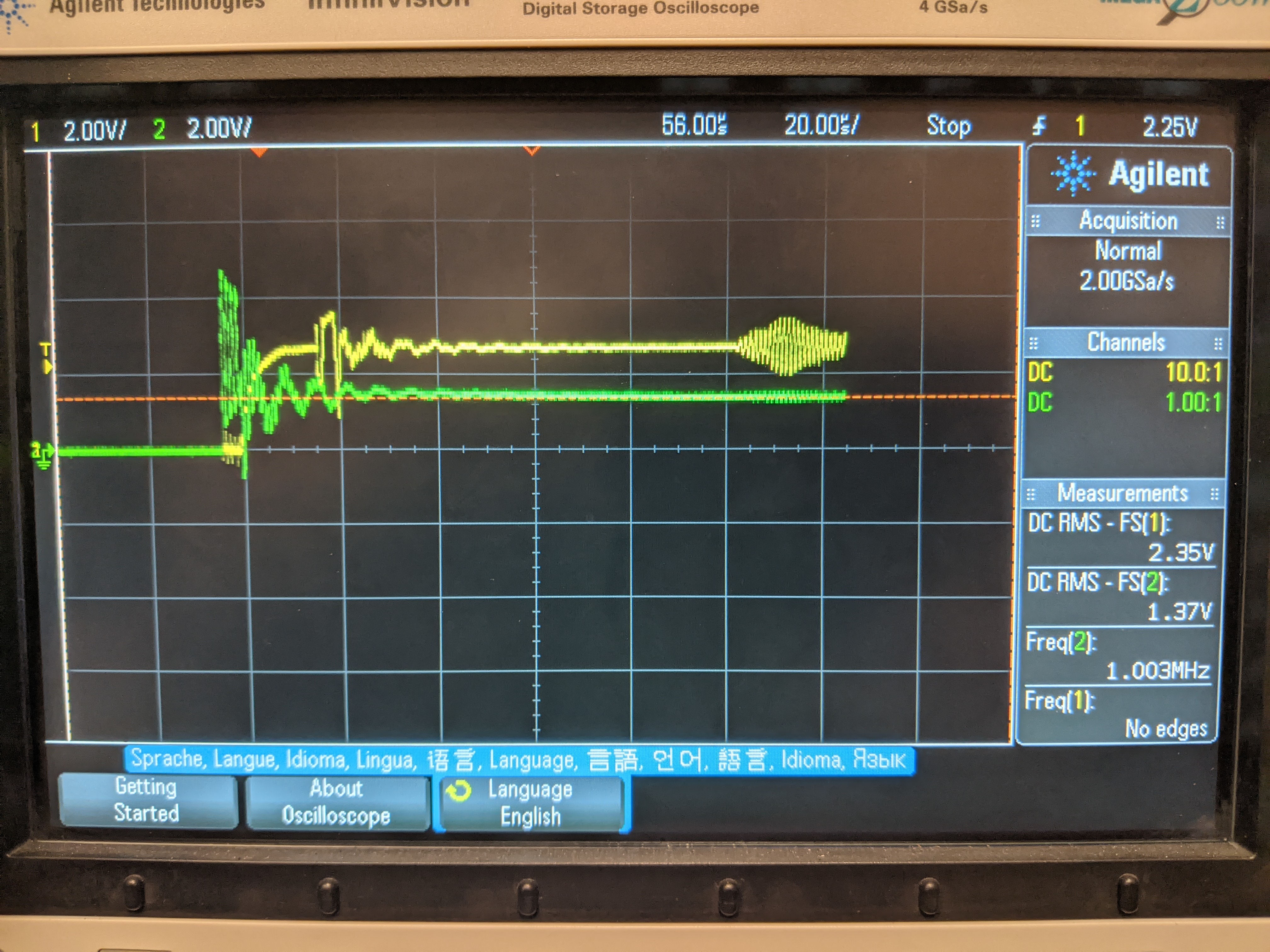

I'm trying to use the TDC1000 in a fluid (liquid) identification scenario. I'm still in the early stages of development where I'm trying to make sure I'm configuring and controlling the TDC1000 properly and checking for transducer signals on my oscilloscope. The transducer I'm using is the one recommended by TI for liquid applications (www.steminc.com/.../piezoceramic-disc-10x2mm-r-215-khz-wireleads-smd10t2r111wl). I'm controlling the TDC1000 with a PIC16F18446 operating at 16MHz and outputting a clock signal to the TDC1000 at 8MHz.
So the problem I'm having is that the time between the TRIGGER signal generated by the PIC and the START pulse generated by the TDC1000 is almost one order of magnitude higher than what the datasheet says. See the photo below.
All the registers are configured in their default state, except the Config_0 register which is set as 0x44. I only changed that one as a first step to make sure I can properly configure the TDC1000 through the PIC.
Can anyone help with why that could be happening?
It might not sound like a big deal but I'm also not getting an echo signal back, so I'm wondering if these problems are related in any way. I'm trying to tackle one issue at a time. :)

  • Hi Theodore,
    The time between the TRIGGER pulse and START pulse is determined as described in the datasheet:
    "During resynchronization, the trigger and START edges are aligned to the negative edge of the external clock. The time between trigger and START is equal to 3 T0 periods plus 2 or 3 T1 periods, depending on the phase between the received trigger pulse and the external clock. For example, if ƒCLKIN = 8 MHz and TX_FREQ_DIV = 0h2 (divide-by-8), the period T0 is 125 ns and the period T1 is 1 μs, resulting in a time of 2.375 μs or 3.375 μs between the received trigger signal and the generated START pulse."

    1) Regarding the time between TRIGGER and START pulses, I actually tried to reproduce the exact case described in the datasheet (referenced in your reply). So my fCLKIN = 8MHz as I said earlier, which means that I should expect to see 2.375 μs or 3.375 μs. However, based on that oscilloscope photo it's around 28μs which is a significant difference.
    2)You're right, I should have provided you with the fCLKIN plot as well. Please find it at the end of my reply.

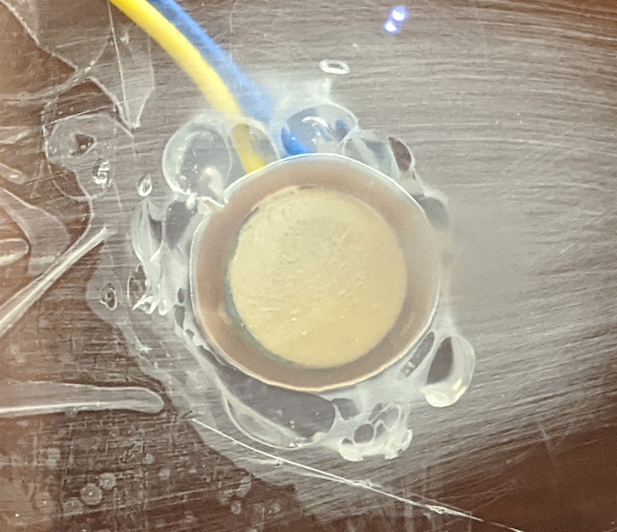

    5) My container is made of 1/4 inch thick polycarbonate walls and has a square cross-section. The inner distance from wall to wall is 3 inches, so the total thickness of the container is 3.5 inches. (1/4" + 3" + 1/4").
    The transducer was mounted as described in the document referenced above. Please find a picture below. The liquid for now is water. I want to prove the method works with my test setup and then I'll move on to different fluids. Let's not worry about the end application at the moment. I don't want to overload this post with too much information.

  • Hi Theodore,
    Let's see if the SMD15T21R111WL transducer part number makes a difference in performance.
    In general, mounting a transducer to the exterior wall of a container tends to create the most difficult coupling situation, especially when the wall is thick. The problem relates to acoustic impedance mismatch. If the mismatch between the wall and the liquid is significant, the majority of the ultrasonic energy will either only penetrate through the wall one way, or resonate within the thickness of the wall itself.
    Be sure that there is liquid in the container, otherwise, the mismatch between the enclosure material and air will likely result in an invalid measurement. Considering communication between your PIC MCU and the TDC1000 device is working, your debug will primarily concern the mechanics of mounting the transducer. As noted in the SNAA266 app report, the best option is to create a transducer receptacle such that the transducer face is directly exposed to the liquid, which removes the acoustic impedance mismatch problem created by the enclosure's wall material and thickness.
    Unfortunately, the TI team still does not have much experience optimizing the mounting of a transducer to the exterior of an enclosure. You may need to seek guidance from the transducer manufacturer for additional mounting/debug tips.

  • Hi Theodore,
    Returning back to the original question about the TRIGGER to START pulse delay:
    This is an interesting phenomena. You are correct that your delay time should be ~3us and not ~30us.The only variable I am aware of that affects the TRIGGER signal to START pulse delay with this much significance is the CLOCK_IN frequency. (which you have already verified).
    A few debug experiments to try:
    • Use the "Short TOF Measurement" mode instead of the "Standard TOF Measurement" to see if the TRIGGER to START delay changes.
    • Increase the pulse width of the TRIGGER signal to a larger value, like 10us.
    • Change the TRIG_EDGE_POLARITY to the falling edge.

  • Hi Akeem,
    I finally got the chance to go back to troubleshooting my ultrasound setup and I have some good news to report.
    I started by increasing the TRIGGER pulse width to 10 us and then switched to the falling edge TRIG_EDGE_POLARITY, but neither of the two worked.
    It turns out that using the default register settings made the device operate in "Short TOF Measurement" mode, so I had to switch to the "Standard TOF Measurement" instead. And that's what did the trick! I maintained the falling edge TRIG_EDGE_POLARITY and 10 us TRIGGER pulse and now my delay is between 3 and 4 us.

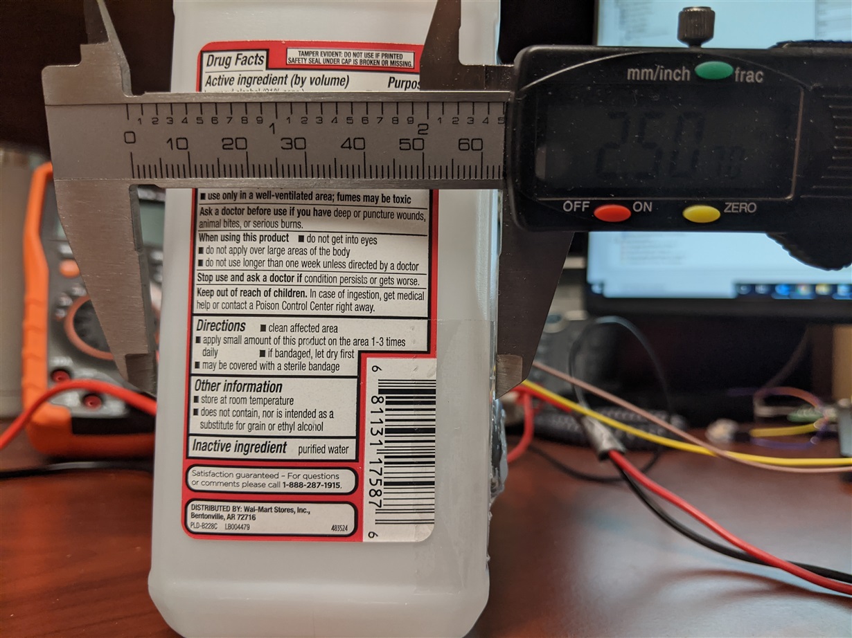

    I also got the chance to try the new sensor (SMD15T21R111WL) and had some promising results. I actually now get an echo response back and based on some back-of-the-envelope calculations it seems accurate. I mounted the sensor on the outside of a commercially available isopropyl alcohol HDPE container that has very thin walls.
    I'm attaching two photos below describing two different situations:
    1) Photo 1a shows the sensor mounted on the side of the container sitting upright and the approximate outer dimension of the container in inches. Photo 1b is the response I get on the oscilloscope. The bottle is almost full of IPA so in this position the TOF is expected to correspond to approximately the outer dimension of the container. Based on the speed of sound in IPA, and the size of the container this echo response looks right to me.
    2) Photo 2a shows the container in a horizontal position where you can see the level of IPA is now the boundary between IPA and Air that my echo came from. So in this case my echo should come a little earlier than case (1), which is what is actually shown on the oscilloscope in photo 2b.
    Overall this seems to be working fine for the time being with the SMD15T21R111WL. I appreciate your help Akeem!
