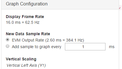

The Test Board is operated with Sensing Solutions EVM GUI v1.9.1 . The evaluation is done in single channel mode, and they have set the measurement settings so that the sample time is > 0.625ms. If they now set the sample rate in the window "Data Streaming" the EVM Output Rate will show about 2.57ms =389 Hz. Can this sample rate be set to lower values?

You cannot change the GUI to a faster sample rate than the EVM ouptut rate. If you change the text box to be faster than the output rate, the graph will either just add values as fast as is can (the same rate as the EVM output rate) or the data streaming may not work at all.
Hi Justin,
the customer set the timing through the configuration menu for the EVM. WIth this it should be possible to get to a 2kHz sampling rate (sampling time 0.459 ms), see below.
But unfortunately the output rate doesn't adjust accordingly. It is still at about 2.6 ms. How can this be fixed?

Hello Franz,
The EVM output rate is limited by factors other than the sample rate of the IC. The EVM is limited by the communication of the data from the IC, through the MCU, and over USB to the GUI.
