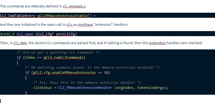

1) What c file in the demo takes the inputs from the CLI script and configures the AWR1843 demo (SDK 3.2 or 3.4)? The mmw_cli.c file in the mss folder, unlike the cli.c file in SDK2.0, looks like it only configures the data processing parts of the AWR, like CFAR, clutterRemoval, LVDS, etc. See attachment below. Where is BPM configured?
