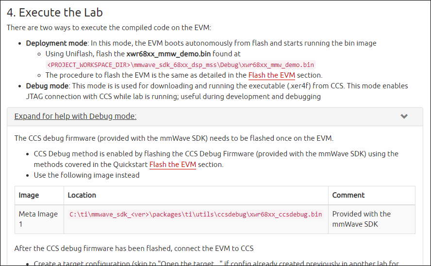

  • Hi Hiroshi-san,
    Please request them to run the demo in CCS debug mode. It's possible that the software might be crashing/exiting and it will generate some logs on the CCS console. Additionally, they can also look at the function stack trace when the code halts to get some idea of where it stopped.
    Details instructions to run the demo in CCS mode are provided in the 68xx OOB demo user guide as shown below. They can follow the same process for IWR1642 OOB demo as well, just making sure that they select xwr16xx_ccsdebug.bin (instead of xwr68xx_ccsdebug.bin) when preparing the EVM for debug mode.
