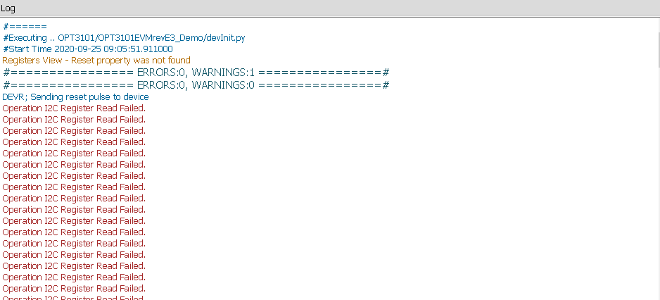

Have a nice day. I am using OPT3101EVM module and cannot connect to Latte program. I get the following error:
Can you share the full output from the log window? I see some is cut off. Please also share the com ports created by the device in device manager and the properties screen from each com port.

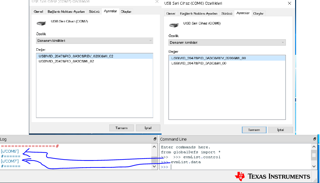

Can you show the window when you right click on each com port and click properties?
Alex

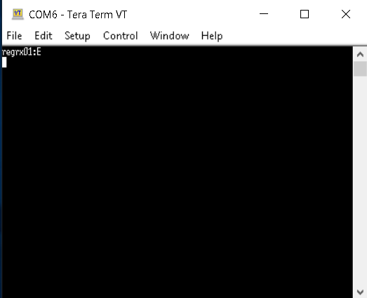

Can you use a com port terminal application like tera term and issue to command regrx01
You can find which of these 2 com ports is the control port by clicking details tab in your window shown and then selecting hardware ID in the drop down. The control port ends in _00. If is also worth checking the evmList.control and evmList.data by typing each in to the command prompt in the lower right of the latte window and checking if these match as well.
Alex
